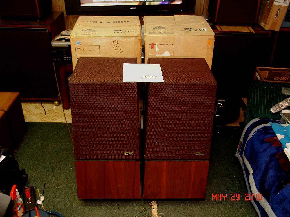

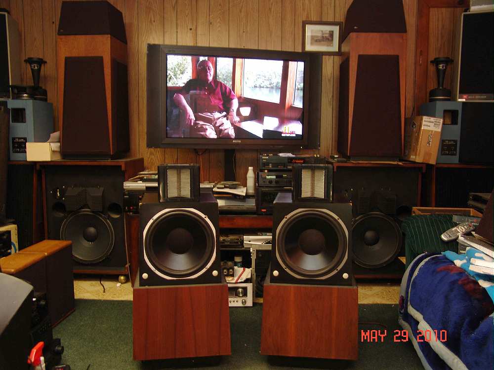

I just wanted to thank all of you for your assistance. I just finished my set of AMT 1B's. I picked them up several months ago. They were just the cabinets, grills, x-overs and grills with one manual. Now they are totally restored. I used your forum for several tips and I thank each and everyone. They sound fantastic. I have a set of AMT 1AM's too. All are for sale. If I knew how to post a picture I would. Assistance? Thanks
