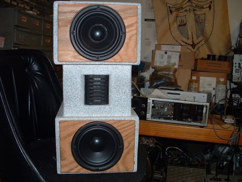

A few years ago I had a similar dilema, to eliminate these bulky speakers but saving the tweeters which I think are fenomenal.
I choose to build a pair of MTM´s around the Heil tweeter. The
result was very interesting, to put it mildly, the quality of the
MTM is excelent, only limited by the quality of the double woofers,
which are Bravox, a brasilian brand of speakers not very well
know in this country but really well made.
If interested I can give you details of these speakers which I use
even today.
You can judge by yourself, the picture is here.

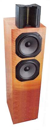

I am using AMT-1 tweeters on top of sealed ~80 liter box with 2 Parts Express Dayton Reference RS-225s. The filter is a Cauer Elliptical (LR8/Jon Marsh style) and the sound is just plain heavenly. 80 Liter boxes are big, but thinner than the old AMT1 cabinets. I think the AMT1s blend well with a pair of 8s. I have seen some other designs like this (AMT1 w/2 Seas L22s, Focal 8Ws, Scan Speak 21Ws). I would be happy to share my crossover diagram if you want to go this route.
John

If the crossover is somewhat adjustable, I would say this: Set a budget for how much you want to spend on a set of drivers. Unless you get something of very high efficiency, expect to buy 4. I would recommend a pair of 8's on either side. Many people here could argue the virtues of any particular brand, but find something you like in your price range. Peerless, Vifa, ScanSpeak, Seas, Focal, Eton and PHL are all good brands. In most cases, expect to get what you pay for. Some will have a different sonic signature than others. A $100 pair of Peerless drivers can sound good, expect that a $1000 pair of Skannings will probably sound better (given the right amount of tuning). I personally think the Parts Express RS225s are a real deal at their price.
Once you have the drivers, it's not too difficult to figure out the right size box. Most vendors can recommend the appropriate sized box for any given woofer, of course double it if using 2.
The last part would be setting the crossover up. If it's an adjustable crossover, shoot for a xover point around 1000-1500 depending on the woofers you use. Listen to it and see what sounds best to you.
The picture below is somewhat representative of what I have done, however that one is using Focal drivers.

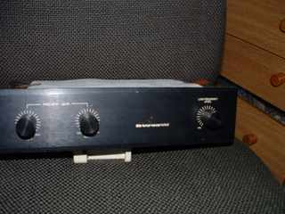

ESS blackbox
Yes, I believe it was used with that ATD system, however I bought
it separately sometime after I had the ESS speakers.
It is a crossover especially designed for the Heill tweeters, and
it features an active section for a subwoofer that gives it a
certain versatility. The rest of the crossover is passive, again for
the tweeter. It´s a nice piece of equipment, they don´t make these
things anymore, I´m sure.
John L

Transar atd2 crossover
(sorry for my english)
Hi jmateus,
I am very surprised. Look at the rear of the box,please. If there is writed "transar heil out" on the two cannon connectors you have purchased a RARITY!
Maybe you not remember the dipole heil woofer (4 membranes) but (maybe)this is his dedicated crossover .
In this case ,unfortunately, the totally different modality of emission
of the different drive units cause impredictable results.
Maybe the passive section it was modified , or maybe you are very lucky!! 🙂
Many years ago I had a transar atd2 system (used) without crossover.
Now you find it! If you could imagine the difficult to find the schematic
and duplicate it............
Ah , very strange world! 🙂
regards

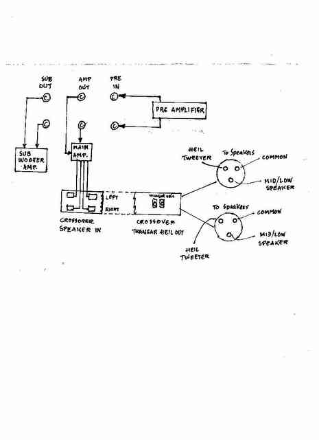

Heil crossover
It is indeed a very strange world.... I had no idea when I bought this
crossover I would buy a true rarity and in fact it was something that
I had to figure out in view of the fact that I had never seen one like
that.
I opened it up and try to follow the design as best as I could and I
came up with this little drawing even to help myself when I wanted
to do any connections to my speakers. I needed right away because
of the tweeter and also because the crossover that was in the box
was very primitive as well as the woofer and the passive radiator,
all junk...
Made new speakers (which I publised the photo) taking advantage of the excelent tweeter and I don´t regret it because the sound is
quite good...
I realized this is not the crossover device for my speakers but I
dealt with it, changed a few caps (the existent ones were ****) and
a couple of coils to suit my woofers, but the high section is untoutchable
it controls the Heil tweeter and I don´t want any discrepancies.
But for you to realize what the whole thing is all about here is the
layout of the connections, quite complicated, thank you.
Rarity? It´s possible, at least I´ve never seen one like this....
