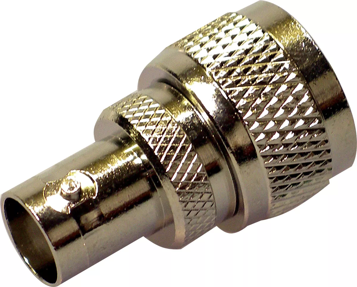

Could i use a female bnc on the other end and plug there my oscilloscope probe?
Or even go directly to an oscilloscope probe. The millivoltmeter end will always be pl 259.
Perhaps you could use a PL259 male to BNC female adapter something like this.
I’m sure it’s something like that (rf, a bit of mains hum etc), but i can’t take it away from the slightly packed bench- restricted space.
In general my mains work well for recordings etc. i’ve made. A 1:1 custom line and ii have it on that 1:1 isolated supply line. Not a top one but still good enough.
I will buy the adapter and see how it goes. In case things are the same ( i think with the oscilliscope probe things will be much better - since when the probes are isolated things are way better) i will replace the old filter caps and if i see no improvement i will just work as i can with it. What else could i do…

Sorted. The pl to bnc adapter is gold and oscilloscope probe apparently is a must for this simple oscilloscope (checked the insides of the hp and it’s way more complicated).
When shorted zero on every scale. Measurements as accurate as can be with this tool.
Thanks everyone for the input and great ideas.
