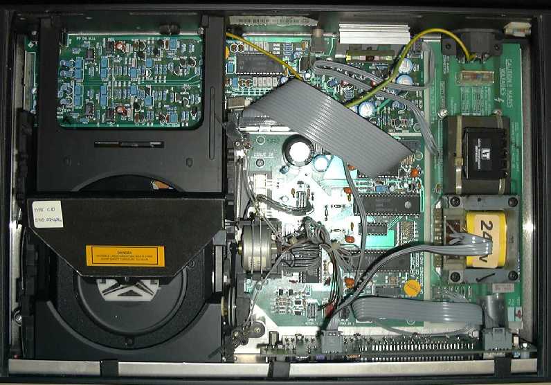

Well - at last I've finally got something that is worth putting all of this effort into. Took some hints from KYW and Dave and Jean-Paul and found an Arcam Delta 70.2. Now I would like to apply all of the PS design to this CDP and it therefore requires some changes to the implimentation.

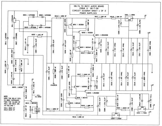

The first area I would like to address is the power supply to the audio PCB. At present it has a separate 15V + 15V 12VA TX supplying +/-20Vdc. This is filtered by 1000uF - 6R8 - 1000uf. LM7805/7905 regulate the +/-5V, and LM337 regulates the -15V for the TDA1541AS1. Discrete regulation is used to supply +/-12V for the discrete I/V and the NE5532 opamps.
Farguar and Jean-Paul have suggested (in the Arcam thread) replacing this TX with a better one. My 22V + 22V 25VA unit could be used here - with some additional filtering or pre-regulation.
So - now I'm thinking of making a small board with the new TX, some Schottky diodes, RC filtering and maybe a pre-reg. this could then be fed into the audio board - after the original rectifier.
Any ideas on the best way to do this would be most appreciated.
150mA should be enough to supply positive and negative voltages each. I was thinking of something like 10R/220u/10R/1000u - LM317 - connect to audio board - 10R/1000u/6R8/1000u - existing regs. This supplies the LM317 pre-reg with 26V, 420mV of "peak to peak", a conduction time of almost 5mS and current peaks of 0.5A. The pre-reg could then be set to 20V to supply the PCB.
Is this good enough and does it still satisfy the 6db rule and timeconstants?
I obviously need a refresher course on this!
Another option would be to omit the pre-reg and insert 15R/100u/20R before the existing 1000u/6R8/1000u. This would give 19.3V to the regs with 34mV of "peak to peak", a conduction time of almost 6mS and current peaks of 0.4A.
This seems quite good - but I'm a bit concerned about the no-load voltage being to high at over 30Vdc. The Kill circuit is fed before the regs, which is currently 20Vdc!
Here is a picture of the inside of the Delta for you to oogle at.

Kuei Yang Wang said:Konnichiwa,
If we "design in" your 22V/0.5A Transformer and use 22R/100u/10R/2,200uF/10R/2,200uF/10R/2200uF we get 26V DC with 0.5mV peak-peak ripple. Peak currents (for 50mA DC out) are below 0.2A and the current draw is very "rounded", almost a nice sinewave. nearly 4mS conduction time equal 72degrees conduction angle.
Comparing this (for fun) with a single 4,700uF Capacitor has a conduction angle of 27 Degrees and nearly 0.5A peaks with 32V DC overlaid with 90mV Peak-Peak ripple.
You can increase the timeconstant if you like. There are no hard and fast rules, except perhaps the 6db rule.
