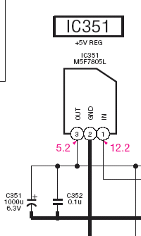

I'd like to change my 7805 regulator to LM317 as it seems to be a cheap but possibly an efective mod. What things I have to concider if I do this (Do I have to modify the original configuration)? I tried to figure this out by myself reading the data sheet, but I didn't understand much from it.
I also wan't to change the diodes from PS but I can't figure out which diode type is the best. Are there really noticeable differences between good schottky diodes.
My player is Sony DVP NS900
