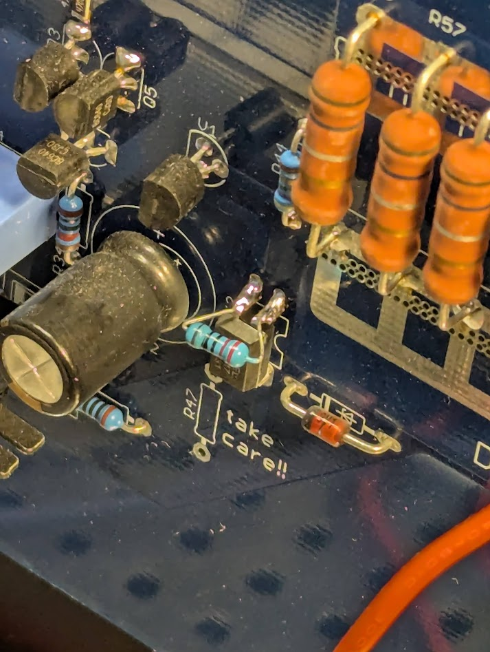

Coincidentally, or not, I have had right channel hickups in my SET version when visitors with "impaired hearing" come by for a listen 😊
ZM suggested "solder 220R in parallel to diode part of optocoupler". I have done this but have not put it to the test. And don't know if this applies to your version.

Q1 has given up the spirit a few times on high volumes and I now consider this an inherent "speed limiter". Maybe the resistor tweak above will help!
Since I’m actively assembling the XA252 MOS version, this modification seems pretty important.
Is the parallel resistor used across both opto's?
Sorenm, do you remember the post# that ZM shared this info?
