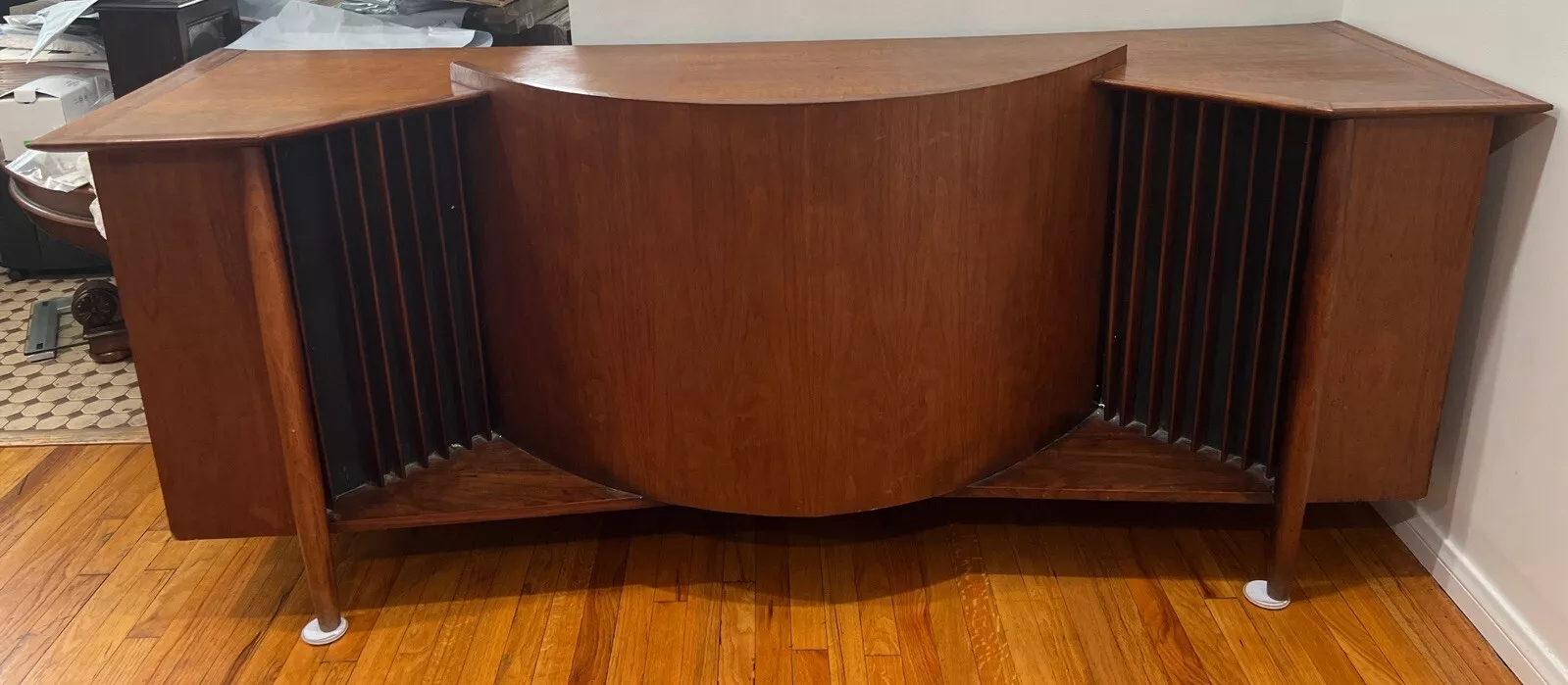

My wife would kill me.... speakers? In Woodland Hills.... Vide the JBL Metregon - with updated Tannoy 12" woofers..
https://www.ebay.com/itm/2766590106...customid=1bbbcd6e-de72-11ef-a7db-663432383635
Will the Sissy drive these?
^yes, it would fit into the Passport. The Paragon is too big.
I wonder.....
Figure the Sissy would drive it?
