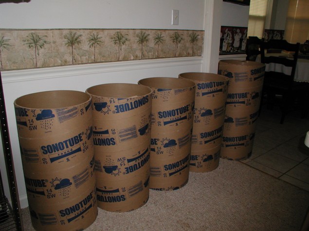

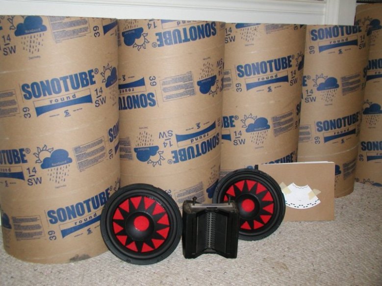

Cut down some more SonoTube today. It's pretty slow going cutting this stuff up with those little plastic knives tho 😱 - and you go through a bunch of 'em!!
I'm making 3 speakers - two to keep and one as a "test-tube" to play with mod's on. Concerned with wall flex - but will address that at a later place and time. Might put one of those 14 inch babies inside an 18 inch tube and use some expandable foam between the walls to improve flex resistance and deaden things up a bit. Sounds a bit more practical than filling the base up with Jello pudding.

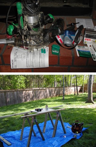

Construction update:
Well yesterday I bit the bullet and purchased a plunge router - and seeing how I thought it unwise to sit on my butt and spin in order to cut circles I also purchased a circle cutting jig. Other item purchased included a respirator rated for toxic dust and fumes, safety goggles that would fit over my glasses, a disposable dust suit, router bits, and some lumber and braces to make a work stand out of. About the only thing I had on hand were some general carpentry tools and ear plugs.
So I banged together a work stand and placed it on a tarp outside in the fresh air where the breeze would blow the light dust away from me and after reading the instruction manuals (yeah, I read those things), I got to it and routed up some MDF and plywood.
Good thing I measured the inside diameter of the SonoTube before I started because the 14 inch stuff that I'm using measures more like 14.75 inches ID.
Guess I'm going to have a little more bass than I expected! 🙄
Cold day outside today - still 45f at noon so I got a late start. Will finish cutting things up tomorrow and then it's on to putting things together!

What type of treatment (paint or veneer or…) are you going to do with the sonotube?
R. Jamm
Hi R Jamm,
Working on EnABL pattern to be used with a stencil type application now. BudP has been super with providing different size patterns shaped for the basket side of the Pioneer 10 inch and I have obtained some flexible silkscreen sheets that look fairly easy to use from http://www.store.cbridge.com/pc/STP-KIT/KIT-STP-001/Basic+Starter+Kit+with+StencilPro
I'm also wondering if plain old photo sensitized silkscreen that you can get at just about any arts craft store will work - but that stuff usually needs UV lamps to expose the pattern with. Still - it could be worth a try.
Not nearly as difficult a process as doing a framed silkscreen for a circuit board - and doesn't require any UV lamps either! The basic kit comes with everything you'll need except the pattern - which will be made available by BudP or me after a little bit of refinement and debugging. Still some details to work out with exposure times, pattern application, - specific step by step stuff - which I will be working on this weekend and should have some preliminary results to report. I had to order the paint and conformal coating at my local hobby shop and hopefully it will arrive tomorrow. Then some testing to see what a successful application method will be. The paint is a thin acrylic and that is going to take some fooling around with to see how I can prevent it from running down the cone as it's being applied. The conformal coating is simply brushed on but BudP wants me to do some testing first to see how much needs to be applied.
I'm considering a nice veneer wood finish for the base units that I will put into my living room - but the test rig I'm simply going to primer a sort of medium gray because it's going to get beat up quite a bit while I fool around with different damping treatments of the SonoTube. I am also considering using a padded leather finish to match the furniture or some short fiber carpet - the padded coverings would also be to damp the SonoTube. OR I could slap on a bunch of LED's and go with the scoreboard look - hmm - NO!
Hope this helps - after this weekend I'll know a lot more!
