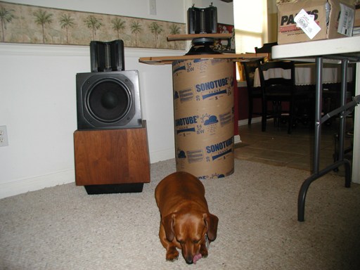

Most of my parts have arrived (but not all) and the 1st hunk of Sonotube has been cut. Pioneer 10 inch speakers are here and getting ready for the mamboni treatment.
Did a bit of a "dry fit" to check size of units - looks good for my target tweeter height of 36 inches plus or minus.
Photo of "ruff" dry fit.

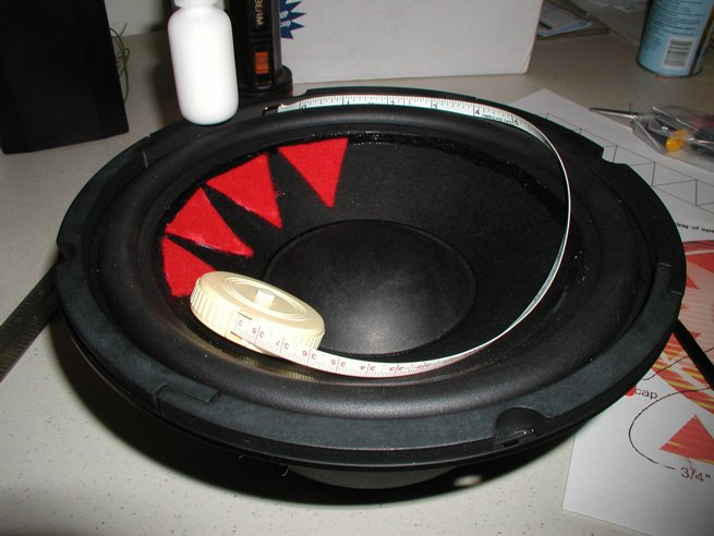

Did not get as far as I wanted last night - it took a while to measure the Pioneer and determine the placement of the Mamboni triangles. For those interested - I measured on the inside of the mounting bracket circumference and came up with 6 centimeters for triangle centers on this make and model of particular speaker. I have applied the triangles as per the Mamboni design. I have some other ideas as to size and placement - but the good Doctor M has already played with several versions of his design so I'm not going to screw around at this point. Things are already complex enough with the combination of the Mamboni design and the next unit which will use this as well as BudP's EnABL pattern on the "backside" of the speaker cone. Of course because we are using a Walsh type of transducer the "backside" winds up being used as the "radiating side" when assembled - so when I say "backside" I am referring to the cone surface facing the speaker basket.
Going to dissect the speaker dome today after running my spousal unit to Huntsville. So the bad news is that I'll be gone for several hours. The good news is that I'll be alone and free to "play" all I want for a couple of days. 😀
Photo of last nights progress - the second speaker should take much less time to do now that I have gone through the learning curve. 😉
photo of how I made my measurements for the Mamboni triangles. Using inches came out sort of odd so I switched over to cm/mm's and it works out nicely at 6 cm per division. I considered using an odd number of triangles so I could tell my friends that I have and "odd" speaker - and then watch their eyes glaze over as I explained just exactly why!
BTW - use of a cloth type tape works well for this measurement. My trusty Stanly 25 ft. metal tape I use around the house just didn't get the job done - no cm's on it!!

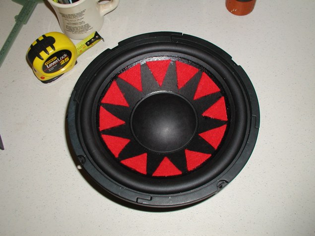

Well - need to press on and get some things done - so jumping right in with the Mamboni mod's to the Pioneer 10 inch as specked in his drawings. BudP is a jumping up and down (in a good way) for me to finish my speakers and do some listening test.
I have to mod speaker #2 and prep it for the BudP's EnABL pattern, cut up another hunk of Sonotube and then carve up some MDF for the end caps and center brace. OH YEAH - WE'RE HAVING FUN NOW!!! 😀
photo of 1st speaker with Mamboni magic!!

The size of the vent is not precise. I used 3/4 " dia. hole. The felt pieces, three in all, are large enough to cover the vent and have about 1/2" to 3/4" felt around the opeinig. So, the felt circles were about 1 3/4" inch diameter. The photo of the finished driver looks fantastic - very clean and uniform work.
Sure, different size triangles would spread the resononce modes more and could sound better - experimentation is good. I am anxious to hear yor impressions of the modified drivers with tweeter. Are you clear on the wiring?

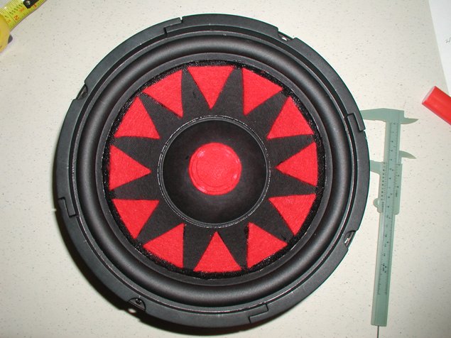

Hi Mamboni!
I used your 1.5 inch sized equilateral triangles and varied the size of the felt pieces used on the dome assembly @ 1.75, 1.50, and 1.25 inches.
I assumed the hook up was going straight to the woofer + to + and - to - , and then from the + side of the woofer through the cap and 4 ohm resistor in series to the + side of the tweeter. Correct?
I'm working on an "Olsen" variation of your theme but I am concerned with edge reflection so I'm going to include BudP's EnABL pattern as well. The attached example uses "Golden Section" ( Fibonacci) section triangles and I have those placed - will add EnABL after I post.
I believe that your triangles serve as a torsion mechanism that damps the major cone flexing with a variable degree of mechanical resistance vs. frequency and that BudP's EnABL will act as a "trap" on frequencies reflected from the speaker edge by setting up an mechanical interference on the cone surface. Should be interesting!!
Glad I purchased an extra speaker to mess around with!
