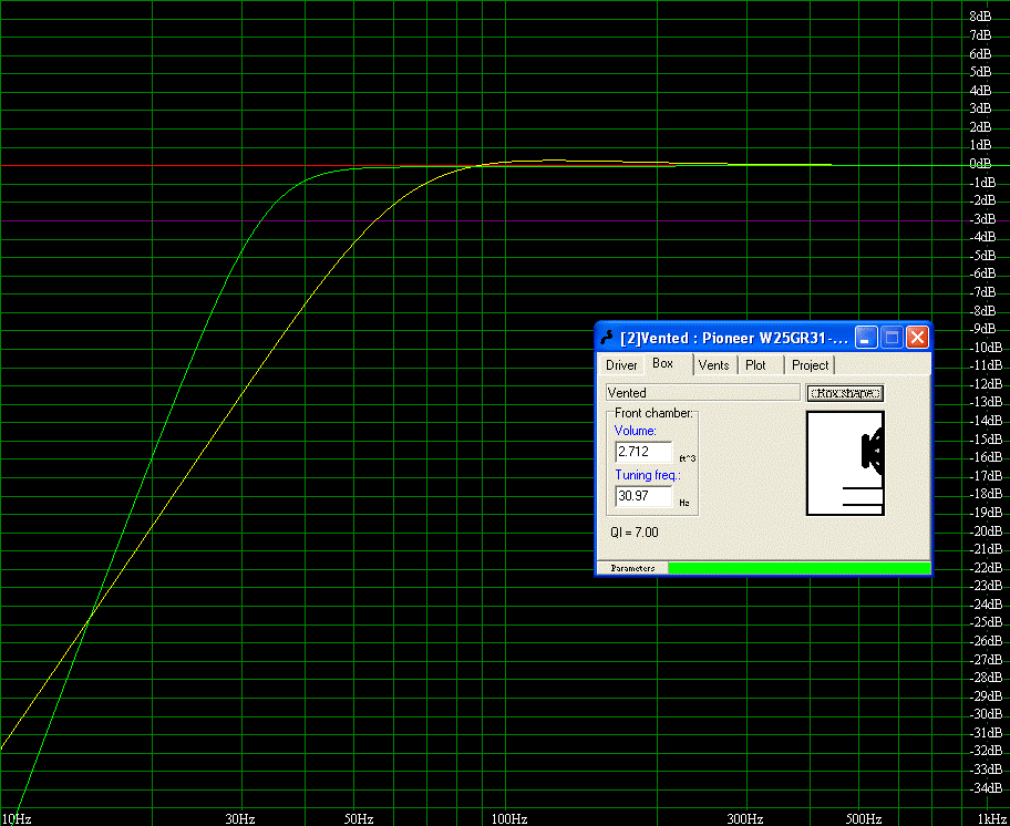

Attached is the response for the Pioneer plotted in WinISD beta. I loaded the values shown from Parts Express and not the ones that came with WinISD for the graphs. The green plot shows the Pio with a 4 inch dia. by 9 inch long port and the yellow plot is for a sealed enclosure - you should be somewhere in-between the two.

thanks Thomas for the graphs. I did get WinISD and I want to duplicate what you have done to help with further changes.

There is a vent hole through the Pioneer magnet - combined with cutting the hole in the dust cap that is how the speaker is getting vented. I covered the rear hole because stuff tends to fall into it and took off one of the 3 felt pads mounted to the dust cap to compensate.
