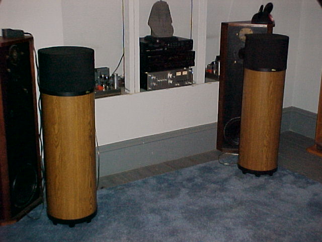

Here is a shot of the full systems in my stepsons old room along with my AL1. FYI both the OHMs and the Allisons were found at the old Jacksons Flea Market (Hadley MA). Each pair was less than 100 bucks in '98. Of course they both needed work. As I mentioned in my first post that both OHM systems required the broken ABS driver mounting bulkhead to be fused together with with ABS pipe fusor. The perforated metal "cap" had the grill cloth stretched over the cap and then pressed into a recess in the bulkhead. Very difficult to remove. I left the cloth off. They looked fine with a new coat of black paint. The AL1 needed new foam surrounds and some of the leads to the mid and tweeter units had been broken. Careful soldering brought them back from the brink.

Yes they are, modified with the KTA modification (they were rebuilt around 1999.

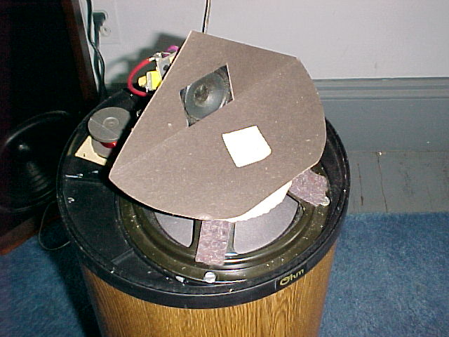

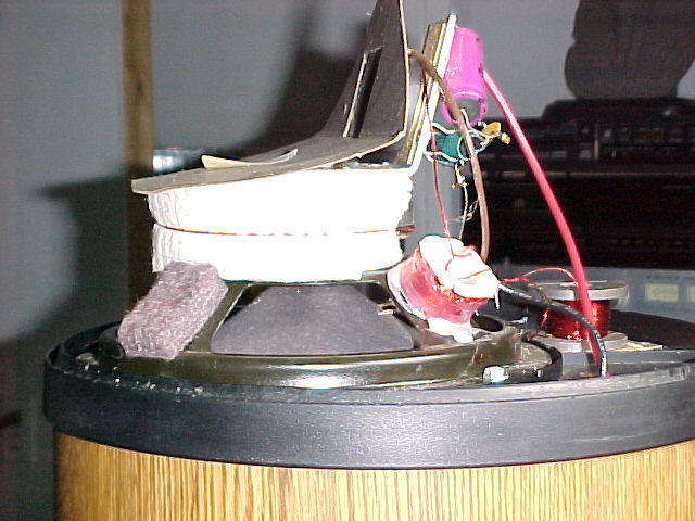

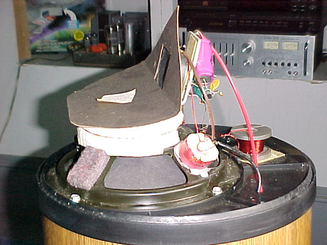

If anyone is looking for a set of the OHM Sound Cylinders there is a set on EBAY. The auction number is: 290266408368. The set that I repaired had fabric surrounds on the full range drivers. So even at 18 or so years old that is one thing that won't need to be replaced. One thing I didn't mention about the SCT is the tubular cabinet. It is a pretty thick walled tube (perhaps 3/8") with a sheet of lead around the inside to deaden the structure. There is also some sort of polyfill like material and the cabinet is of the vented type.
When I had these speakers I did nothing other than repair the systems. No mods were performed. However, if I was to modify this unit I'd loose the inexpensive cone tweeter and replace it with a better quality device (like the BG Neo 3PDR planar tweeter) and loose that carboard reflector, possibly using some acrylic damped with some lead sheet or modeling clay heated and then flattened out with momma's rolling pin and applied the the reflector (you needn't tell momma what we borrowed her rolling pin for.... my wife never uses hers anyway). The BG tweeter would have to be adjusted for correct response (series capacitor and possible a level control) to blend it with the inverted cone woofer. (oh, sorry I mean "Walsh driver".)

question of alignment
I do not have access to a scope any more and cannot perform accurate pulse/time analysis to determine proper tweeter alignment with the main driver. What I do now is get a friend to move the driver back and forth slowly, with a pink noise signal running through the nearly completed system. When the sound from the two drivers "merges" as one apparent sound (with my eyes closed) that becomes the mounting position. It works surprisingly well and the distances are reproducible between identical driver types.
Do you have a better way to do this?
Photo #3: Closeup of head unit: Walsh woofer driver with top mounted tweeter

I do not, though if you EnABL both items, the match will be even more refined, but the gradient of space allowed for a near perfect match will grow.

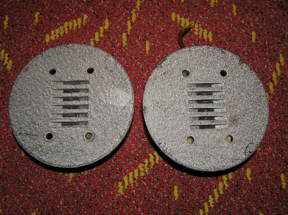

Hi Bud, the main driver certainly would be possible. However, I was thinking about using these for the HF driver. Any experience with the monopole AMT's? You and I both have a love of the Linneaum drivers, have you patterned those?
Mine are long gone.
