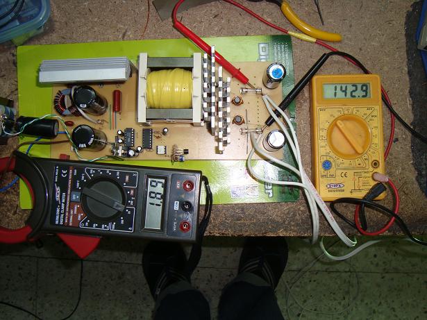

Hello everybody.
Just wanted to show how my SMPS is working. Now it's output voltage is +/- 71 and is running at 50 KHz. I changed Rt to 27K ohms, Ct is 1 nF. ETD59 was rewound to 20 turns primary, 4 strands of 22AWG, secondary is 9+9 turns, 6 strands of 22 AWG. First I wind half the primary, then half secondary, then last half primary, and then the other secondary.
The IC's voltage is obtained from an auxiliary transformer, later I'll add the startup circuit.
Output caps is now 1 x 470uF/200V per rail, I'll get 2 x 1000uF/100V per rail, or better 3 x 470uF/100V per rail, what do you think? (it's for running audio amp at 200W/channel)
I'll do more test with some 100W bulbs and post pics of current and voltage.
The gap in the core, i could eliminate it with the sand paper trick, the surfaces are smooth and they make contact without any gap at all (i didn't took photos of the process 🙁 ) Is it advisable to glue the 2 parts of the core?
Can a bleeder resistor be added to the outputs? Can it be used as a minimum load?
Again, thanks to everybody that contributed to this post, and luka for this design.
Post pics of yours, i had fun making this, hope you too 😀

nice work!
3x 470u would be probably best,or 3x 1000u
you can glue 2 parts of core together
Yes!
You can, but you don't need minimum load or then again amp itself is a load
I would keep the minimal-load resistors for testing as SMPSs don't like to run in no-load conditions, and in case either Amp's power leads should accidentally be disconnected from the SMPS's outputs. Just a thought.
Other than that very small item, I like it. Can you post a schematic?
Steve

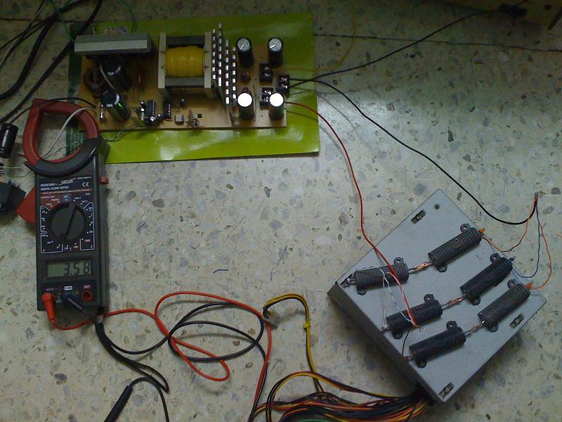

luka said:
hey DJ,
Post waveforms too, when you'll find time for this
Hello luka, sorry, I can't post waveforms, I don't have an oscilloscope :bawling: , but I'm thinking on making a PIC based scope, just for the fun of having a scope 😀
More testing: I put 3 x 80 ohms in parallel on each rail (26.666ohms) and on input I got 3.58 Amps (120 Vac), so it's 429 watts, right? On output I calculate 70^2 / 26.666 = 183 watts each rail, so it's 367 watts in total. Efficiency is (367/429) x 100 = 85% :bigeyes:
Mosfets were just a little bit hot, same the transformer, diodes were normal temperature, but loads were very hot, so I didn't test it for a long time, maybe 5 minutes or so...
Next thing will be to connect it to the amp, will post pics when I do.
