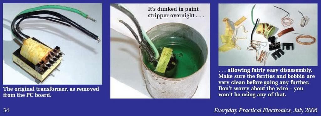

I didn't ask it before, but have any of you reused some PC transformers? If so, have did you take them apart without breaking the core or anything alse?
luka said:I didn't ask it before, but have any of you reused some PC transformers? If so, have did you take them apart without breaking the core or anything alse?
I have had to soak them in actenone for a few to several days so the acetone will disolve all of the varnish so it falls apart without breaking the core.
BEWARE acetone is FLAMMABLE, TOXIC by inhalation and cutaneous absobtion (through the skin) it is hard on the liver. use in well ventilated areas.

recycle PC magnetics
You can use your microwave, if you put a cup of water in with the transformers for about 2.5 to 3 min the core will fall apart with a very little effort on your part. This method will leave a ordor behind for a few minutes but if leave your microwave door open it will dissipate in a short period of time. Be careful handling the cores , they will be hot. This seems to work only for the PC magnetics.
chas1
chas1
That's really interesting. Never thought of that. What is the H2O for? Does it absorb any reflecting microwaves the xfmr assembly might give off?
Previously, I have tried dunking them in boiling H2O, and after sdomething like 10 minutes, they just fall apart. Keep it in long enough, and the lacquer will melt off almost completely, making both the core and bobbin easier to work with.
Just don't do this with any cookware you want to actually cook with! 😀

microwave is probably very good, but I don't think my parents would be too happy to see some thing like that in it.
But I did find a way, that I didn't try yet.In EPE(Everyday Practical Electronics)July 2006 on p.34 they say:"The original transformer,as removed from the PC board.It's dunked in the paint stripper overnight...allowing fairly easy disassembly."
What do you think, will it work allright?
Paint stripper
Luka
I have read where paint stripper's have been used but beware it is a caustic chemical and the directions for use should be followed to the letter and it will give mixed results. I only mention the microwave for I have one in the lab. I use the small PC cores for gate drive transformers as well as inductors for prototype's.
chas1
