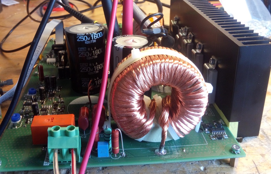

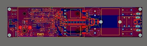

Hello everyone,
after about one year I have finished designing and building my amplifier.
The main differences with respect to to original project are:
1) Class-D stage is now UCD style running at 100kHz with 2nd order LPF
2) Power MOSFETs are Silicon Carbide Cree C3M0065090D (900V 65mR SiC)
3) Audio isolation is perfomed with HCPL7840.... very bad choice. It has an
output noise of 30mVrms (from datasheet) and this makes about 1.3Vrms at
the output.... It is a white noise generator, not an audio amplifier. I have
managed to limit the noise by filtering (subwoofer only amplifier) but
anyway the output noise is still to high. I should have used Pafi's solution
but now is too late.
I have set the dead time to 100ns; it is maybe too long but I would like to start on the safe side and then reduce it if needed.
I have started to work on it and after some values tweaking, mainly for idle switching frequency (100kHz) and gate resistors (SiC are really fast indeed) I was able to pull out 500Wrms @ 80Hz continuous from it with an efficiency above 90%.
Not yet done full power test because I have to build a 8R dummy load first to test it. Also the current limitation circuit is not been tested... I am a bit scary about doing it...
In attached you will find the complete schematics and some pictures of the assembled amplifier.
Comments and suggestions are welcome

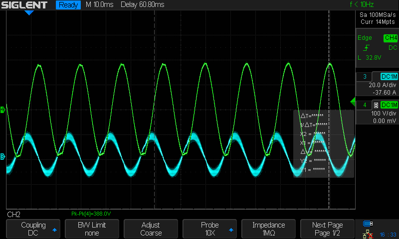

I have started to do some measurements on the amplifier and the results seems very good:
1) Output power on 8R load: measured 388Vpp at clipping, it is 2350Wrms
output power.... not bad. The green trace is the output voltage, the blue
trace is the output inductor current at 20A/div. I have made this test with
continuous sinewave for about 20seconds to measure the total efficiency.
Input power is 2492W with a power factor of 0.99. It is an efficiency of
about 94%.

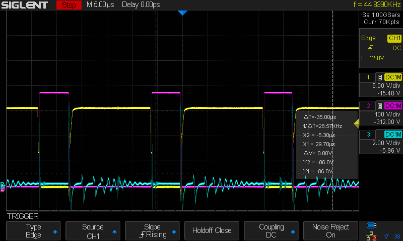

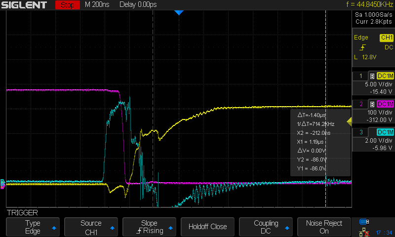

2) PFC switching: ZVS is correct, switching frequency is 45kHz.
Purple trace is PFC IGBT Collector at 100V/div, Yellow trace is IGBT gate
at 5V/div, blue trace is ZVS MOSFET gate at 5V/div; this signal is very
noisy due to improper connection of the scope probe.
