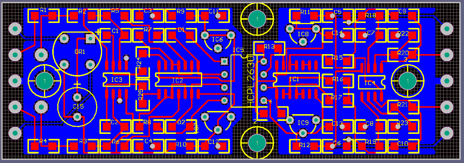

Hello everyone,
after about one year I have finished designing and building my amplifier.
The main differences with respect to to original project are:
1) Class-D stage is now UCD style running at 100kHz with 2nd order LPF
2) Power MOSFETs are Silicon Carbide Cree C3M0065090D (900V 65mR SiC)
3) Audio isolation is perfomed with HCPL7840.... very bad choice. It has an
output noise of 30mVrms (from datasheet) and this makes about 1.3Vrms at
the output.... It is a white noise generator, not an audio amplifier. I have
managed to limit the noise by filtering (subwoofer only amplifier) but
anyway the output noise is still to high. I should have used Pafi's solution
but now is too late.
I have set the dead time to 100ns; it is maybe too long but I would like to start on the safe side and then reduce it if needed.
I have started to work on it and after some values tweaking, mainly for idle switching frequency (100kHz) and gate resistors (SiC are really fast indeed) I was able to pull out 500Wrms @ 80Hz continuous from it with an efficiency above 90%.
Not yet done full power test because I have to build a 8R dummy load first to test it. Also the current limitation circuit is not been tested... I am a bit scary about doing it...
In attached you will find the complete schematics and some pictures of the assembled amplifier.
Comments and suggestions are welcome
ciao
-marco

Nice to see that you made it 🙂
output noise of 30mVrms (from datasheet) and this makes about 1.3Vrms at the output.... It is a white noise generator, not an audio amplifier.
Too bad that you got trapped by this pitfall.
Regarding isolation amplifiers you could also have a look to Analog Devices.
I.e. ADUM4190 is a low cost type which is approved for
reinforced insulation per CSA 60950-1-03 and IEC 60950-1,
for 400 V rms (565 V peak) maximum working voltage.
Test voltage also 5kV, like the HCPL.
60950 (IT&Office) and 60056 (Audio) have been harmonized some years ago, so a certification acc 60950 has gained weight also for audio applications. ...check with your certification institute... or if it is just for
DIY you can consider to trust that IT&Office should be as safe as audio (most likely you have already connected your IT-devices with your audio devices since 20 years...)
Output noise is less than 2mVrms or 5mVrms, depending which output you are chosing.
..and there are many more isolation amplifiers in the market. It's worth to spend some time for the search and check which one fits your taste best.
One approach that I tried almost 20 years ago was to use a self oscillating half-bridge on the primary side of a high frequency 1:1 isolation transformer. A smaller winding on the same transformer provided control voltage. The audio was demodulated using a phase shifted synchronous rectifier. The difficulty is that the rectifier switches need to operate in all 4 quadrants.
I did this using 2 N-channel mosfets in series connection as D-S-S-D with the gates common and driven by a gate drive transformer. 4 of these switches are needed for full-bridge or 2 may be used if the transformer secondary is centre tapped. Because phase shift is used to demodulate, the gate drive transformers always operate at 50% duty cycle and a common driver and/or transformer may be used. I seem to recall the control circuit having a VCO to track incoming frequency and the error signal adjusting the phase.
Whilst I did get it to work it was not very reliable. I think there is a better chance these days with the mosfets now available.
The big advantage of course is that all the control circuit and audio input/output can all be ground referenced.
