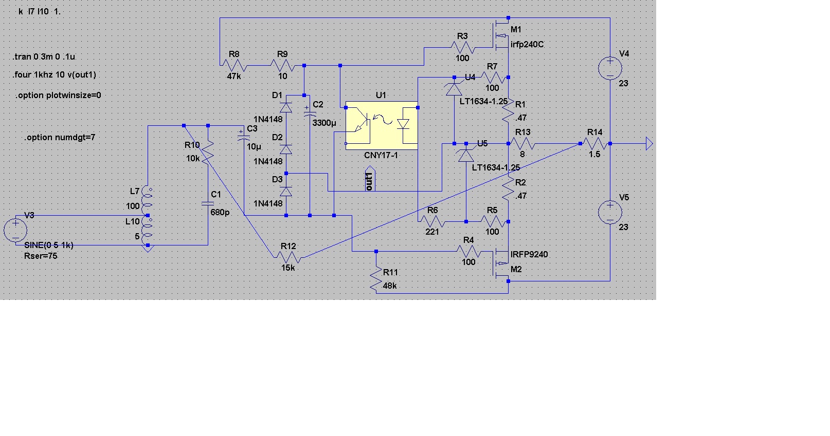

OK here goes (no pfb) .84v in----3.861v no load-----3.753v 8 ohm load--- gain= 4.58 out z=0.23ohm damp factor 35
(pfb) with 1.5 ohm and 15k .84v in----3.172v no load----3.143v 8 ohm load
gain=3.83 out z=0.07 ohm damp factor 135
All at 1khz.
So what does it all mean ???? I'm just a back yard mechanic when it comes to this. Will I hear a difference of will I blow up something? Guess i'll try it and see
Hm, is there a reason that the pos feedback resistor connects after the magnifying element, the autoformer.
Normally I would say connect it in front f the autoformer.
Oreo how have you selected the transformer values?
From Elliot Sound Literature
" ---For example, a transformer might claim to be -3dB at 30Hz with an impedance of 600 ohms. That means that the inductive reactance is equal to 600 ohms at 30Hz,"
L = XL / ( 2 * π * f ) Where XL is inductive reactance and f is frequency
L = 600 / 2 * π * 30 )
L = 1.59 H
From Edcor Data----Frequency Response 20~20K Hz., <1dBu
I just used the 20hz as the lower frequency in my calculation,its probably more like 5 hz for -3db. which would give about 20H.From there I tried different values for the other L that gave me a gain of 5,that value worked out to 100H. If 5hz was used then the values would be 20H and 500H.
Here is my first attempt om a balanced M2-DCB1 combo, thanks to previous modeling posts and encouragement.
I found the Edcor settings on a .rs website with these parameters
Edcor PC600/15K (1:5)
pr. : 44Rdc, 240mH (600R)
sec. : 235Rdc, 5.7H (15k)
My trafos are already mounted so I can't measure them to verify, I hope they are correct, they model 1:5 voltage amplification fine.
I am still puzzled by the signal grounds in LTspice vs. no ground ref on a real balanced signal, and the volume control...
I made a complete working M2 SE model first, and than I simplified the M2 schematic and mirrored it with F5X signal input resistors. Next step would be a complete balanced model.
Any advice is welcome...

Thanks for the Edcor values.Boy was I off,so much for Elliot's calculations.
Don't remember the forum site/poster, but a guy also called Zen Mod was there... so thanks then!
