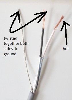

Yes they are shilded!!!
just to confirm > 2 condunctor shielded wire!
Yeap I have those at input and the input is not the problem!
