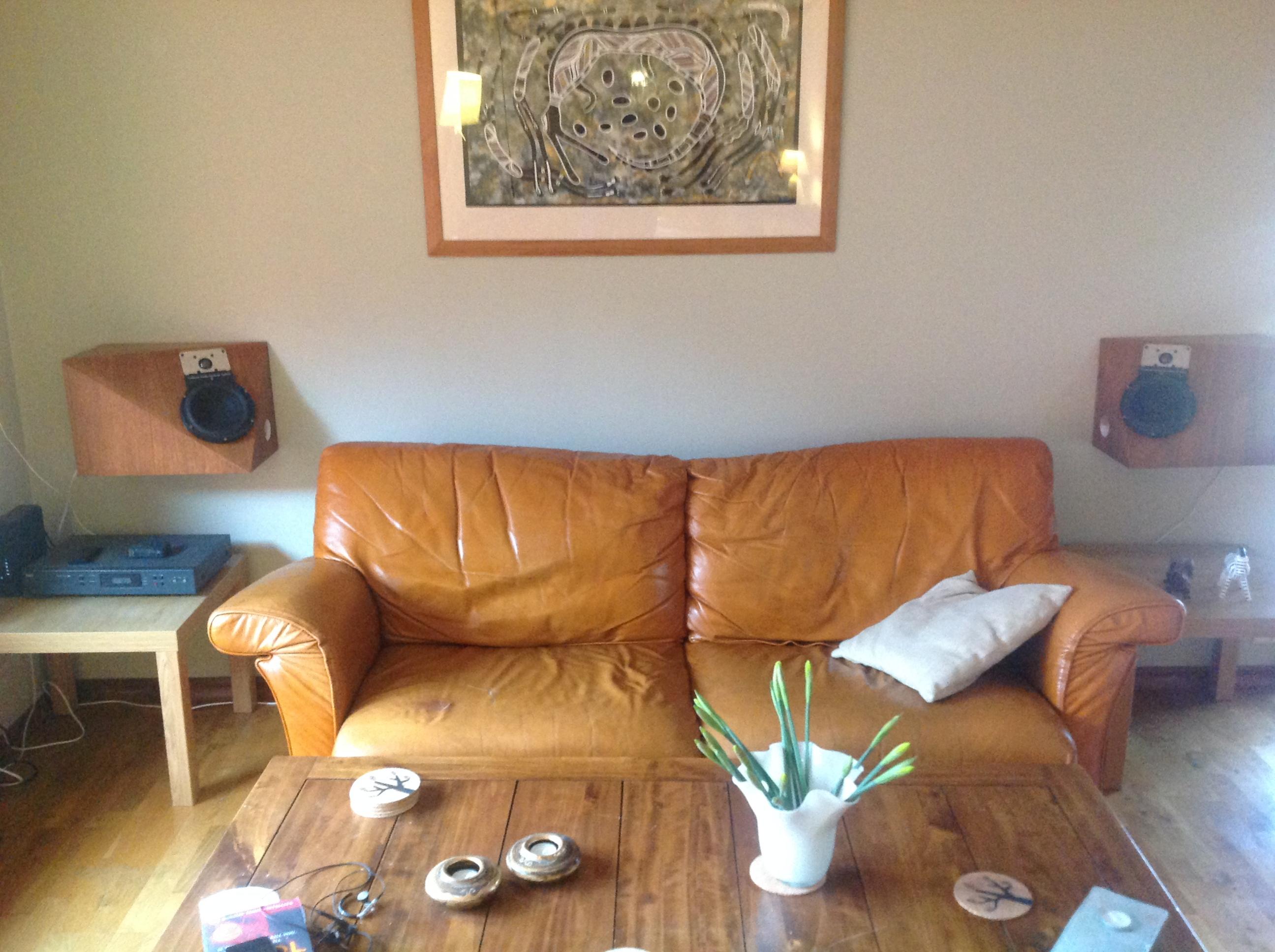

Even if the M2 shows it self to be superior on my horns the F6 will live and might be tweaked for additional W later. It is wonderful on my renovated Carlsson OA-51LE2 in the high WAF system (old picture), where Im currently using hypex ncore nc400 monoblocks.
