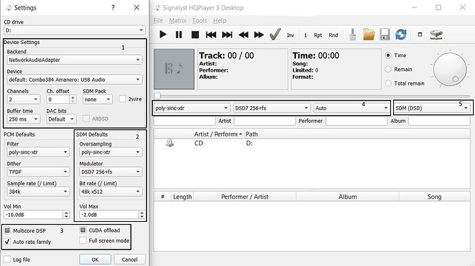

Hi, Dominic.
I attached my HQP settings. It may be not network related issue.
When you select Backend NAA, do you see any Device in a couple seconds?
At NAA computer:
1. Connect Amanero/XMOS to NAA computer.
2. Check, that networkaudiod (NAA daemon) is running (using htop command, then search for networkaudiod). It should be with Nice minus 10 (it's Ok), in other case - run it manually.
3. Type aplay -l command. You will see you current audio device. It should be your USB interface (it's Ok)
4. Check kernel version uname -r. Most likely you will see < 4.11 version. Only kernels > 4.12 (as I remember) support Amanero DSD Native w/o patches (Debian kernels does not include patch). So you need to install newer kernel, than reboot.
I'd recommend to try Jussi Laako rt kernel for Stretch
Index of /src/stretch/

Can't seem to find any NAA in HQPlayer... That I choose IPV4 or IPV6 my NAA devices don't show up. NAA are installed under Linux and tested under three Linux Distros but not working... I've installed HQPlayer on my Windows 2016 and Windows 10 computers and same results.
Last I tried is HQP NAA on SnakeOil OS (the author is very good with support).
DAC is showing up in NAA
The only thing I'm thinking is the IPV6 stack not enabled under linux...
Any thoughts?

HQP is ok with IPv6 and Jussi the author actually recommends IPv6.
Take a look at both HQP and NAA logs to see if the devices are seeing each other at the application level. HQP uses multicast to communicate with NAA so if you have multiple interfaces on the HQP server make sure that the multicast routing is set for the correct interface. Other thing to check is if you have multiple NAA the names are set to default, which make it difficult to find the correct one. I rename my NAA so they are easy to find and use. If you are using IPv6 make sure that both devices are running IPv6 and when you select Network Audio select IPv6. It might also be worth it to check IPv4 connectivity.
You might also try posting your information on Computer Audiophile site under the long NAA thread.
