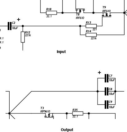

Also, since these are all polarized caps, is there any preferred direction for these to be put in? + towards input?
Preferred direction? You mean how not to blow them?
+ goes obviously towards the more positive: input gate is more positive (by about 12-13v) than input ground and output drain is about 30v more positive than output ground.
Yes, I guess. I've never done any amps that used coupling caps, and certainly not electrolytic. So, per the attached drawing, the positive should go towards the FETs in both instances?
Also, any resolution to your oscillation issue a few posts back? By grid stopper, were you referring to R6 and R13?
