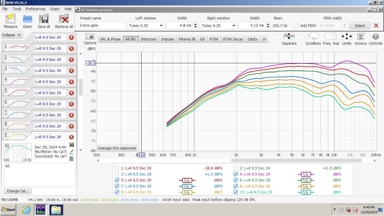

I wanted to measure the distortion of my other wave-guide tweeter. I set it on top of a speaker. The distortion is considerably lower. The results of what I did next, really surprised me. I measured off axis. I just kept turning the box till I was out past 60 degrees. I think I want to use this tweeter.

I'm not sure I understand your 30 degrees comment, unless you were thinking the same thing that I was, and that being how nice the second and third sweep looked. There's some diffraction going on for sure, but the 3k, to 5k range drop along with the top end. The tweeter faceplate is 80% exposed, and can cause some diffraction. I also measured on an 11" wide baffle, and roll-off was not as smooth. I think that if it was in a more optimum baffle width, with 1/2" round overs, it would be pretty smooth.
I'm even wondering if a horizontal break, ( think really wide chamfer. ), in the baffle of 12 degrees between the tweeter, and woofer, to tilt the tweeter off axis when at the listening axis, might be an option. Although this would aim the tweeter slightly towards the ceiling, the additional off axis roll-off vertically would reduce what reaches the ceiling anyway.
