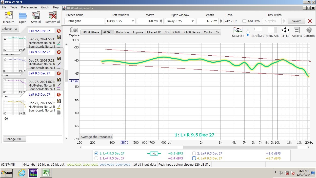

The speaker belonging to the above measurements would make a good center. If you look at the 45 degree measurement, it's still plus or minus 2dB below 10k. It would however lack the power handling of a larger speaker.

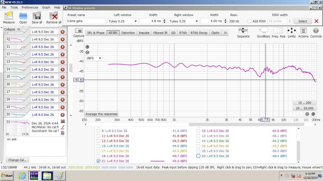

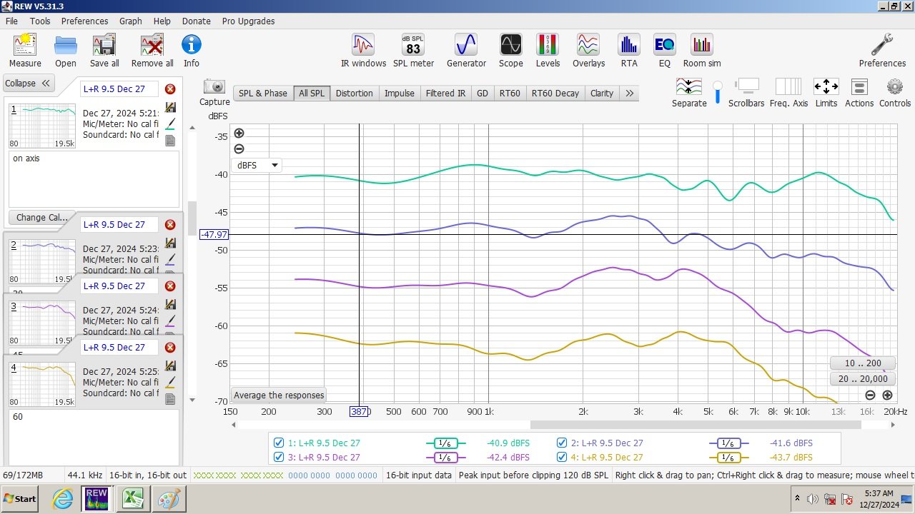

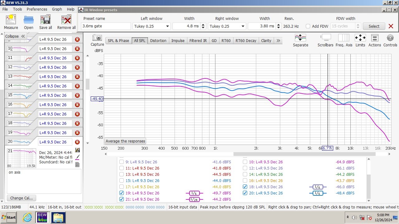

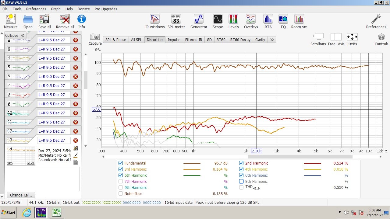

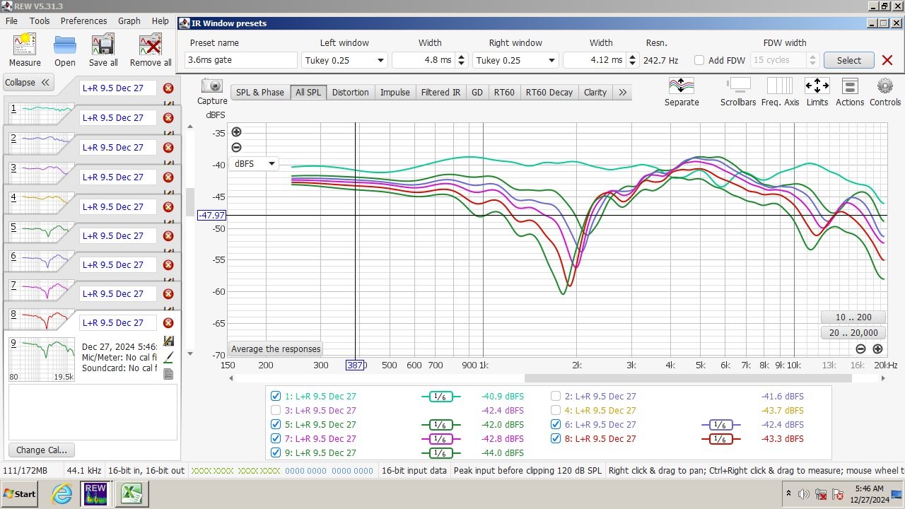

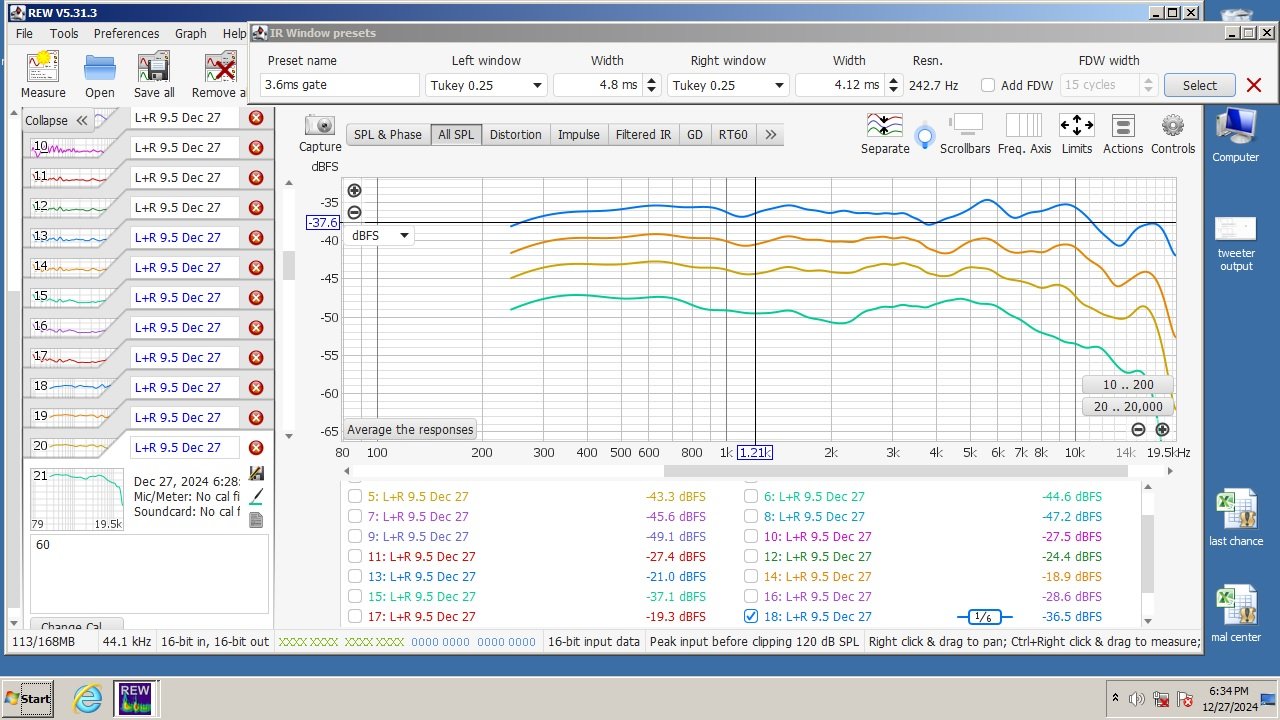

I wanted to measure the distortion of my other wave-guide tweeter. I set it on top of a speaker. The distortion is considerably lower. The results of what I did next, really surprised me. I measured off axis. I just kept turning the box till I was out past 60 degrees. I think I want to use this tweeter.

I'm not sure I understand your 30 degrees comment, unless you were thinking the same thing that I was, and that being how nice the second and third sweep looked. There's some diffraction going on for sure, but the 3k, to 5k range drop along with the top end. The tweeter faceplate is 80% exposed, and can cause some diffraction. I also measured on an 11" wide baffle, and roll-off was not as smooth. I think that if it was in a more optimum baffle width, with 1/2" round overs, it would be pretty smooth.
I'm even wondering if a horizontal break, ( think really wide chamfer. ), in the baffle of 12 degrees between the tweeter, and woofer, to tilt the tweeter off axis when at the listening axis, might be an option. Although this would aim the tweeter slightly towards the ceiling, the additional off axis roll-off vertically would reduce what reaches the ceiling anyway.

What I did not explain at all, is the fact that if the speakers are firing straight ahead into the length of the room, it would not be unusual for a listener to be 30 degrees of axis. Depending on design goal instead of letting the optimiser work with the on axis response, you can use the 30 degree to be optimised.
I am still playing around with a large 12 inch co axial with a horn loaded tweeter, it has its smoothest response around 30-40 degree of axis so that is what I work with.
Since yours is a coax, if you tilted it vertically about 20 degrees, the side to side off axis would vary from 20 degrees to 50 degrees, but do so with only going about 30 degrees side to side movement. That's hard to put into words. The driver on axis would not be listened to on axis, except maybe if you stand up near the speaker. I could do the same with this tweeter possibly, and the woofer would benefit from the non -flat baffle too.
