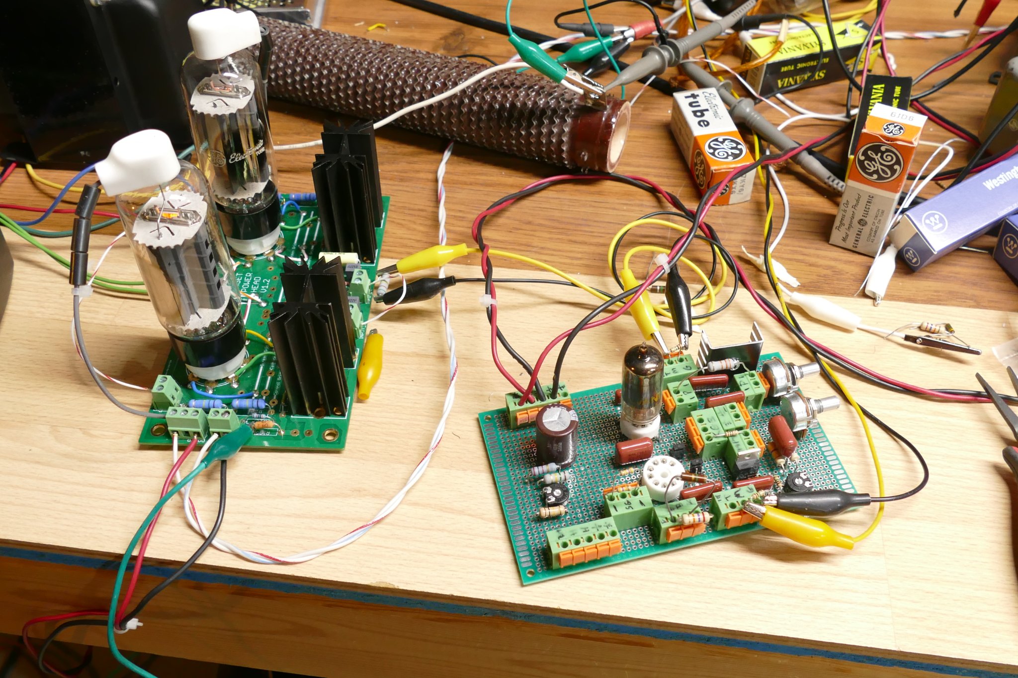

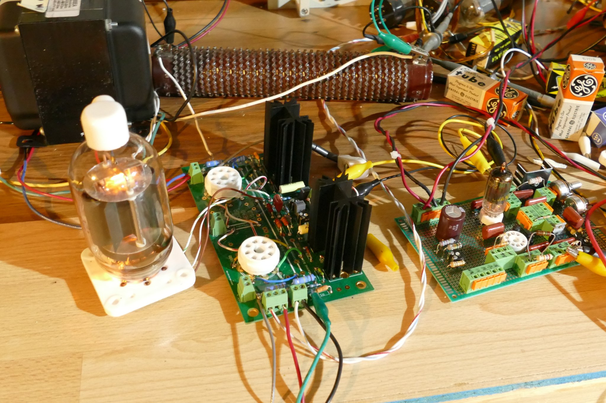

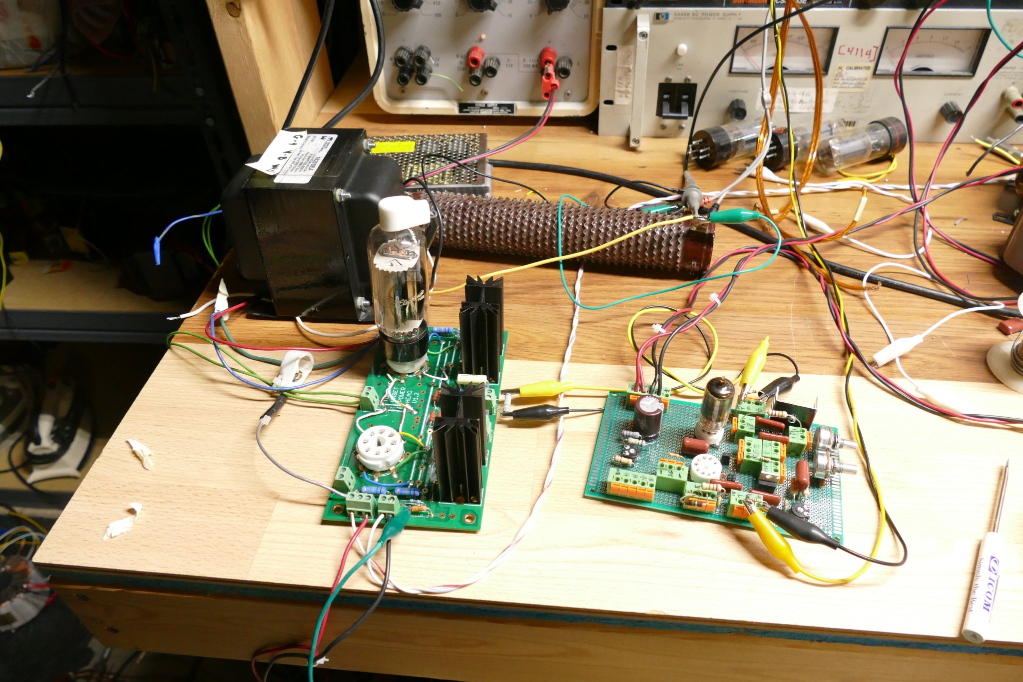

Low THD isn't wrong, but maybe not the only important parameter. Did you look at the harmonic spectra? Or did you maybe even use the board to drive a power amp and speakers with music to your ears?
As stated, the THD is mostly second harmonic. The driver board has been tested with an UNSET based output board in SE with a single large TV sweep (line output) tube, a pair of the same tubes paralleled, and a 4D32 transmitting tube for a 20 watt, 40 watt and a 30 watt SE amp. Sound quality is excellent and a complete amp build using this tech is likely.

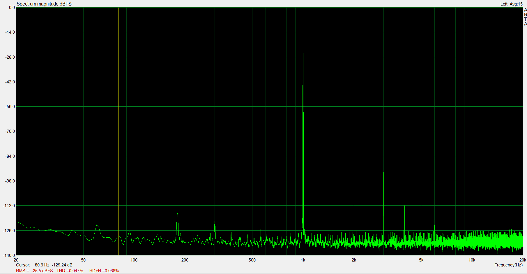

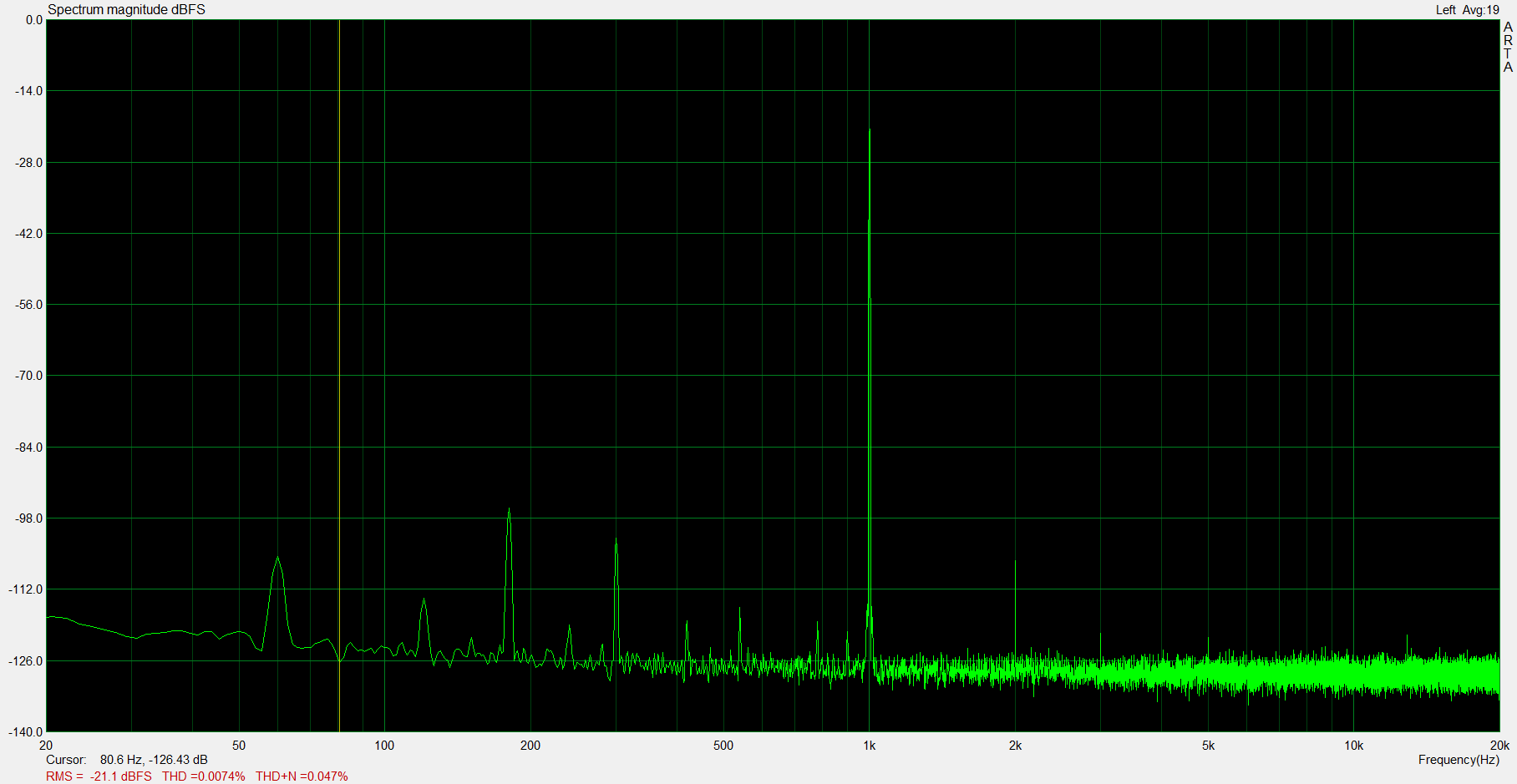

I've done experiments with CCS-loaded pentodes with shunt feedback and my experience is that even with very large amounts of feedback, the output will be 2nd harmonic dominant until you get to a high enough signal level that you start approaching saturation and the positive supply (then you get compression on both ends and a rise in 3rd harmonic). Here are some measurements of a CCS-loaded EL34 with enough feedback to bring the gain down to 10V/V. This had a 1000V supply and 600V plate idle voltage, so 50Vrms out goes nowhere near the supply or saturation. Then I cranked it up and you can see 300Vrms out has a much more odd-harmonic content as we approach areas where the system does not behave as nicely.
The lesson I took from this is that as long as you pay attention to how you are treating your pentode, you don't have to fear its distortion harmonic character.
The other interesting thing is that even though I have made attempts to confirm it in tube circuits, I have never seen any evidence backing up the Baxandall graph that you sometimes see where adding feedback suppresses lower order harmonics and raises higher order harmonics (at first, which then can be suppressed by increasing feedback further). In my experience with tube circuits, all harmonics go down with increasing feedback.
