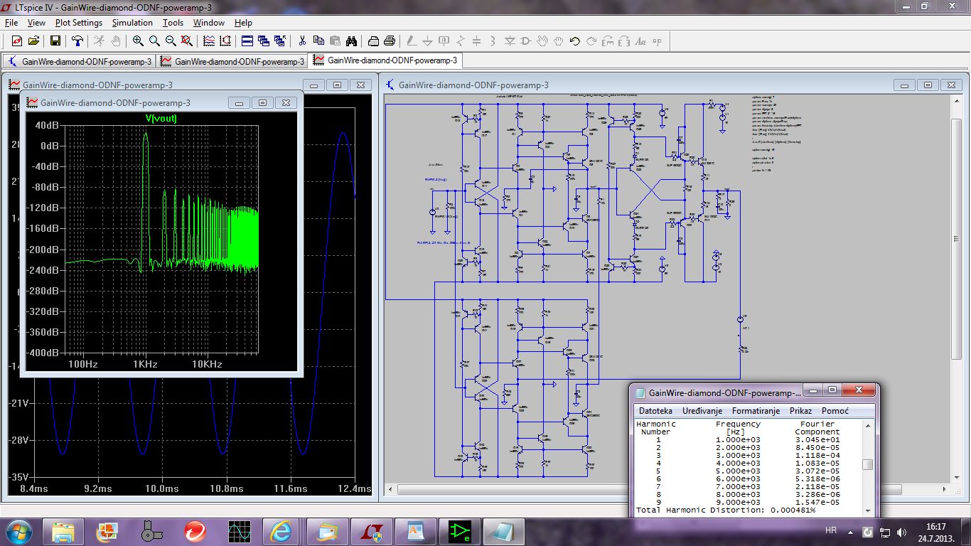

Impressive! The question is, is this down to LTspice op amp models or is this discrete op amp that good?

Discrete op amp shows better result. With some famous op amps I couldn't stop oscilation for now.
I think to get this to work right what you need is a differential summing amplifier just to sum the input signal with the output signal and output the difference. The difference should be just the distortion product from the output stage. What you have right now is a huge amount of negative feedback summed with the input signal and output of your voltage amp.
No, it is not like that. At the op amp output there is only differnce between input and output, means error signal only, theoretically!
You're finding what I found trying to use this system in a Feedback amp. It just became impossible to get the stability and distortion cancellation.

Yes but this only happens with a perfect null. It's not that easy to do. You have to have both the phase and amplitude matched tightly kind of like Bob's DM.

I tried first .ac and nothing indicated that there is going to be problem. The otput stage has compensation C1 and C5 is in the gain stage.
But here is interesting part. I used linuxguru opamp from http://www.diyaudio.com/forums/anal...screte-opamp-open-design-294.html#post3568890 and here is result.
Thats more like it 😉

Yes, nothing is perfect, complete nulling requires phase match and infinite opamp gain.
Cool stuff - it actually works quite well, even for an application it wasn't designed for!
In practice, you'll have to match the LTP FETs and cascodes closely, in the discrete opamp, to get results close to the sims, but that's manageable for a discrete, through-hole design.
