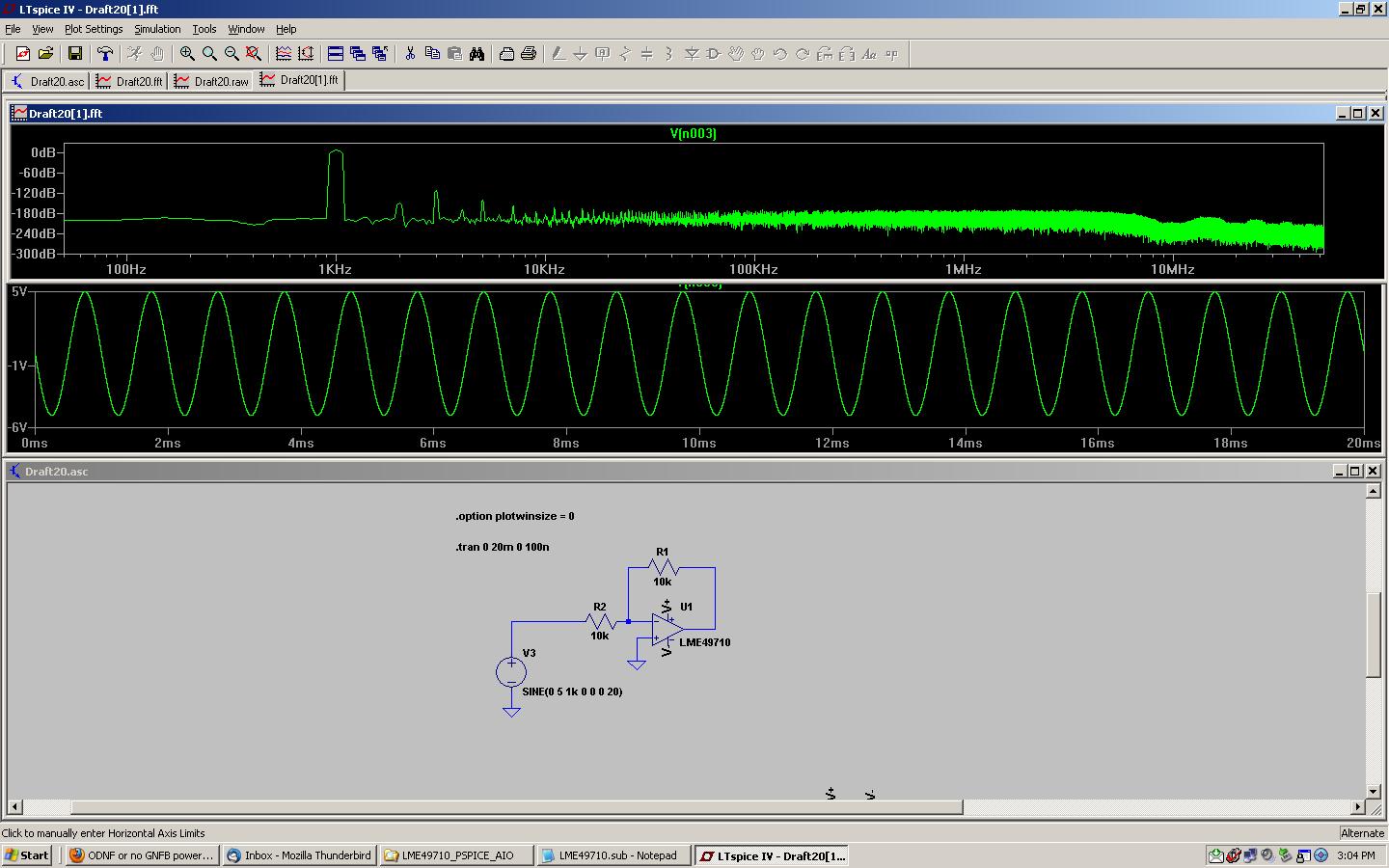

LTspice files
Here ya go.

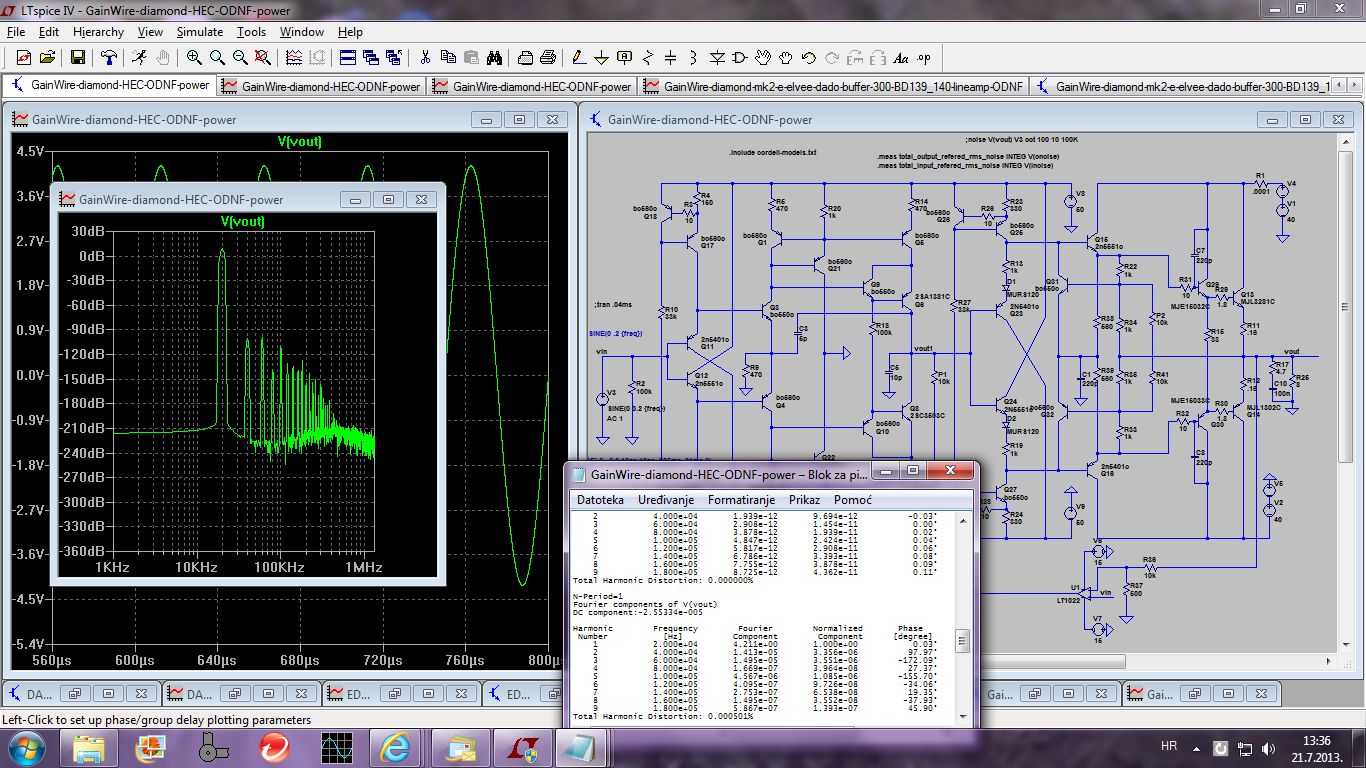

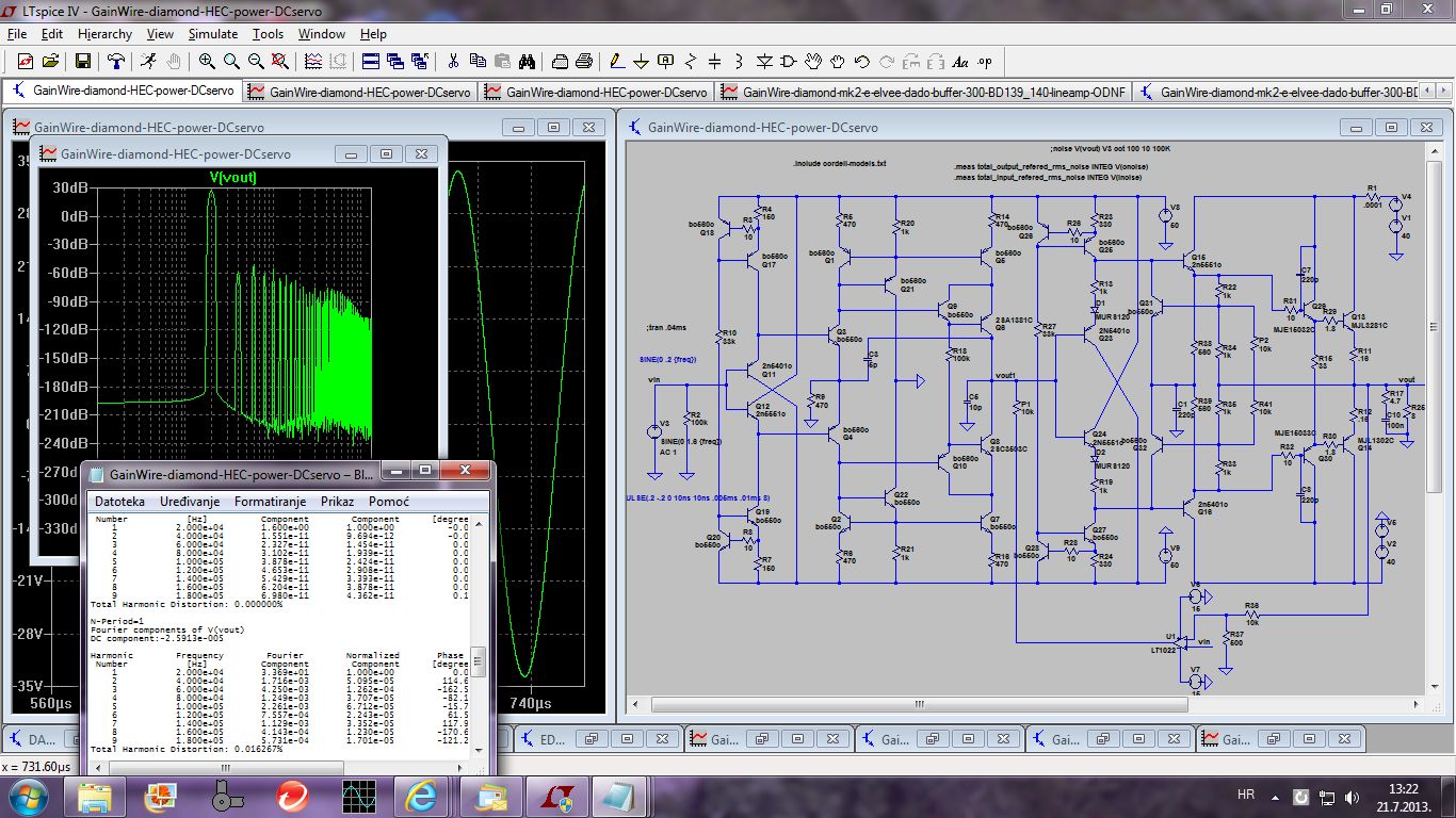

I will try to compare ODNF type of the power amp with the one with HEC output stage.
ODNF looks very promising but after extensive simulation my opinion is that it has some disadvantage compared with NGNFB with HEC output stage.
At first glance ODNF offers lower distortion, but first it’s tricky to adjust voltage divider at –IN of the opamp for lowest distortion. Attenuation of that divider should be the same as the gain of whole amp, but in practice it differs influenced by used opamp for ODNF feedback. And more it changes with input signal level, at least in the simulation. If we look at distortion harmonics distribution HEC looks much better.
Finally the clipping behavior of HEC is better the the one of ODNF.
Damir
I was wrong about voltage divider exactness (at –IN of the opamp) to achieve lowest distortion. It is not critical at all. I was thinking that is very important that +in and -in of the opamp should be of exactly equal values to get at the output (opamp) distorted residual only. If the divider is not exact still distortion was diminished(very litle influence on THD) but it influences the gain in tine not important amount.
I tried to use LME49710 but got the same stability problem as with LT1468, should investgate more.
BR Damir

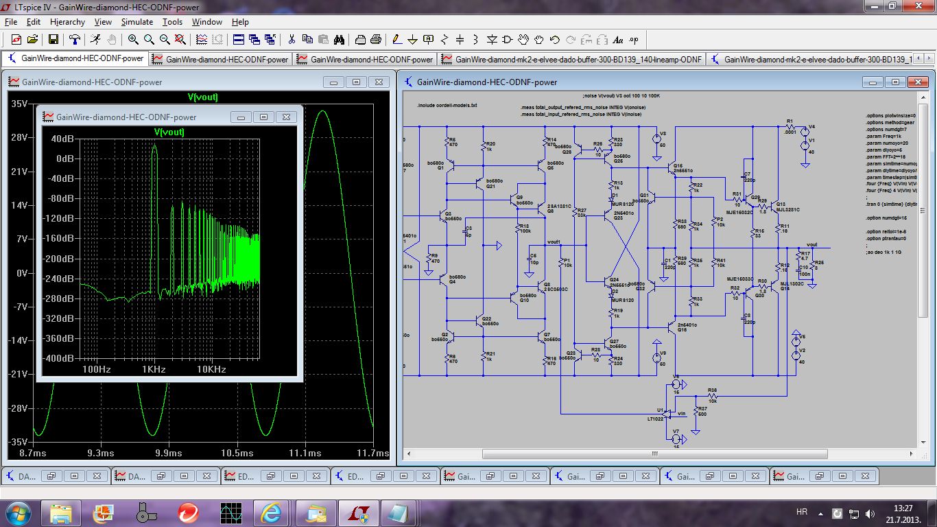

Maybe this could be good ODNF (HEC + ODNF)power amp, it needs improvements in high frequences, but I could not make it stable with better opamps. This is at 80W on 8ohm load.
BR Damir

This is a great start on distortion cancellation methods/techniques and ought to draw more attention to new topologies for harmonic distortion reduction. Can we get similar results with less complicated circuit toplogies?
Thx-RNMarsh
This is THD20k first watt.

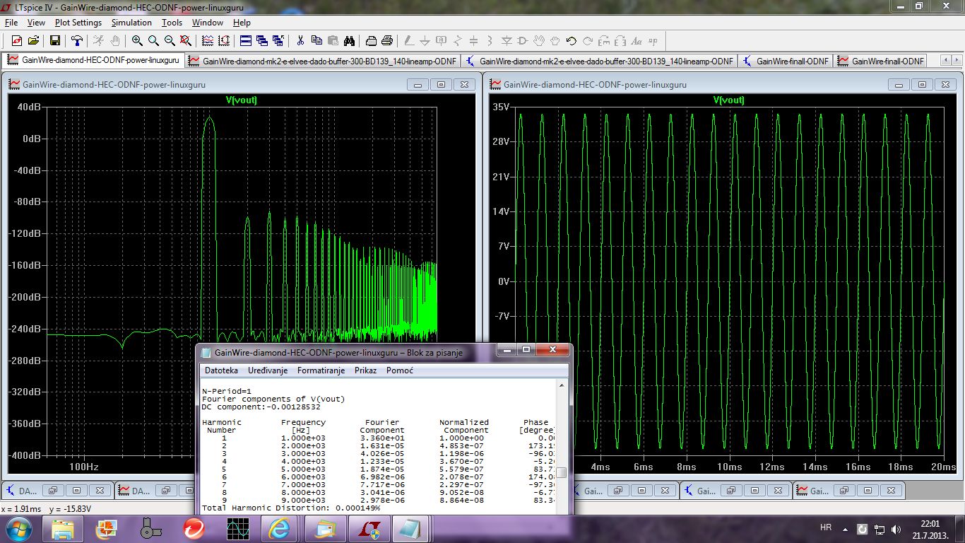

I tried first .ac and nothing indicated that there is going to be problem. The otput stage has compensation C1 and C5 is in the gain stage.
But here is interesting part. I used linuxguru opamp from http://www.diyaudio.com/forums/anal...screte-opamp-open-design-294.html#post3568890 and here is result.
