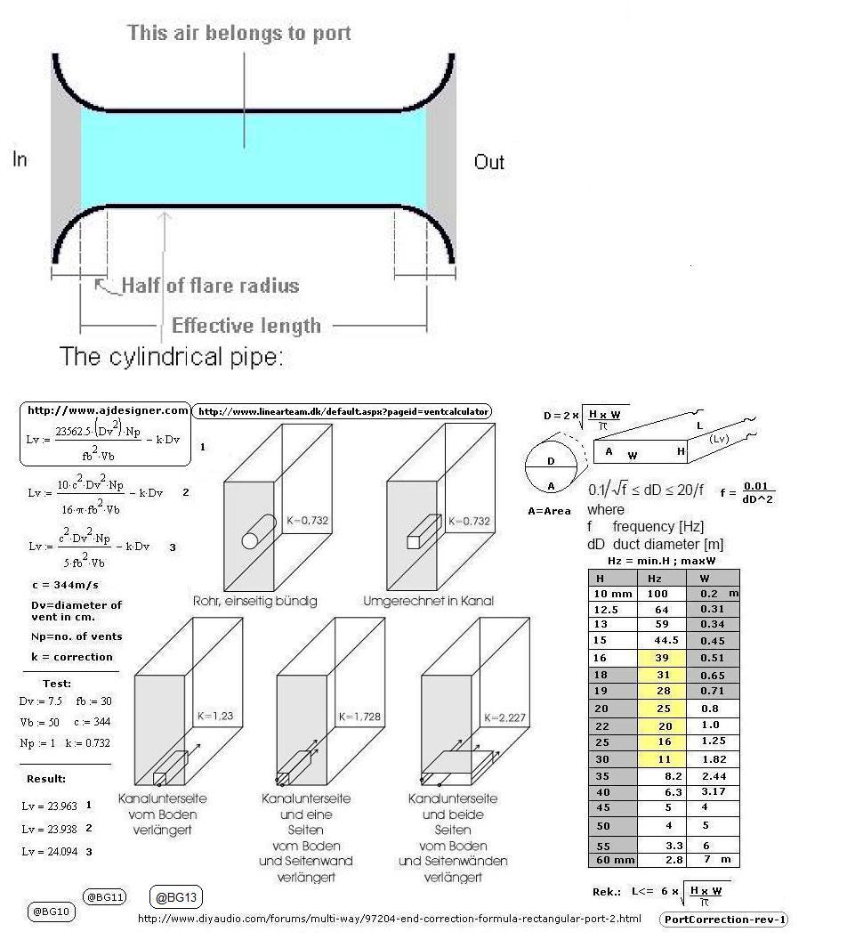

If a slot port is built in against a wall of the cabinet, as many are, we also need to adjust the port length - this is because 3 of the 4 walls of the port are now much longer than the 4th - the good news is this means a shorter 4th wall is used, taking up less space in the box.
The bad news is that simple modelling programs like WinISD don't calculate this, we need to do a bit of number crunching ourselves.
The attached graphic, provided by Bjorno, shows a couple of the manual formulae that can be used for this and provides the alternative "End Correction Factor" values to use to calculate the new, shorter port length.

I would look at the attachment in post #2
WinISD only has error correction up to .850 for 2 flanged ends
assuming your building a slot port that shares 3 wall of the cabinet you need a end correction of 2.22
which WinISD wont calculate.

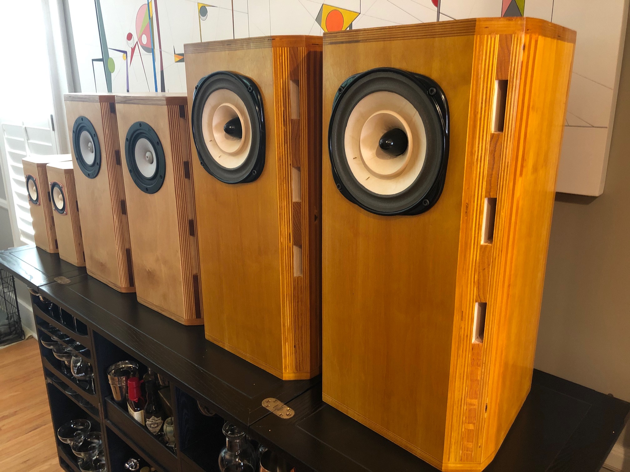

Something i have explicitly explored and now much prefer.
A longish high aspect ratio slot vent adds R to the vent. Literally hundreds and hundreds have been built and people are happy with them.
The sims you do need to be extrapolated to estimate the end result, they will only go as low as they go, but the bottom tends toward nuanced and well defined, with a higher tolerance to dynamic changes in T/S parameters.
