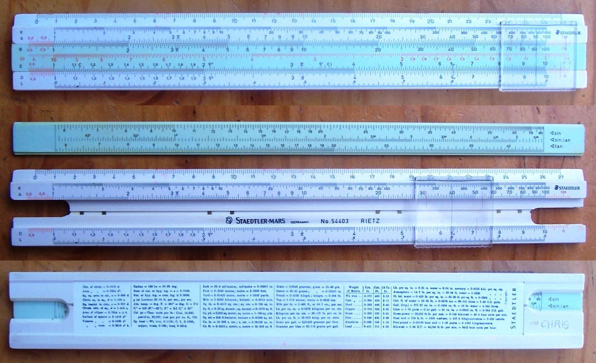

So the practical everyday way was to hand write needed equations and solve them using the MIGHTY Staedtler slide rule (I still have mine):
VERY fast , as in seconds to give you accurate results .
Accurate here meaning 1% or 2% error tops, well within Engineering or Technical needed precision; after all purchased parts come from a "preferred" series of values, besides manufacturing tolerance, so .....
