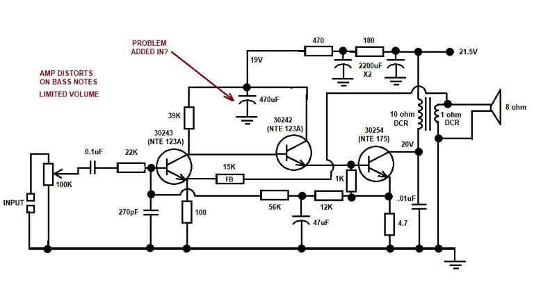

If that output transformer has a secondary higher than 8 ohms, you would get more power with a higher impedance speaker. Start with a much higher impedance, and drop it till the maximum voltage swing starts to take a dive. That will tell you what the speaker impedance needs to be (aside from measuring turns ratio directly). Power will fall as the speaker impedance is raised too, but you will get full voltage capability with a high impedance load.
Being a single ended amp, best load impedance is the one which gives roughly symmetrical clipping.
Too high impedance, top peak will clip earlier, it runs out of voltage swing.
Too low impedance, bottom peak gets clipped for lack of current.
Sadly, the thing was made for a pair of only 8 ohm speakers.
At this point, with a line source input, it plays a pair of smaller speakers at a comfortable room level, able to talk over, a tad higher than background music.
I'll admit it's nothing special.

I don’t think I’d go modifying that particular turd by adding followers to an output stage eating 3 watts. If this were part of some stereo set you might actually want to improve, I’d just put in an efficient-running class AB amp using the existing power supply. Being able to supply six watts continuously to the existing amp, it should run as a higher power amp (around 6 watts a channel, sine wave on that voltage) with a normal music signal just fine without overload. Chip amp is the “easy” way. I’d go discrete myself, to eke out a couple more peak volts using bootstrap, and be able to optimize the output stage bias, rather than being stuck with the setting in the chip. A well stocked junk box could build it for “free”. The existing heat sinks are big enough.

Back to the OP problem: a humble TDA2030 fed from his nominal 20 V supply, needing a capacitor output of course, will fit in available space and give him incredibly good 4W RMS into 8 ohm, per channel.
Day and night compared to current results, I suggest he breadboards one , connects it to current supply and speakers and give it a try.
His Friend/Customer will LOVE results.
If unavailable or suspect, use guaranteed LM1875 from Mouser, same pinout and circuit.
Just try it: simple, cheap, available, do not polish the current turd.
As mentioned above, supply will feed it well if used clean, with Music program.

The NTE175 is a 35W TO66 power transistor which would be required if the standing current of this circuit was higher yet the measurements suggest it is only of the order of 150 m.a.
While the transistor appears more than robust enough for the application it is possible the the 4R7 resistor connecting to the emitter has been damaged through exposure to heating over the lifetime of over 50 years and the actual value has "gone high". Strangely values this low can also serve as fuses under fault conditions and not show any visible signs of any issues. I have observed this possibility with an external pre-amp power supply when one or other of the rails had been short circuited by accident.
