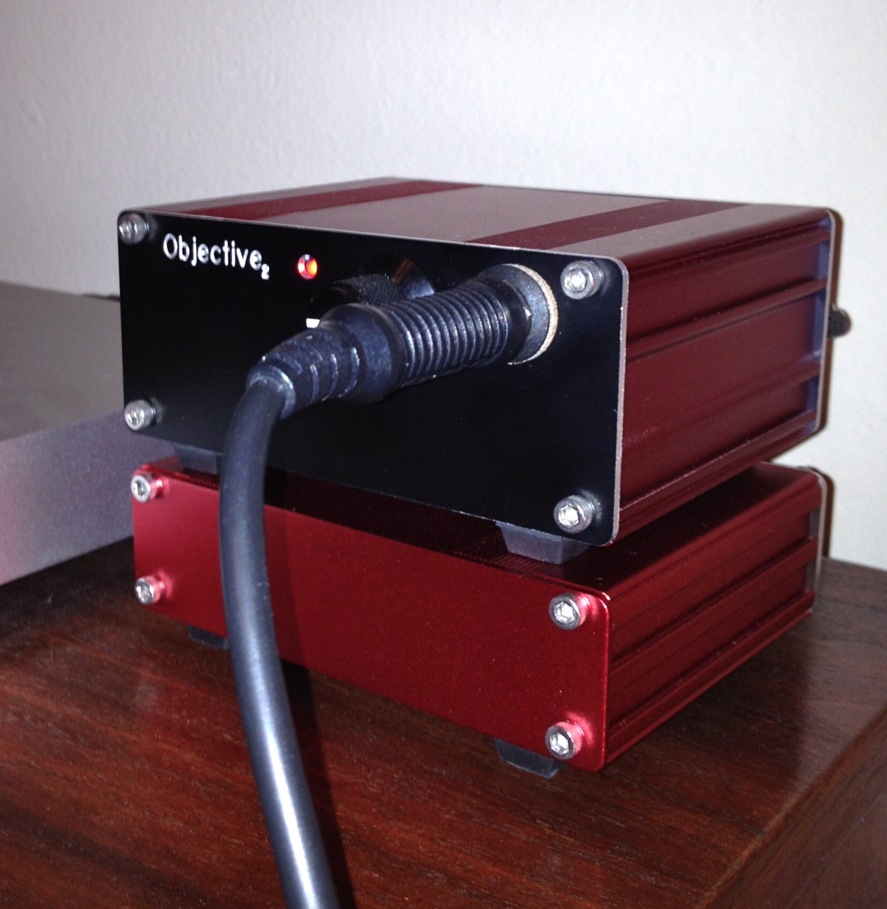

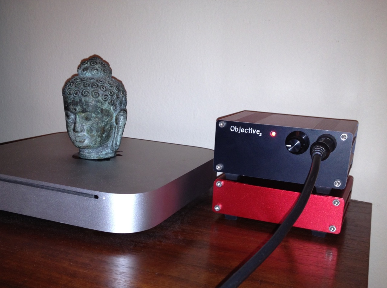

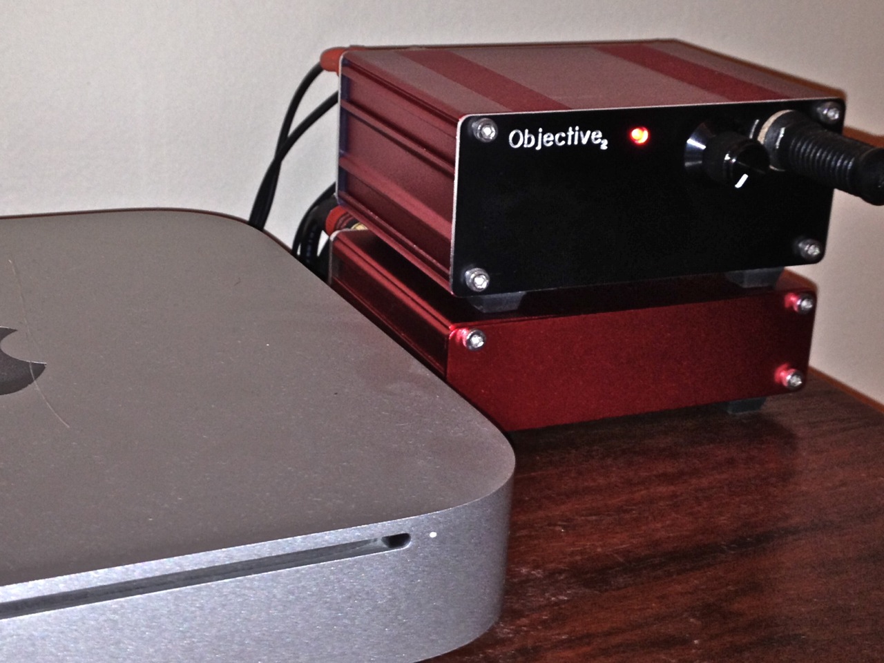

pics: ODAC with O2
I bought the O2 a couple of months ago from Joseph Tam at Audio Poutine. It was just recently joined by little brother ODAC, also built by Joe. A handsome duo, to be sure (the O2 and ODAC, not me and Joe). Really nice work. They both have RCA outs and the O2 has 1/4" headphone jack. And both sound amazing. I bought a 2nd O2 (blue this time, looks really sharp) for a good friend who lives in Europe; I just might have to get him the matching ODAC as well.
