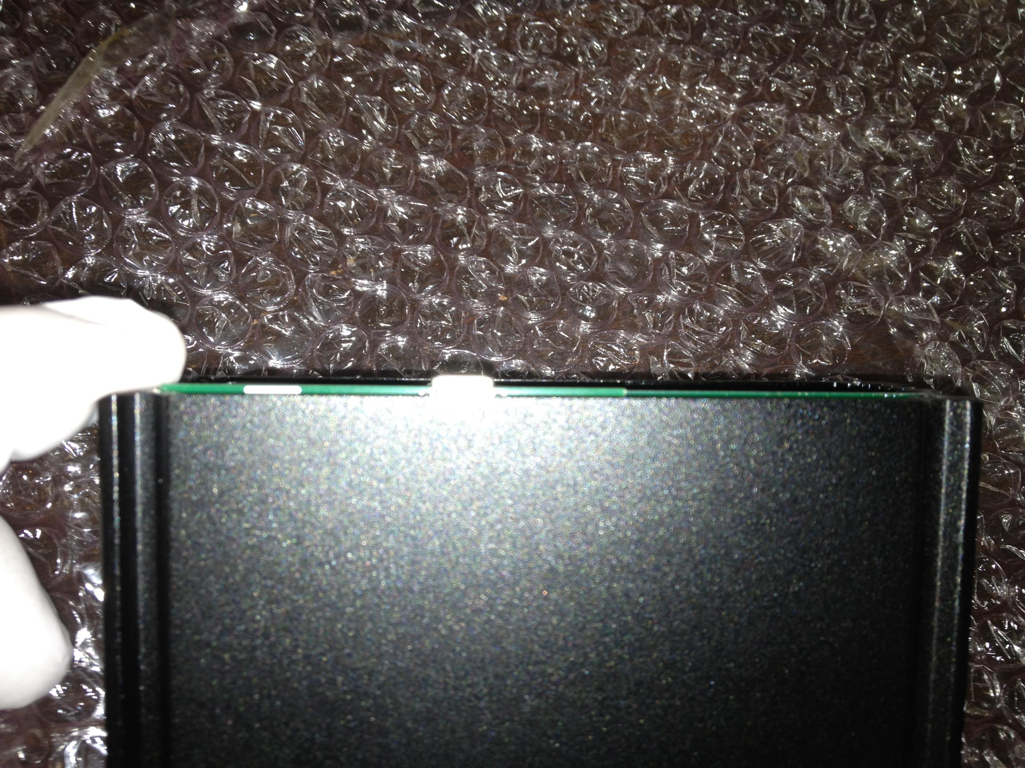

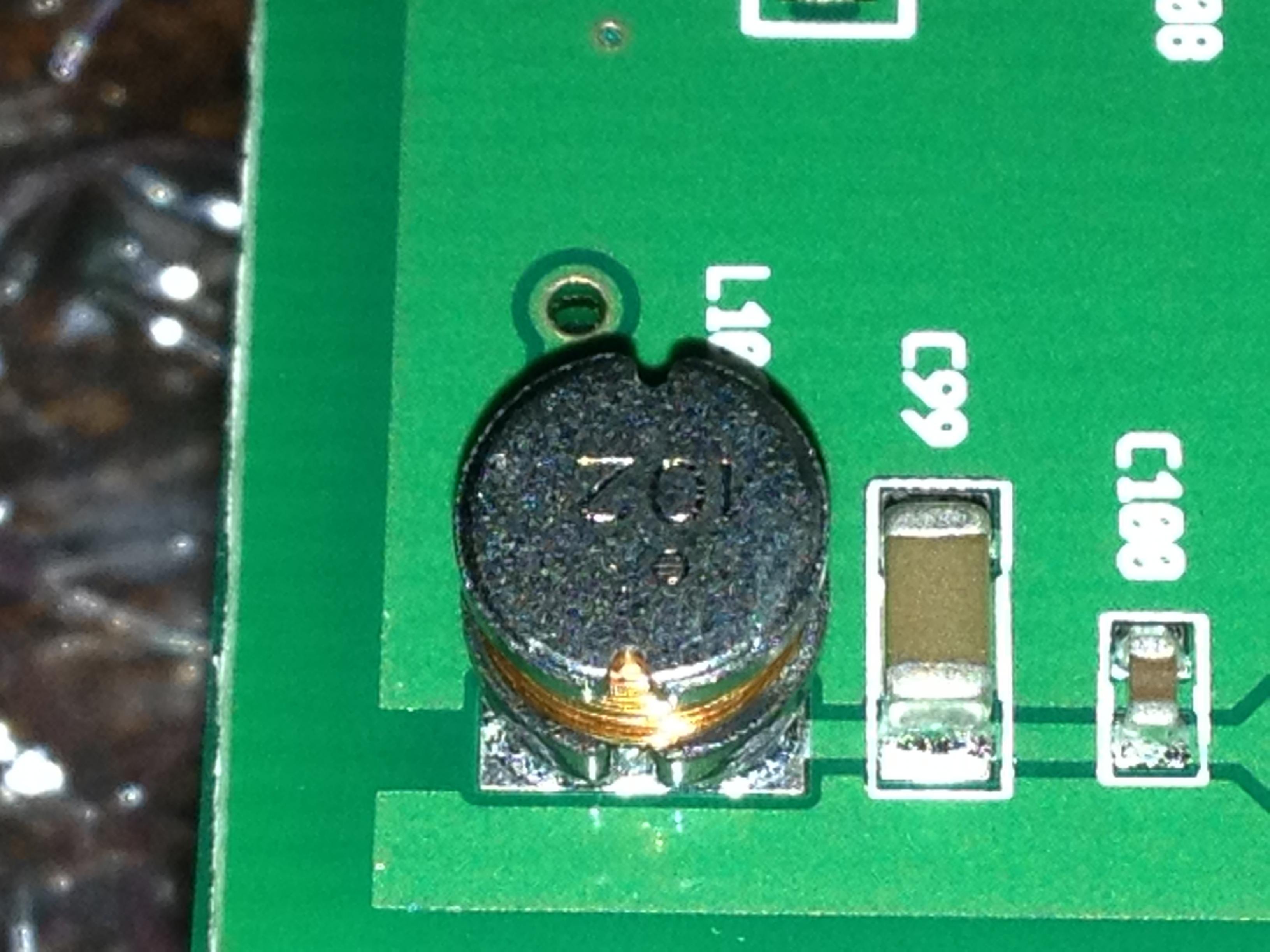

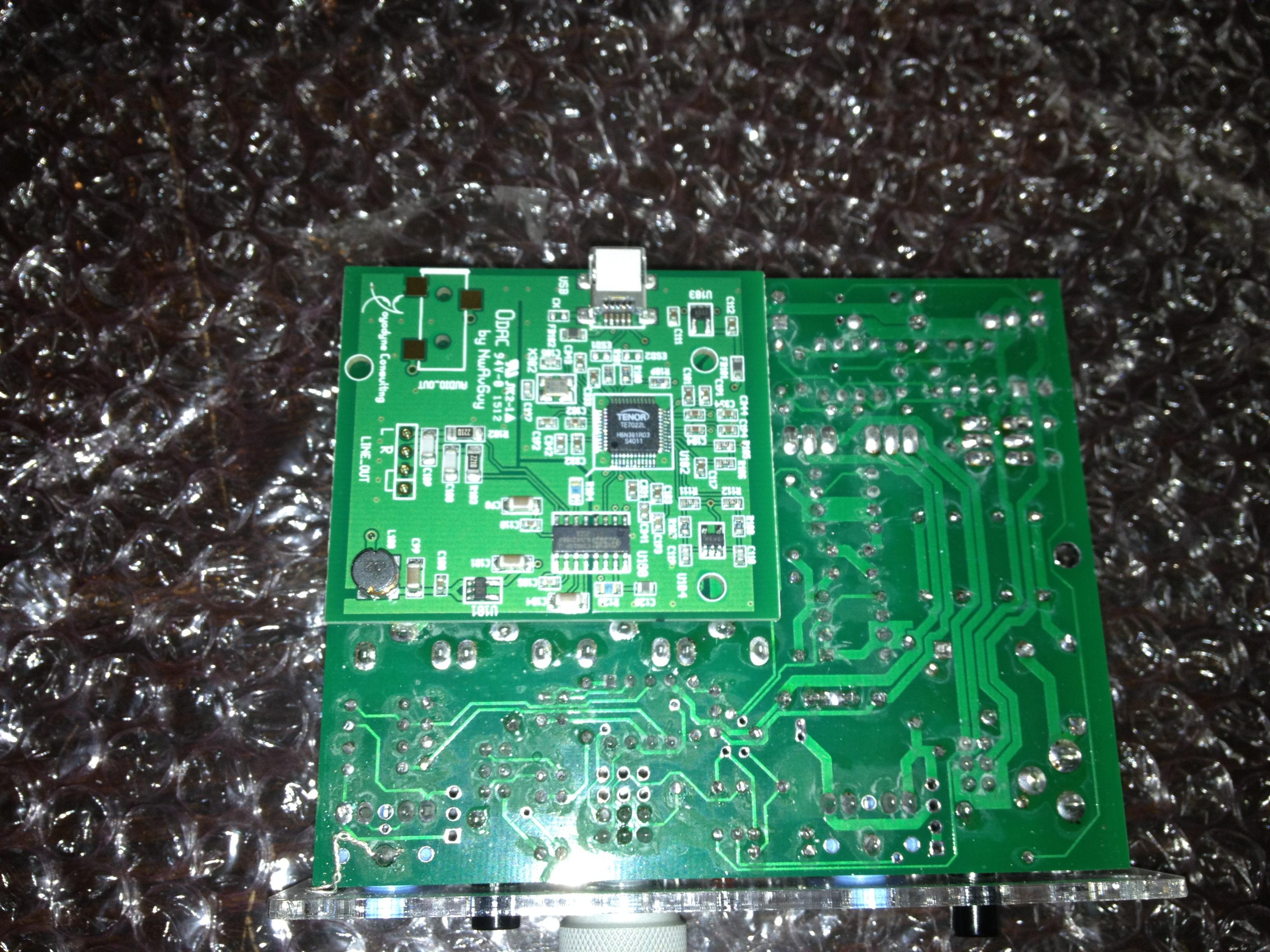

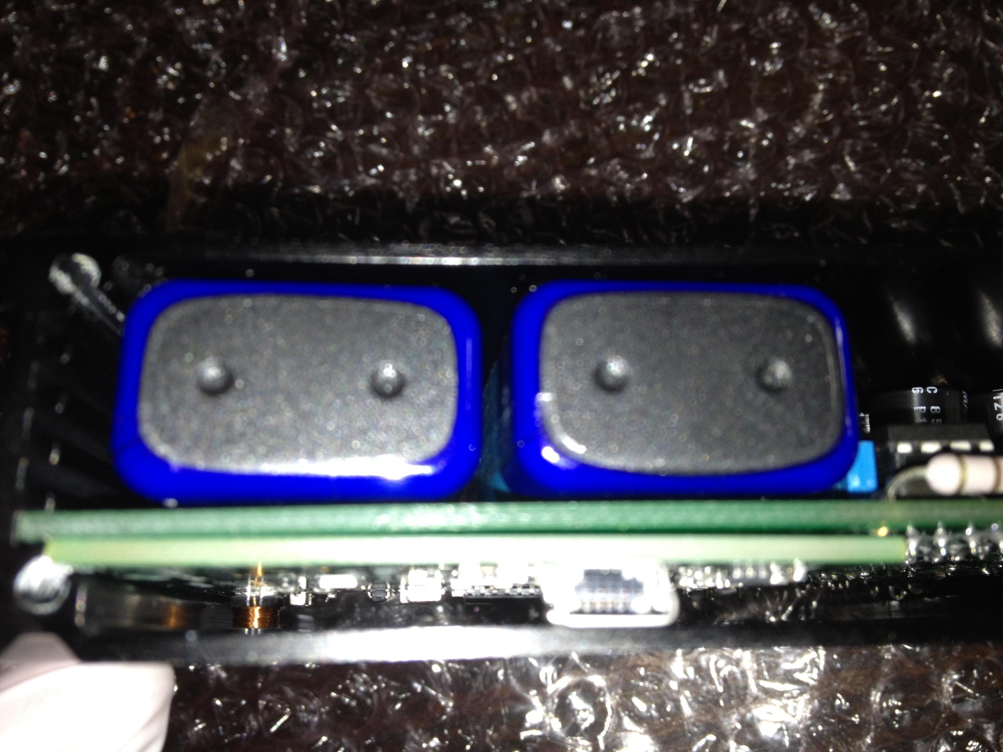

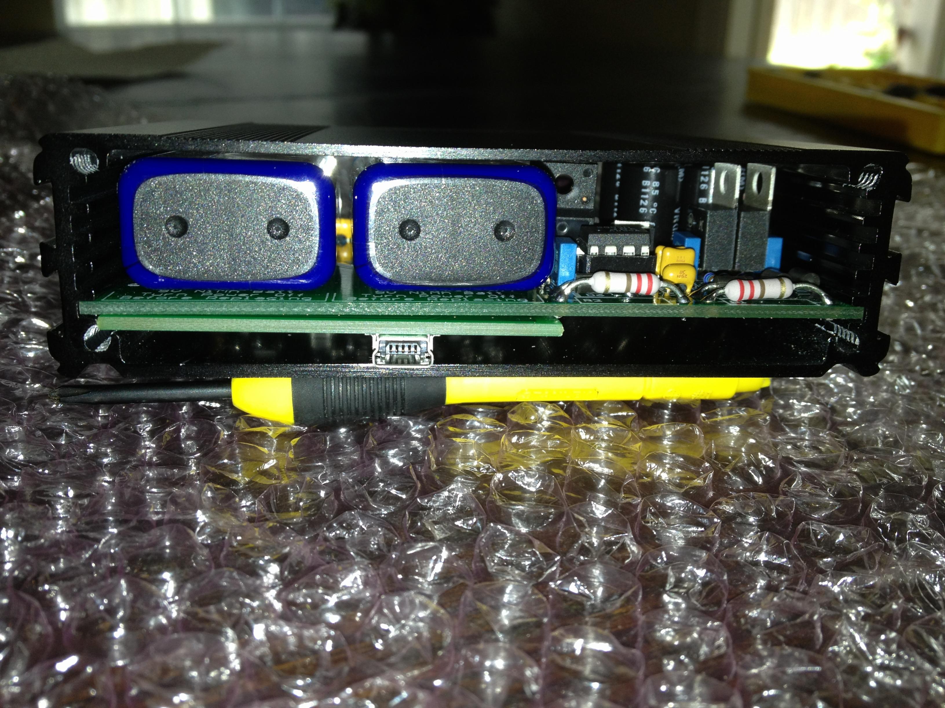

Pics added with ODAC "crammed" inside B2-080 case with Objective 2 amp with batteries still in tact. The pics are of a test fit, I have not burnt any solder yet.
Please note, the micro "copper spool"(exposing the depth of my knowledge here). does contact the inside of the case bottom, as does the micro usb connector. Any possible issues with this?

you need to make sure the few traces at the bottom of the odac is not going to short out the o2
also how would you make the hole for the usb? notch the plate?

yeah, regarding the usb, I would probably drill it out and then work it with a dremel/file. I suprised it was not designed to be used in this manner as it seems to work well.

I would suspect the coil that is touching the case is not going to be a problem, since the top looks plastic (an isolator). As far as I know the outside of the USB connector is also connected to earth and can potentially cause earth loops. But that is easily heard. Else put some isolation tape on top to isolate it.
I was wondering if you only use 3 screws for the back plate, since the ODAC pcb is in the way of the screw thread in the case. And how much pressure is put on the O2 pcb by this. I would be nervous if there is pressure on the bottom near the USB connector, that this would flex the 02 pcb leading to breakage.
