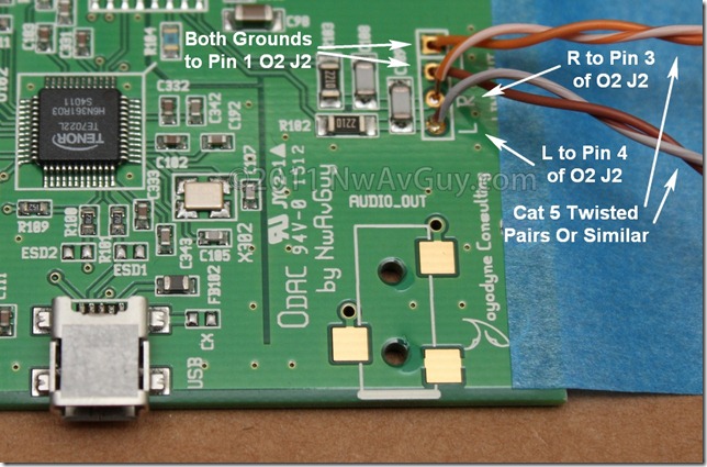

Dear Stefan, you have a big fault in your guide on how to connect the O2 to the ODAC.
http://www.headnhifi.com/components/com_jshopping/files/demo_products/How_To_O2_ODAC.pdf
In the last picture at page three you have shown that the black wires go to the upper holes and the white to the lower ones. This is reversed and if you do it like the way in the guide you'll en up with mono sound because so have I.
Looking at this picture here
It show the right way of doing it. If you want I can supply you with a new picture for your guide if you're not okay with "stealing" it from NwAvGuy's blog.

Hi, thanks for pointing this out. I took the guide offline and will correct it.

I'm glad I can help 🙂
