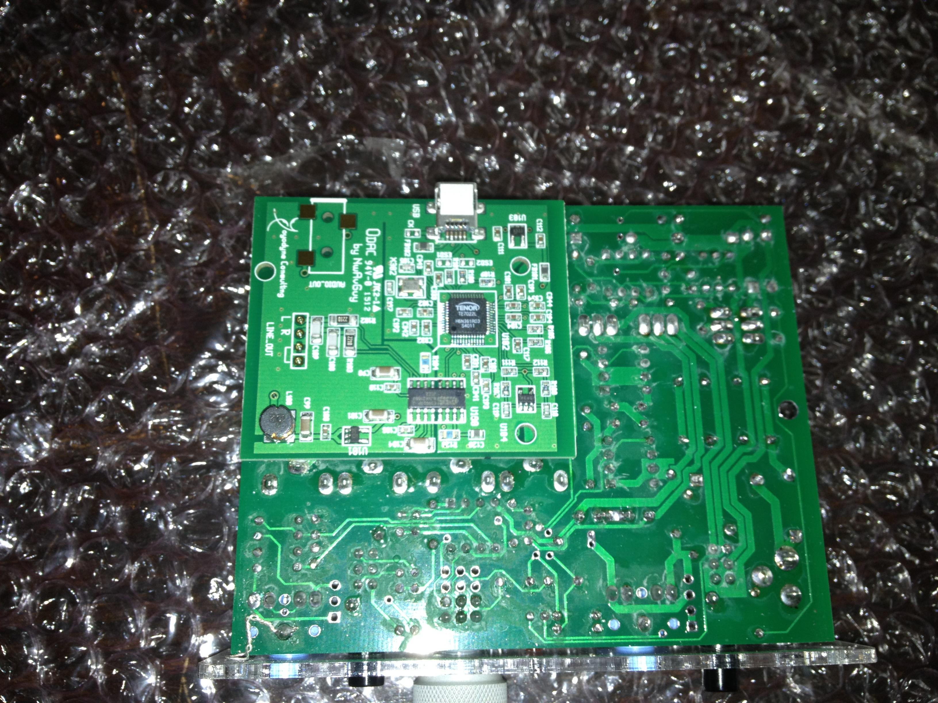

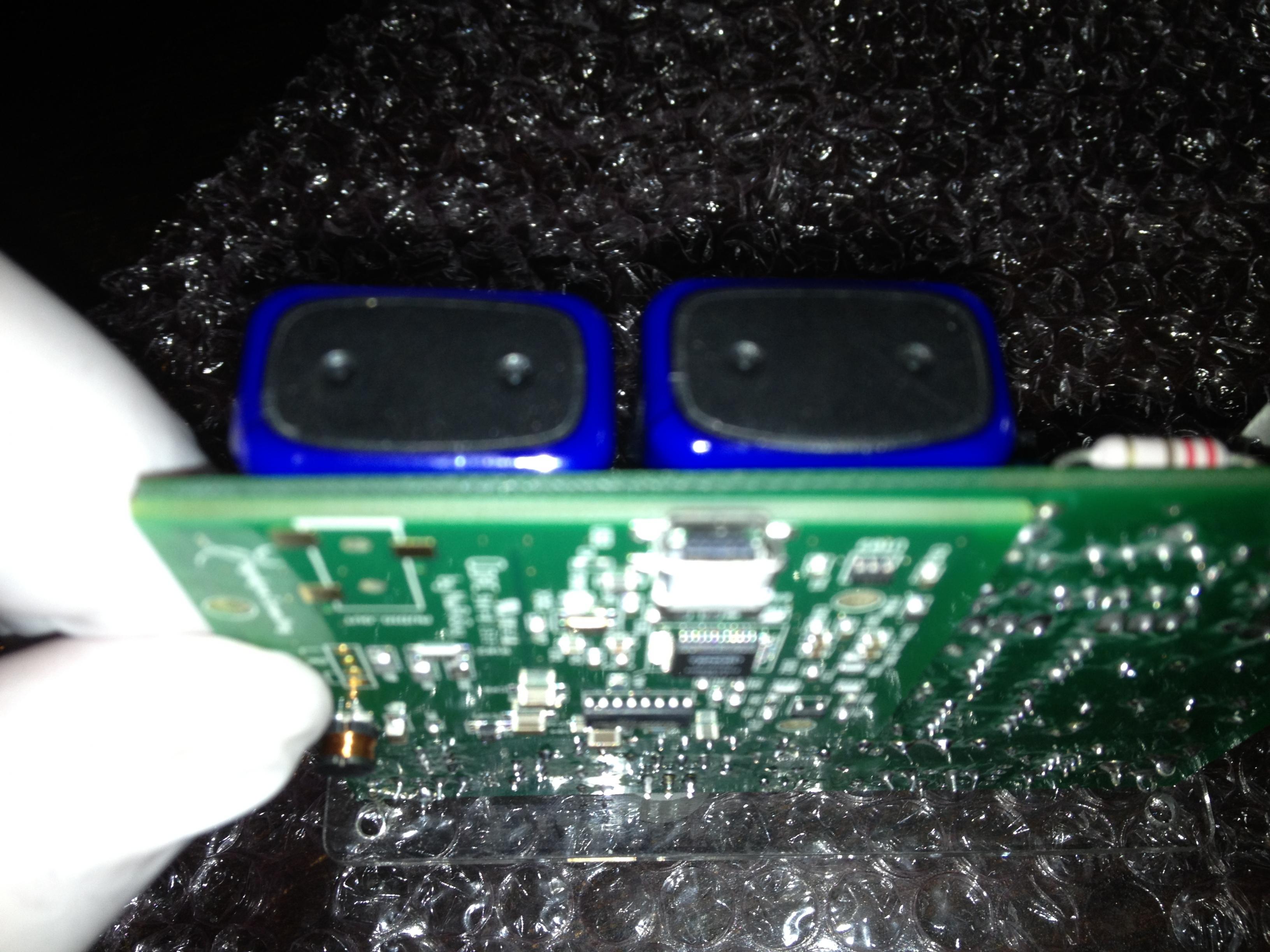

I did find out more information on the proper way to install Odac board into O2. It looks like the above info is also wrong. As the odac is supposed to automatically disconnect when you plug in any other input, and it will not as installed above. I read this on another forum. (Bada Bing, from Head-Fi)
If you wire directly to P1 pads, the ODAC is hard wired to the input of the amp all the time.
If you wish to have the input switch built into the input jack socket function, i.e jack in an
external source disconnects the ODAC, jack removed connects the internal mounted ODAC,
then you must cut the traces and wire to pins 3 & 4 on the underside of the O2 pcb
for L & R out of the ODAC.
If you wire the ODAC directly to P1, a potential problem is if you connect an external source
and forget and also have the ODAC powered and playing as well. This wires the
outputs of the two sources directly together. The two sources
will "fight" and over draw current from one or the other with potential damage.

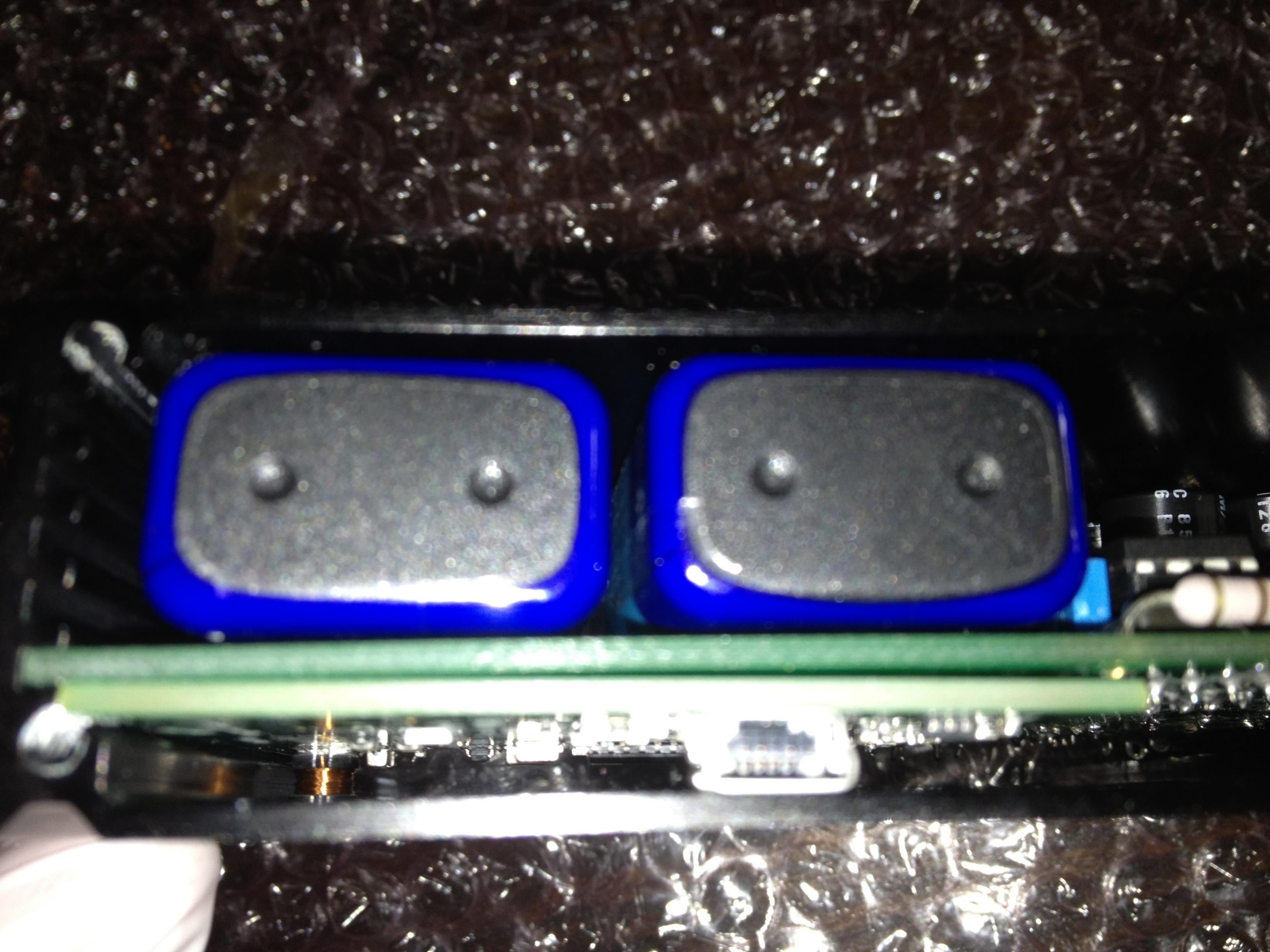

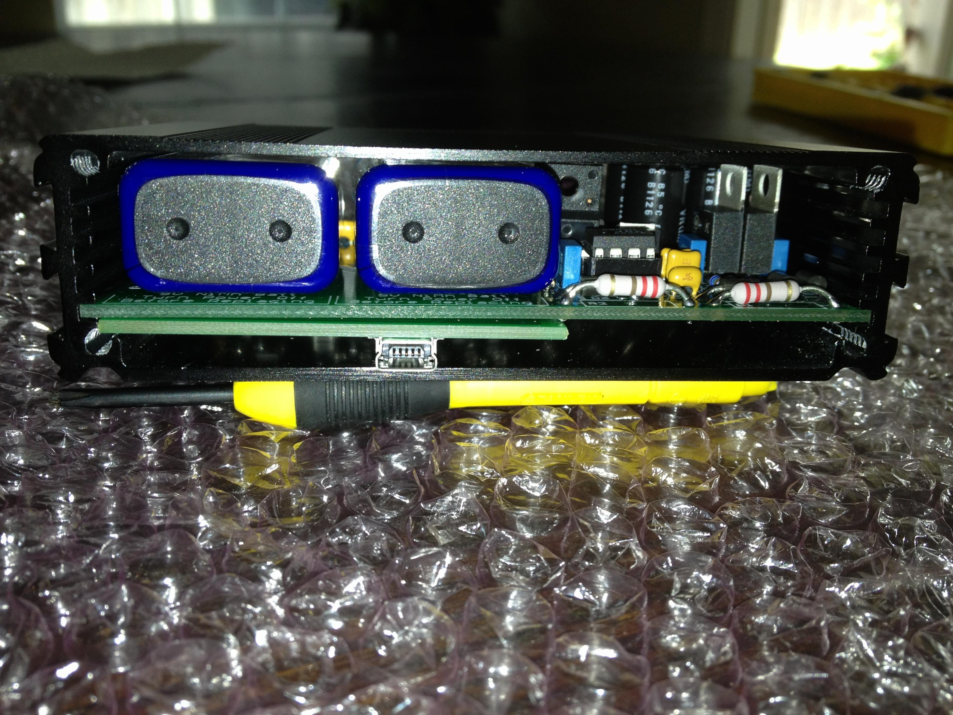

ODAC "crammed" inside B2-080 case with Objective 2 amp with batteries still in tact. The pics are of a test fit, I have not burnt any solder yet. The inductor and the micro usb port do make conntact with the case botttom(not sure if this is an issue)?, its a tight fit with some filing of the ODAC pcb it would fit slightly better.
They upside of this for me is retaining battery operation. I'm not clear on how to wire this to retain the input jack or what type/gauge of wire to use. Any advice is appreciated.

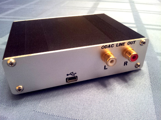

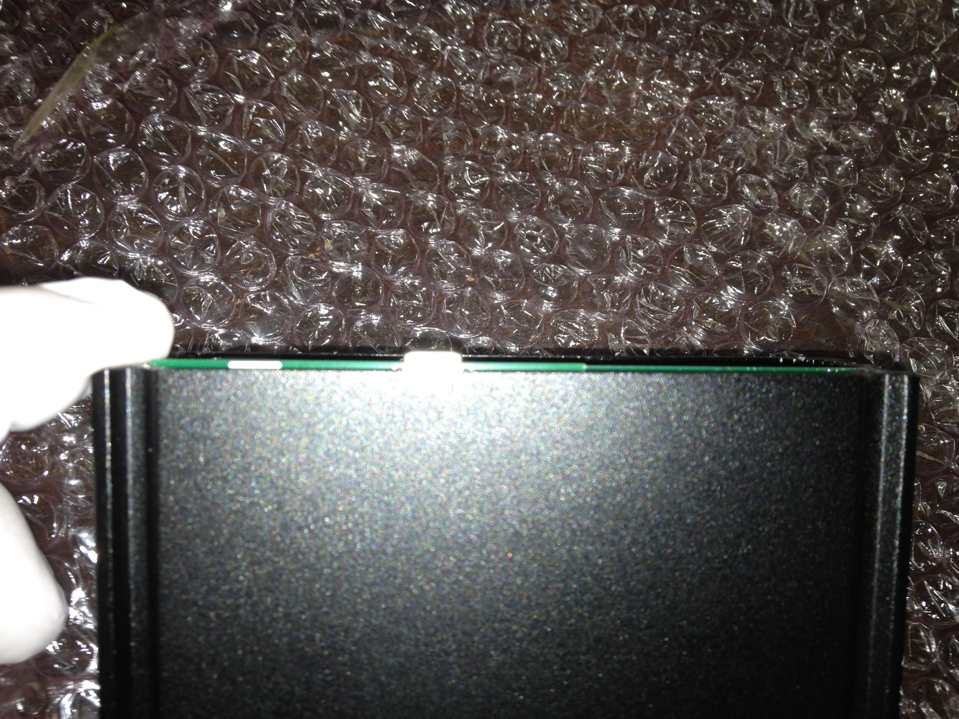

I received my custom back panel for the O2 + internal ODAC board from Front Panel Express today. Both the front and the back panel are of my own design, using FPE's software.
As mentioned by others, flipping the ODAC board upside down and mounted below the O2 PCB results in a tight fit, but retains uses of the batteries. I added two RCA jacks for a line level ODAC output in case I want to send the audio to another amplifier.
Here's the result:
Here's the result:
Here's the result:
That O2 with the RCAs coming out at the back plus ODAC is looking sweet.
What type of RCA are those?

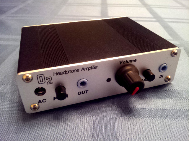

The full O2 kit from Stefan contains nice brain puzzle.
The power connector does fit well if the front panel is not mounted, but the connecter is too short when the panel is mounted.
I've thought that I would need to drill bigger hole into panel, or buy a new connector ... but ... the problem has much easier solution... ;-)

Hi miero,
am I allowed to solve it?
Solution is a sharp carpet knife and a steady hand 🙂 I take about 1.5mm of the insulation on the barrel of and the plug fits snug.
The barrel on the power supply has standard length, all power supplies will have the same "issue".
