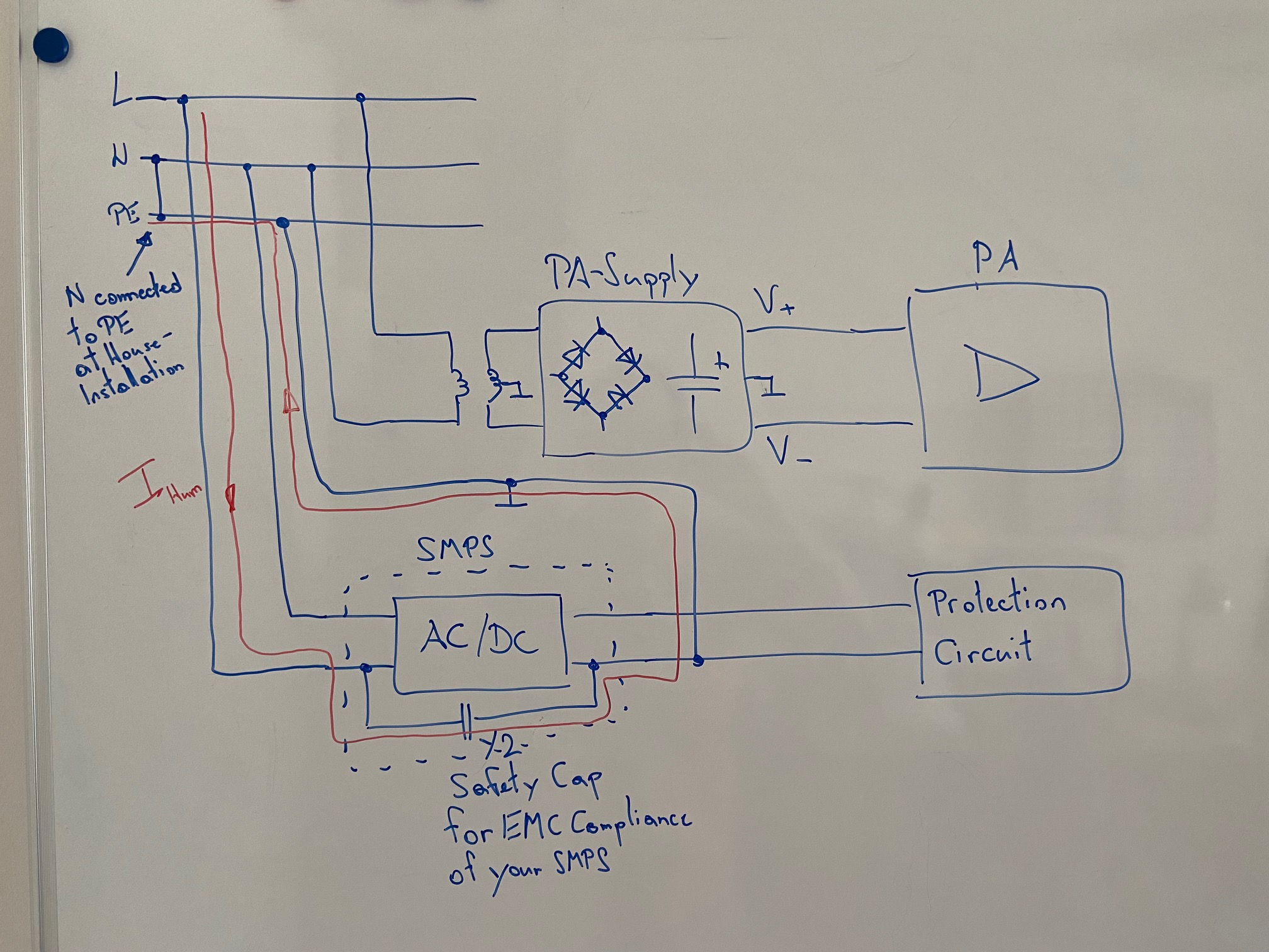

The Y2-capacitor is used to route unwanted RF disturbances from the secondary side of a SMPS to Earth. If the input of your SMPS has a PE connection, then this capacitors connects the secondary ground to PE on the primary side. If the SPMS has no PE input, the Y2 cap only be connected to on of the mains input lines. Thats OK from an RF point of view, because line impedance to Earth is low enough in the RF range. Because this capacitor is crossing the isolation barrier it has to fullfill special safety requirements.
Almost every SMPS will include such a capacitor.
Assuming you have used a small SMPS without an PE input, the Y2 cap now either be effectively connected to L or N of your mains input. It simply depends how you have connected your mains plug to the wall socket. N and PE is connected together at your house installation. So if unfortunately the Y2 cap is connected to L, a capacitive current is flowing from L over the cap to the ground of your amplifier and because (your mentioned that) your ground is connected to PE it can flow to PE. Along the way your signal circuits can pick up this current either galavanic or inductive. Your can simply prove my assumption, when you reverse the mains plug in the wall socket.
The attached picture should help understanding.
Ok, this is now much more clear with your drawing. I do not see a cap for this role around the SMPS. Shall this be inside of it? It is a small 3W SMPS only, without PE connection
Cannot do that due to plugs. Will try later, by rewiring L+N wires of the SMPS, to listen for any difference.
Won't that produce a constant noise as a permanent current will flow from L to PE, via Y2 cap? Maybe Y2 cap is too small for this.

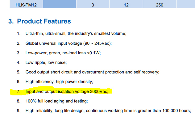

Yes indeed, the current should not be that much. But I would simply try it, to rule it out. I already had a few strange experiences with Y caps. The first one was 25 years ago, when I fumbled on the backside of aVCR in search for IEC antenna connector and noticed, that there was some "electrostimulation" of my right forefinger. If the Y cap is OK, it should not be more than 0.5mA, so I guess you would have to pass a very sensible point of your circuit.

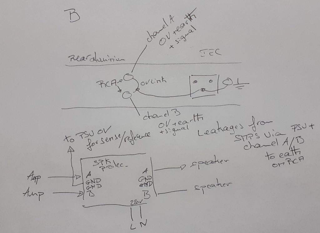

Currently, I'm working with live mains and earth, I'm used to... and know how to deal with that. Amp chassis plus 0V being earthed.

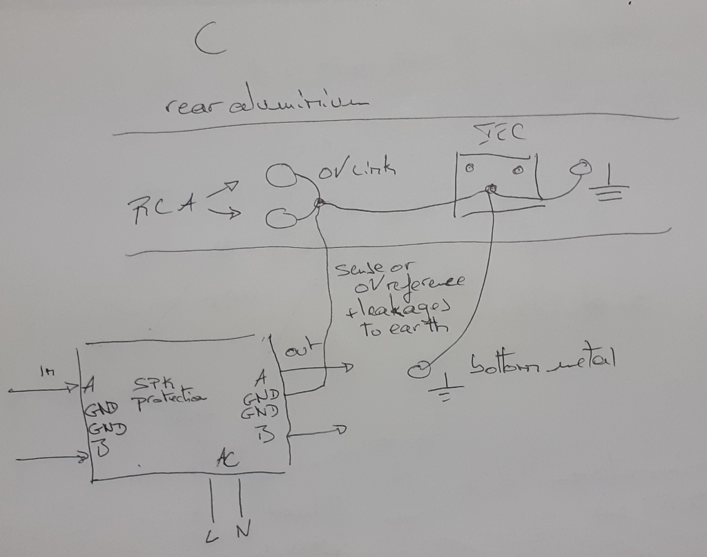

Those are some drawings about wirings, to clarify what I did.
It came with A, ground via chassis frame, screews and paint, spacer. I had found 6 Ohms via my RCA to IEC earth. This made me check and test with the currents flowing from PC and DAC PSU to earth via RCA cable (those currents exist, make crackles if I break or make contacts).
I changed it for B, sure badly assuming this SMPS is perfect, with no leakage to earth. With B wirings, such SMPS currents flow via channels boards 0V traces to earth.
Currently, wiring is B. I thought changing it for C, to avoid SMPS leakages via channel boards.
For better understanding, I will keep B wiring as it could be more sensitive, to further test the L/N swap on the SMPS 220V input. And change this later only.
PS: on the speaker protection board, I have four GND points (same pcb trace). I used only one point, currently linked to PSU 0V, for reference.

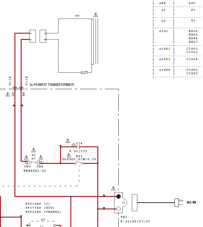

  • I opened the service manual of my other amp, which is quiet since 6 years. Wanted to see how they deal with mains EMI. That is the attached picture: a switch, a fuse. That amp has no SMPS inside, with my wirings described above. On its mains line, I added only a lightning surge protection.

I added again some ground/earth wirings. All noises (RF, pops, clicks) are now gone. Including the pops caused by my fridge motor or my solder iron. All is gone.

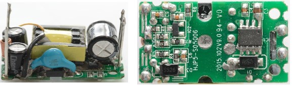

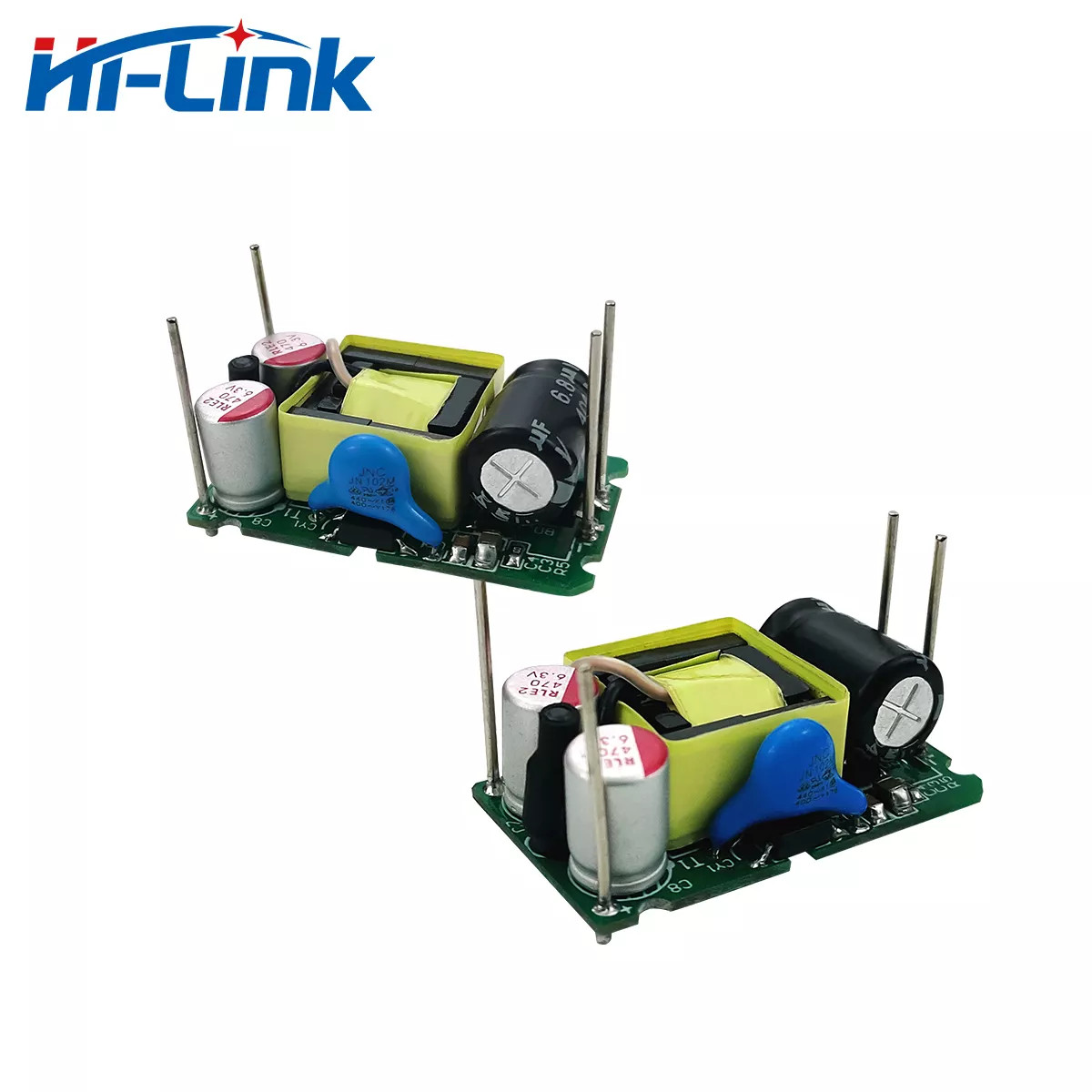

I still don't know if this SMPS has or not a Y2 cap. According to its datasheet and most representations, it has none. As one suggested above in the discussions, It might be like any other low wattage converter you can conect in any way to a socket. But would then produce a small leakage current to earth also.
The only evidence I found is the attached picture. Picture may be off a "pro" or specific version, but I didn't find any such doc.
