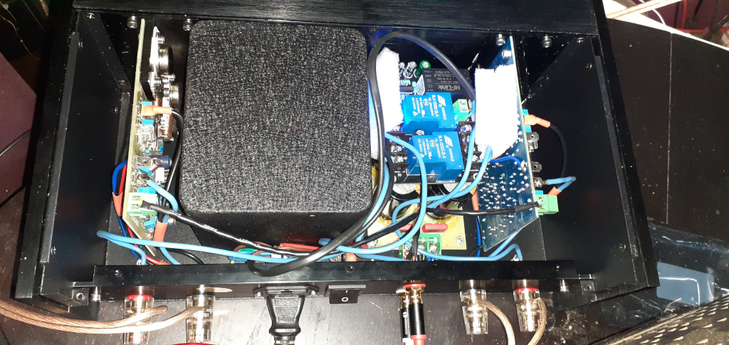

That is the inside, currently dirty.
The speaker protection board (with a switching AC/DC supply) is in place using foam only, top of capacitors bank. That is the mechanical part I will correct, using a metal shield plus spacers.
I once pulled that board and its cablings to the outside, and got less noise... so I rerouted its 220V line.
You will see the 220V line for this board now routed close to the transformer, away from the channel on right side. Routing this 220V line closer to right side input channel caused more of such interference noise...
Amp being a Q405 clone. So, most the time, and for hours, it works very well. And some rare times, I'm getting interferences, sort of superposed hiss or hum, for approx half a second. I did also get some such noises with no audio track playing. Or do hear more often superposed noises on quiet vocals tracks.

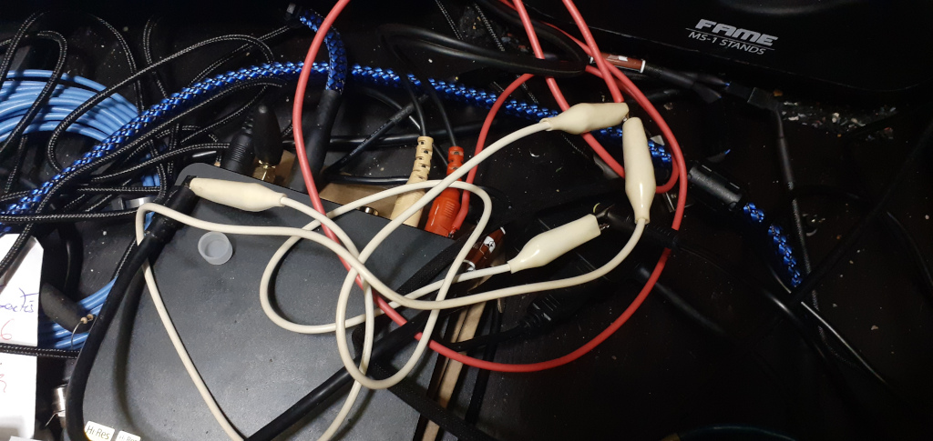

I corrected earthing inside the amp, then added some wires outside the boxes (the red and white ones), they killed a lot of noises.
First I got a loud buzzing system, then heavy hum, finally silence 🙂

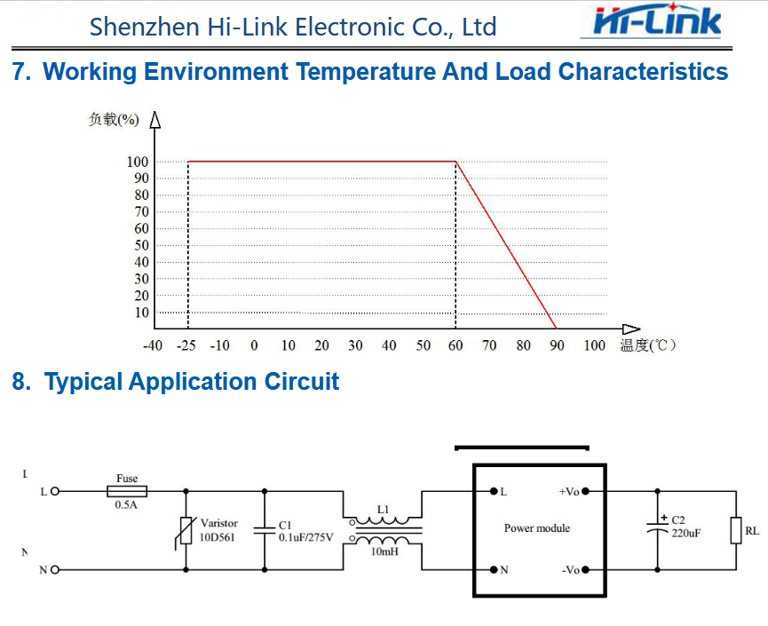

I didn't open the doc of that SMPS. They mention L and N, but later in the doc and on the component, I see only AC and AC... Maybe N faces -Vo.
And I notice now I should add a fuse plus an EMI filter (usually ommited on such kits) for comformance. I'll think about it.
