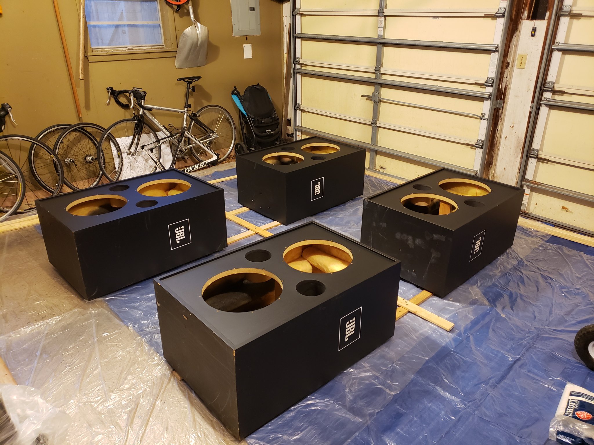

New project. I'm working on adding these JBL cinema speakers to the setup.
I also have two JBL 2445J compression drivers with horns that I plan to add to the system as well. That's longer term though. I'm out of channels of DSP as it is.

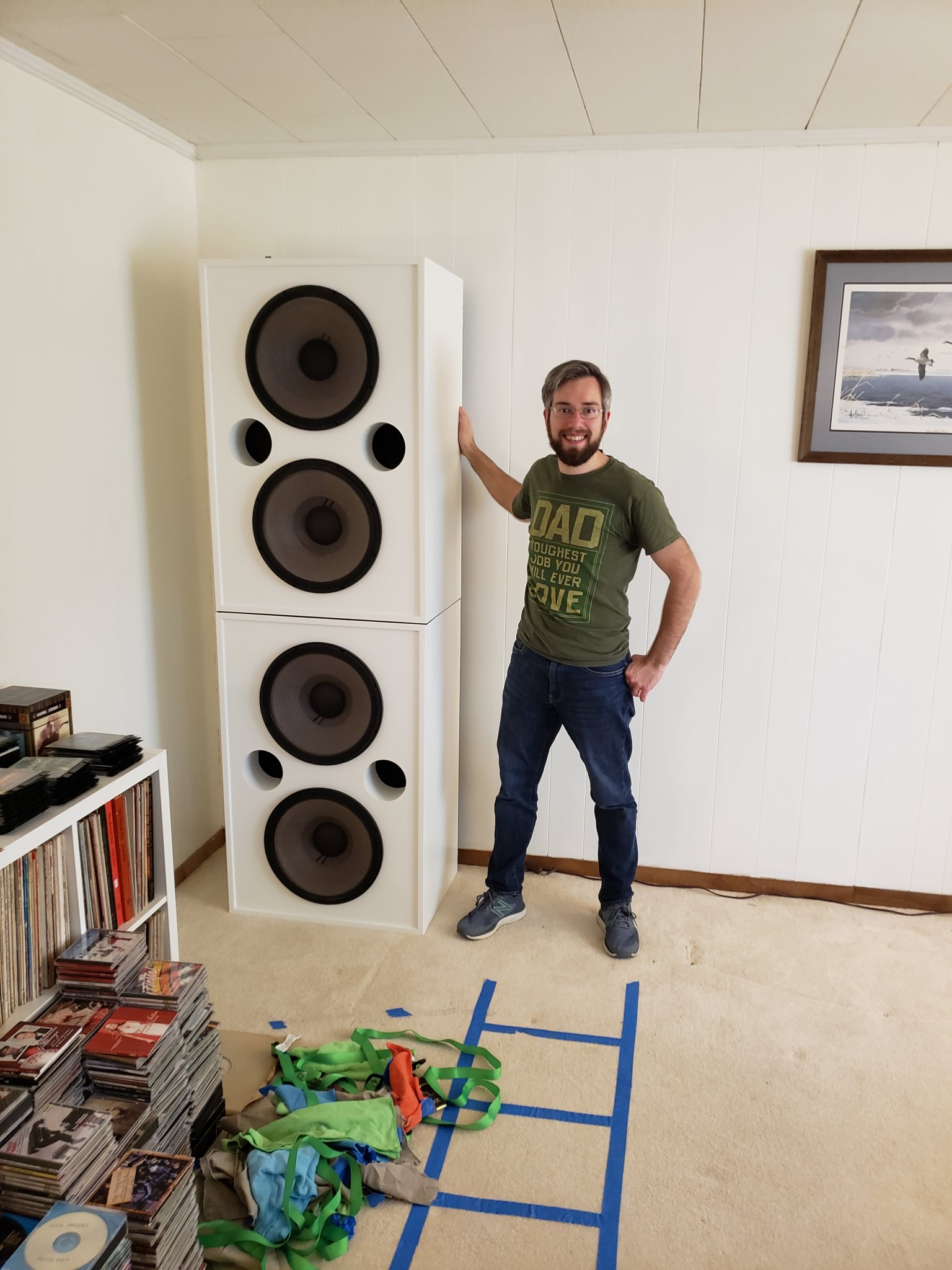

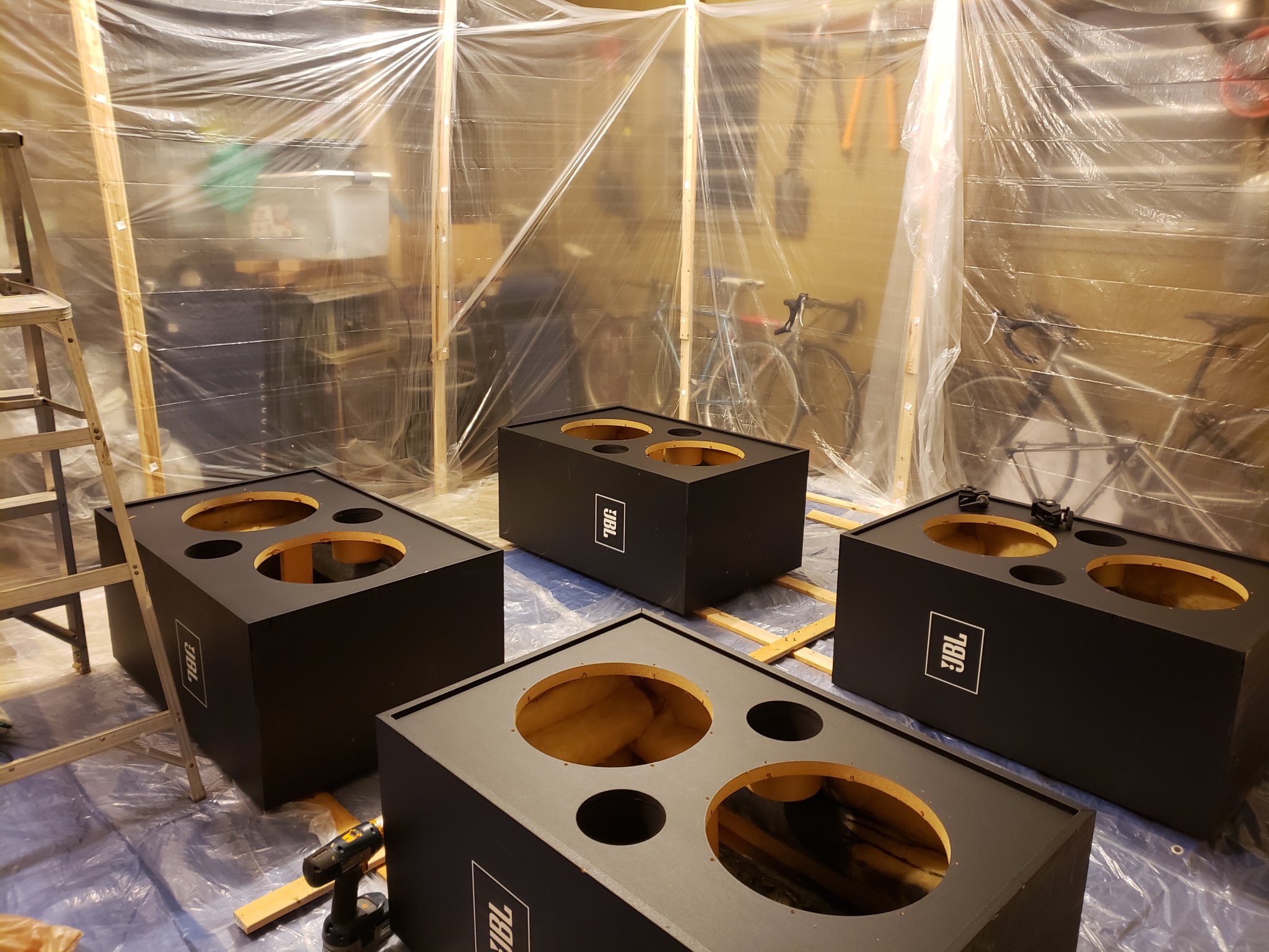

Before I add the 15" cabinets to my system, I want to refinish them in white.
Do any of you have experience painting over vinyl?

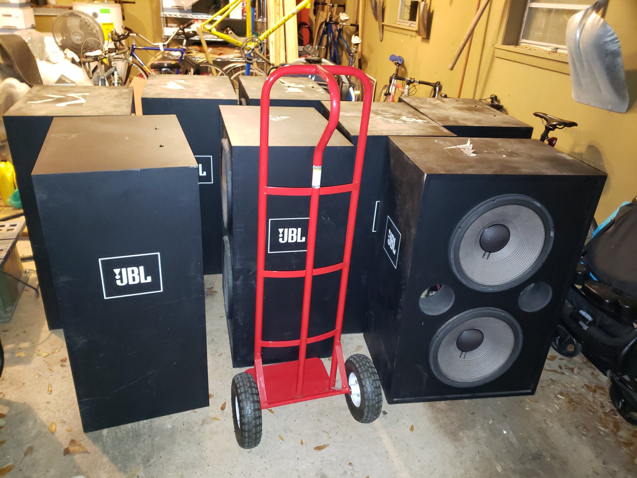

Someone had bought out all the speakers from a movie theater that went out of business. They were selling them out of a warehouse. It was a full day of driving to get them.
