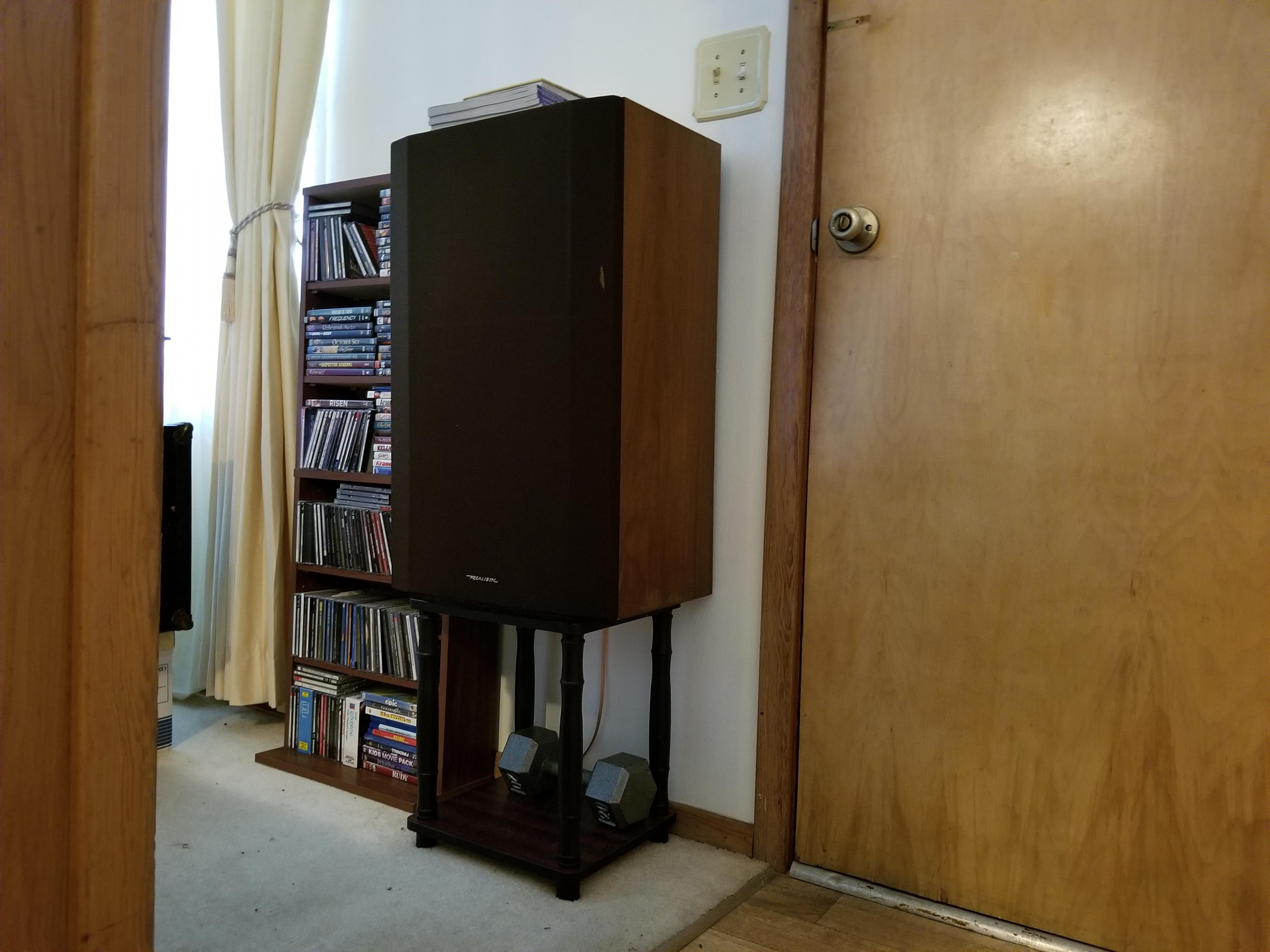

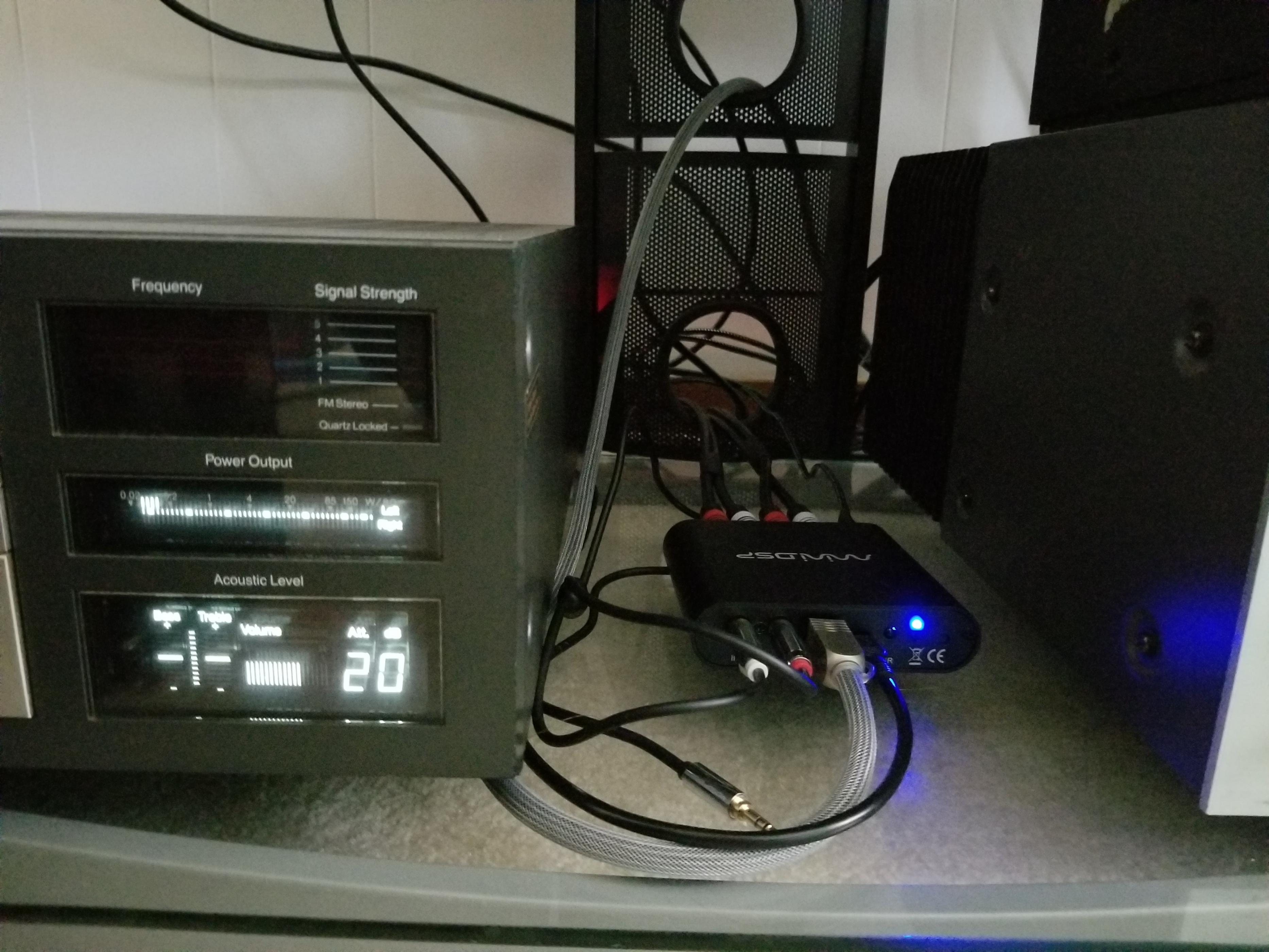

Really loving the miniDSP! It still had two spare RCA outputs which could be used for subs. I has a pair of Realistic Mach 2's that I was using with the line arrays as rear speakers before I got the miniDSP ...greatest rear speakers ever by the way 🙂
I decided to run them as very low powered subs to augment the line arrays deep bottom end. I created a sub eq for them in REW to taste. I have them barely doing anything but the line arrays are doing everything I wanted them to. Its along the idea of having multiple subs. Its sounding good so far!

Yes, I'm using the miniDSP 2x4 HD (with Dirac) as a "crossover." Normally you would use the hi pass filter with a tweeter. I am using it unconventionally to save my drivers of unnecessary excursion at low frequencies. I had content before going down well below 17hz. I did notice it's absence after I set the 25hz hi pass filter, but the slightly improved dynamics was worth it.
