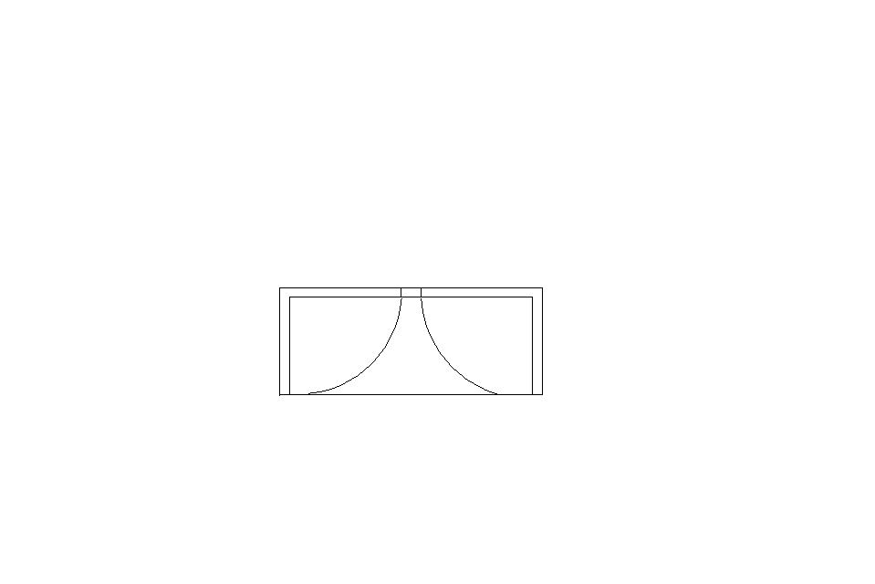

From a production point of wiev, Gedlees foam waveguide cast directly on the baffle is brilliant, it really is...it costs next to nothing and takes very little effort to make and easy to finish
Once tucked away in a well sounding nicely finished product, noone cares about the inside
Looking solely on the waveguide as a single unit things turn out slightly different
Glassfiber would be preferred, but cost is higher as it takes a lot more effort to produce...luckily that doesnt matter in DIY

With Earls foam waveguide I see no way arround the additional mounting plate
Its only brilliant from a production point of wiev, as I see it
But there could be something to it
Make a solid waveguide of plaster upon a plate
Mount the plate upon a squared box
Fill the box with that foam stuff, and you have your waveguide

I would prefer to leave the cast waveguide inside the wooden box, to place upon the midbass box
It should be possible to have pinbolts or something mounted on the rear, so that an additional mountingplate can be avoided
Throat hole could be made fairly accurately in wood
How about a nice big nice elliptical one
