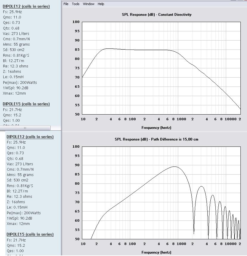

Who I assume is from AE Speakers has suggested I go for the Diploe15's Acoustic Elegance • View topic - Dipole10, Dipole12, Dipole15 parameters
they are not as efficent as I was looking for, but if I'm going active & it looks like I am, a single pair of these may be the way to go. Only need to buy two, only need to ship two.
What do you think?
John_E_Janowitz
What do you think?
John_E_Janowitz
What do you think?

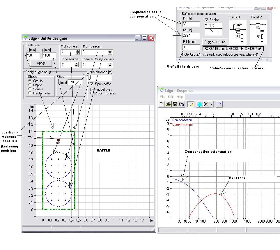

1X 12" is 16ohm parralel a other makes 8ohm. Simulation (0,5W) show very poor efficiency, this means problems with matching with mid and high efficiency in a passive configuration. When you parallel two ad 6dB to efficiency.
With 1W it is 70dB at 40Hz with two driver at a side it is very nice.

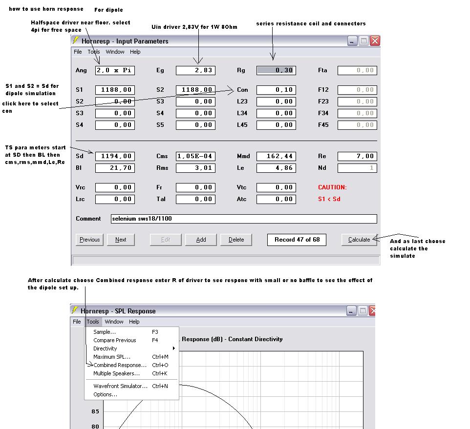

How to use horn response for OB. It is a great tool fast and easy thanks to David J mcBean.
At combined response with R I mean half diameter of the used driver. Or more if the distance from front to back is bigger.
The series resistance can also be the Re of the driver witch is in series with your simulated driver.

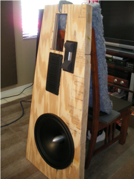

I'm using a single Dipole 15 per side in these and am having no output shortage yet. Eq'ing them flat to 30Hz and then a rolloff below to prevent excessive excursion.

Forgot to add, mine have the dual 8 Ohm coils and I am running them in parallel off of my Digmoda 552.
