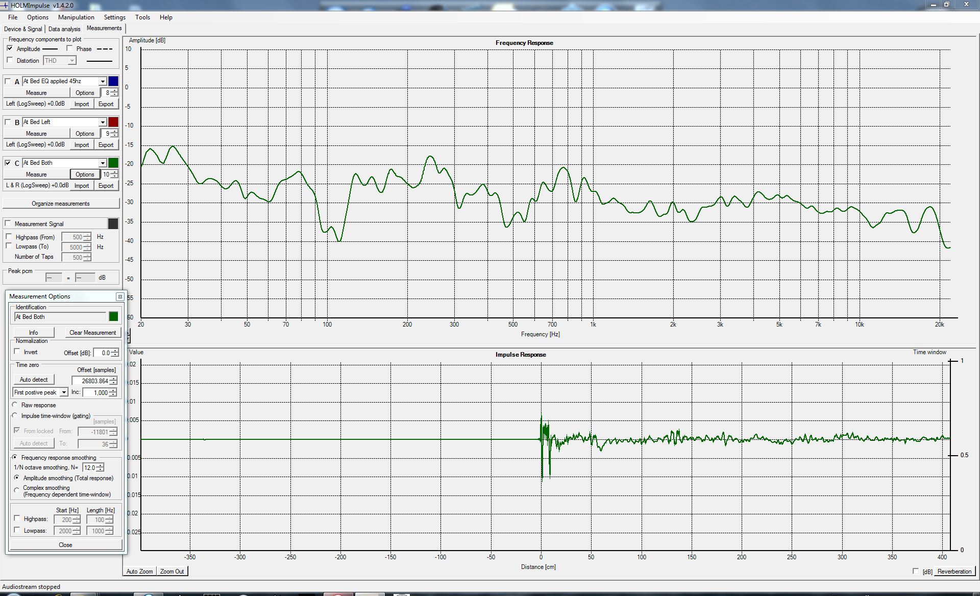

Boy did I get a surprise, but first some background.
I have been playing around with the crossover & EQ for a couple of days but was never really happy with the level of the high mids & highs, too much of both. I had basically been doing the measuring with one speaker, in the measuring position, in the middle of the room. then moving it back & listening in the listening position.
Yesterday the ex came over & I played the fourth Movement of William Russo's Street Music, Gondwanaland "Emu" & some Eva Cassidy to her & she was blown away, couldn't believe how good they sounded, but I wasn't happy, mids & high's you know.
I spent some more time trying to tame the mids & highs, then set them up for a listen when I went to bed, well I lasted about 10 minutes & turned them off in disgust.
Today I though I would follow Helmuth advice & measure from the listening position, WELL, my reasonably flat line had turned into a mountain range.
In the graphs below I show the: all measurements 1/12 Smoothed
I know it still looks like a mountain range, but that's more to do with the room etc. I tried to play with the major humps & hollows but it was like trying to move a mountain & in the end I didn't think things where going to get much better with EQ.
All through this, I will say, the speakers have a sound stage that seems to extend past there width, the musicians are well positioned, you can follow the pianist up & down the keyboard (to some degree), you can tell who's in the front & who's in the back & the harmonica that Corky Seigel plays in Street music put chills down my spine.
I will listen some more tonight I'm sure I'm not there yet. Oh yes the mid,s & high's have been tamed.
David

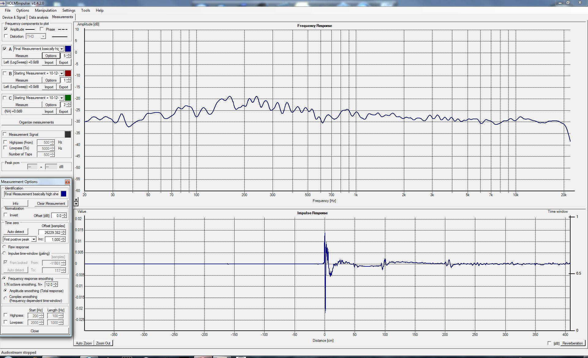

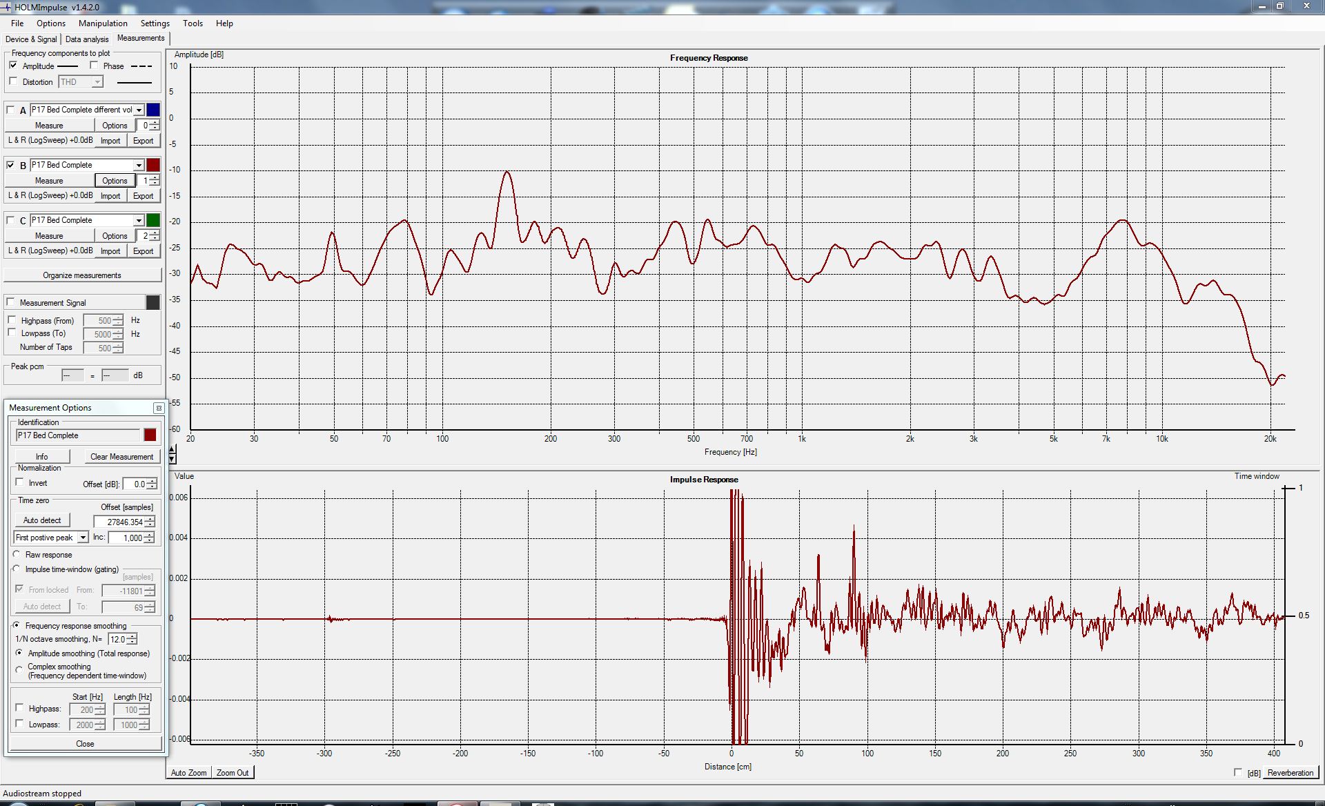

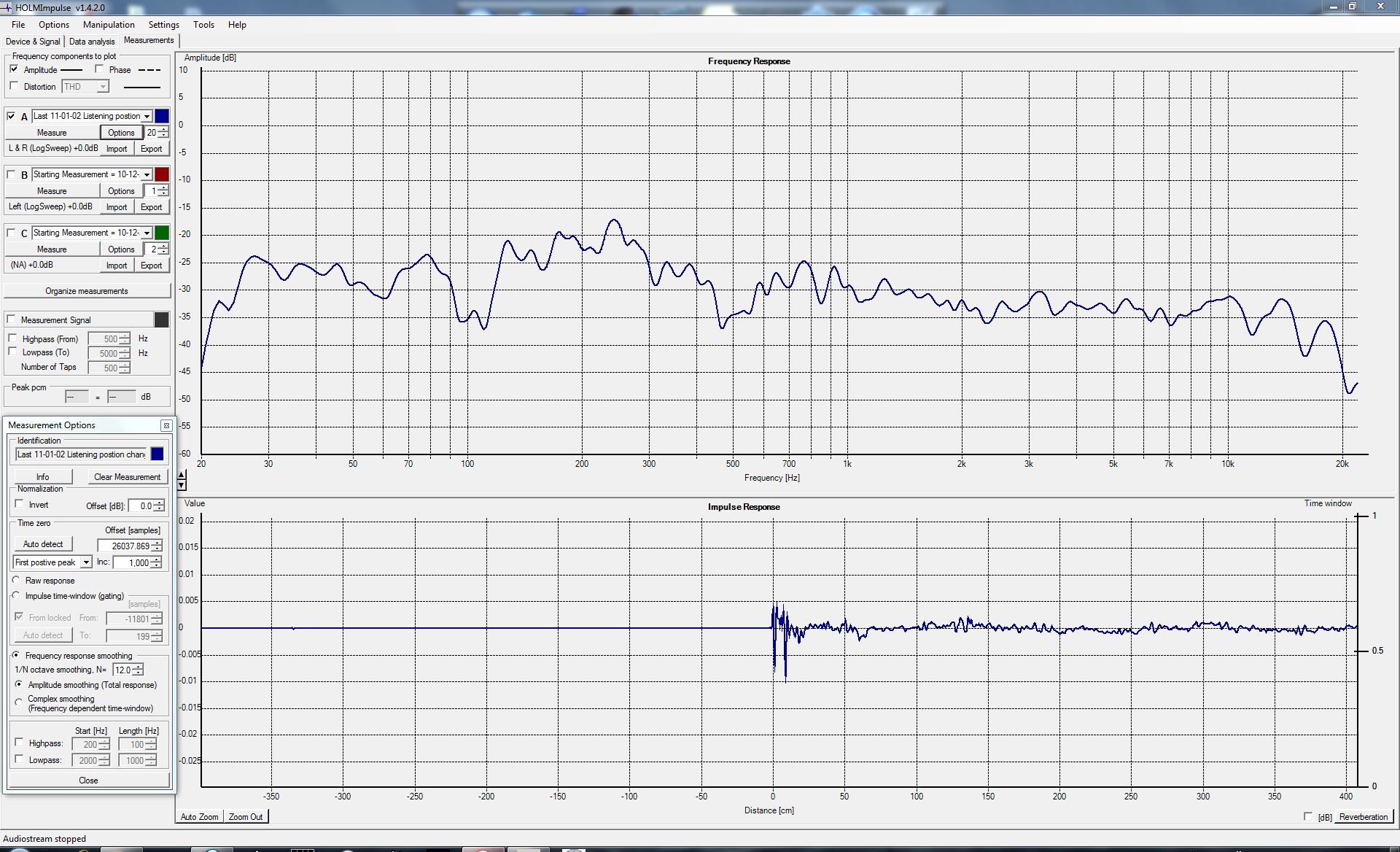

- P17 in listening position, this measurement was taken some time ago & remember these are the speakers I like so much. (My Original Speakers)
- The final EQ done in the measuring position, one speaker
- The final EQ measured in the listening position, both speakers
- The last adjustment,

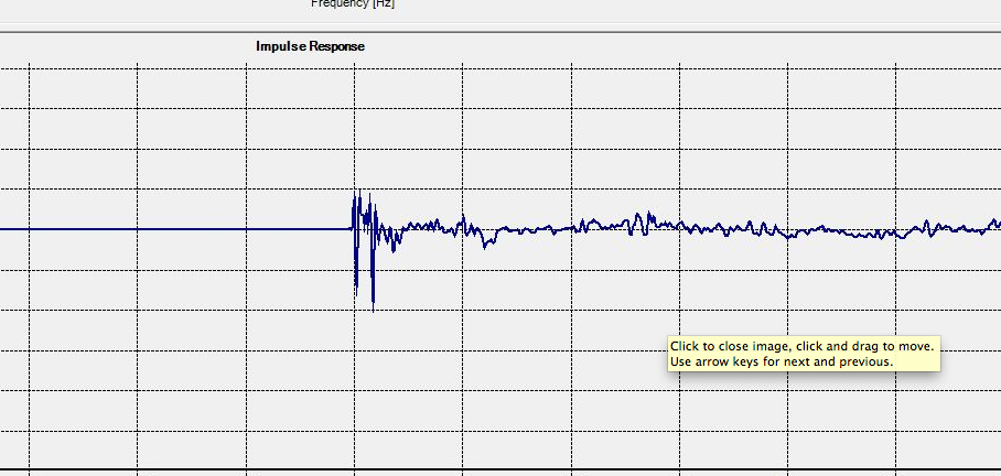

Good to hear it begins to work for you may be you self begin to play-in with the new speakers.😀
But I can see at the impulse response your two channel measurements can be better. On the impulse response you can see both speakers weren't at the same distance from the microphone.
This difference is about 10 msec in your graphic. So the path difference from speaker to microphone is about 3meter. Both impulse responses shout lay over each other it will take some measurements to tune to positions till it is precise right. But you can see at the impulse response you are coming close. And you can use a cord of the same length from mic to speaker 1 and 2.
Look at the attachment you see two impulse responses. These shout be laying over each other. There for you need to position the speaker with in half a centimeter to measure the good value.
(3,5cm is 10kHz 1,5cm is 20kHz) so 0,75cm difference is opposite phase of the 20khz

I'm happy to report that the graph is in cm not msec 🙂, one of them would have been outside or in the next room if they where 3m out, so it's about 10cm, which I can understand. I have learn something, again thanks, will try the adjustment tomorrow.

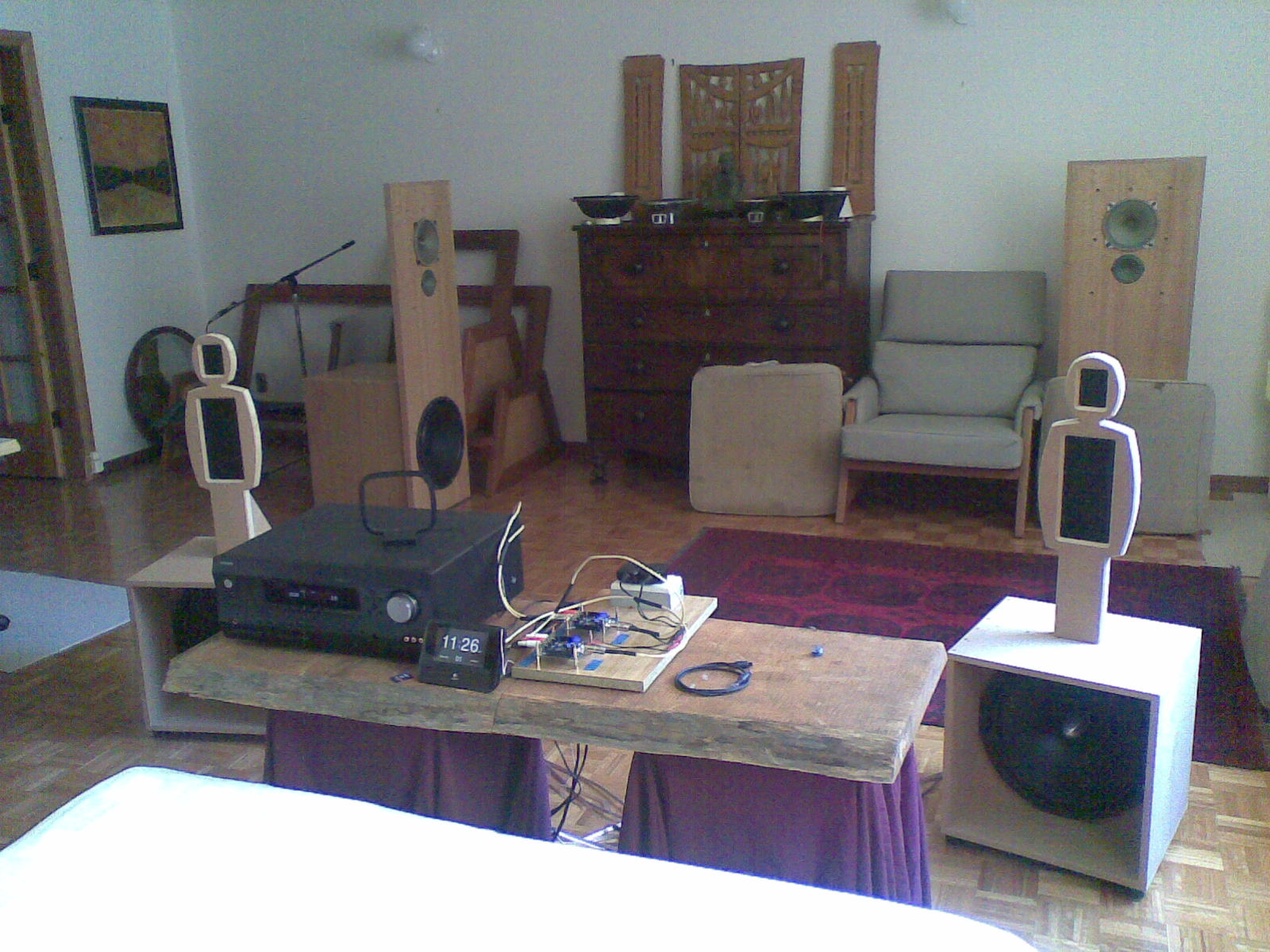

Congratulations on a very interesting speaker project! I've just read your thread end to end and I see you've learnt a great deal in doing this project.
I found with my open baffles that a flat response is quite undesirable and unpleasant. A drooping response starting highest in the midbass and quietest at about 5khz seems to be best (above there I think it's less important as there's v little fundamental musical info so high up).
It's a shame I didn't see your thread earlier, as I'd have happily given my opinions on how much bass is enough. For me, a passive 3 way system using 2 x 12" woofers (v cheap and low Xmax, mid-Q) has stunning bass at 40hz. I don't know if my tiny room is a plus or a problem, it just works!
Anyway, great thread and please do keep us informed of any further progressions in this design.
Simon

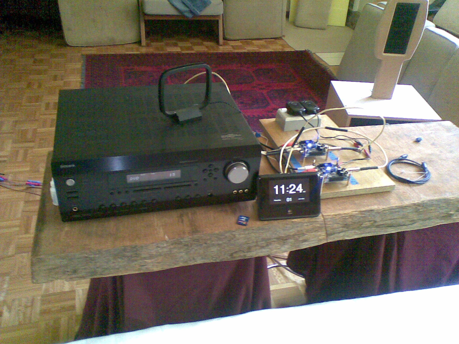

I think for the moment I am happy.
My Coldamp modules should arrive in the coming weeks, so that will be my next adventure. Almost forgot, I need to put the MiniDSP in a case of some sort as well.
Then I will need to start looking at building the final version of the speakers.

Linkwitz got good gains decoupling the Seas Excel mid from his Orion baffle. That design offers good inspiration, though it's a conventional-shaped driver.
What material are you making your final baffles from?
The baffles, what there is of them, will probably be made of Tasmanian Blackwood Rich Tasmanian Blackwood Or possibly something harder, not sure yet.
The "H" frame will be made of 25'' MDF.
