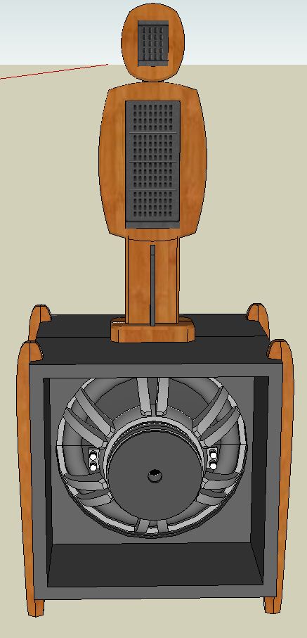

I would also highly recommend keeping the mid and tweeter as close as possible
I have noticed that in a lot of designs the tweeter/mid are close together, but I have not worked out why?

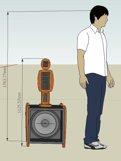

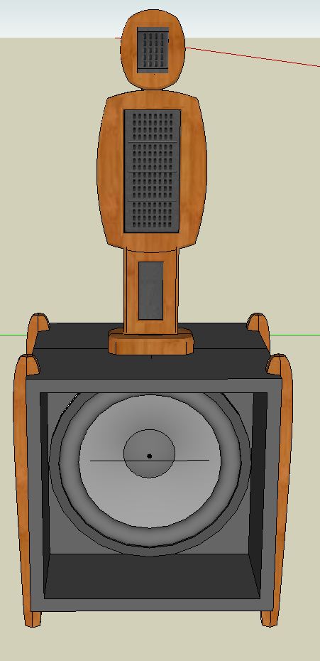

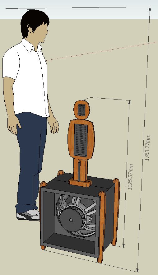

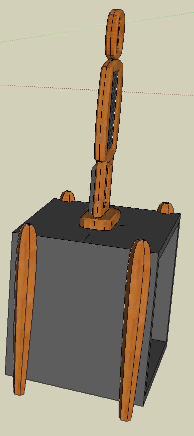

Time To Stop Designing
It's time to start the prototype. The final design has numerous structural challenges that in the end could force a change, there is only one way to find out.
Hopefully I'll get time to start in the week before Christmas.

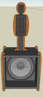

wow, it almost look like someone standing on top of your sub 🙂
Yes, that wasn't the plan but it's growing on me🙂

To minimize lobing of the off axis response. The farther apart the drivers are the more lobing you may have in the off axis response. I think the rule of thumb is to keep driver centers maximum of 1 wavelength but closer is obviously better.
Also, have you considered the potential horn loading effect of the recessed driver in your baffle? I would think you may be better to minimize the depth of your baffle to minimize any potential horn loading effect.

Thank you for the explanation, you say 1 wavelength, I assume that is 1 wavelength at the crossover frequency?
I have no knowledge of what horn loading effect is but will do some research, but as I say for the moment the design is set & I will see (hear) how the prototype goes.
Recommended research method: Cup your hands around your mouth in a horn shape and shout... it can/will be louder than without the "Horn". The longer the horn, the more the gain. 😛

That is the great part about prototyping; you can easily modify. Quick and dirty tests can provide great value. 😀
- as a preliminary test, before you actually mount the drivers in your baffle, you could simply just try hanging the drivers with stings to minimize/eliminate baffle altogether.
- Flush mount the drivers (I.e use the thing facing the opposite direction as you have illustrated in your diagram)
- At the very least I think you could benefit by using a thinner baffle material and/or sandwich the driver in between 2 identical wood baffles may help to minimize horn loading effect on both sides.
- alternatively, at least use a large radius... I suspect a flat 45degree angle of horn would be worst because sound would reflect directly forward to the listener. Rounded or greater than 60degress angle may be better options.
hope this helps.

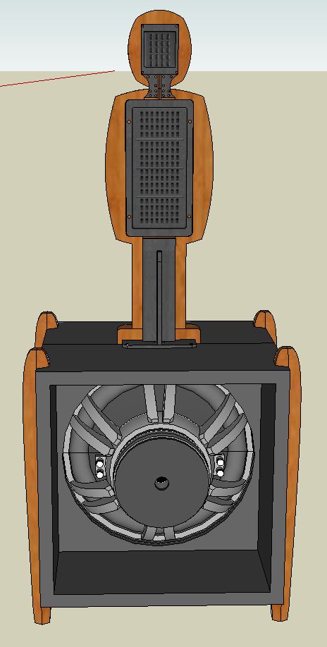

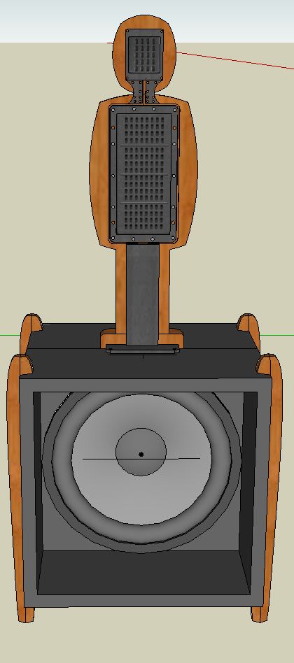

The drivers are sandwiched between two identical pieces of wood. Possibly the drawings have been misinterpreted. I have shown them with the driver in place but the back section of the baffle removed. I have drawn it in two sections as that is the way I will build it.
David
David
I figured that might be the case but I couldn't tell for sure.
I'm curious why you would not just have both drivers in the same "sandwich" instead of stacking two separate sandwiches?
Anyways, I'm sure you will have nice results.... however it could be very difficult to tell the difference between alternate configurations without good measurement tools. Did you manage to get some?

It's just the way the design evolved really.

One thing I have been pondering on is the alignment of the Bass driver in the H frame.
All the things I have read basically indicate that the centre panel is positioned centrally in the length of the H frame, in my case that will leave 187mm each side of the centre panel.
What that will obviously do is position the base of the cone, much closer to the back of the H frame than the front.
I was wondering if perhaps the centre panel should be moved forward to get the base of the cone closer to the centre.
I am not thinking this should be done for driver alignment as I will be able to align the drivers with the DSP. I was just wondering if I would end up with a more balanced sound front & rear.
Any thoughts?

You are right in bringing this problem up. But in my experience the solution is easier than the problem 🙂. A cone driver has two ACs - one for front and one for back. Often the AC for the back is located near or even in front of the front AC. If you mount the driver from the front of the centre panel, you should have the center between both ACs near enough to the panel.

I think DQ828 is asking about placement of the woofer in the H-frame instead of the vertical alignment of all the drivers? If yes then....
AC = acoustic center of the driver. MJK refers to where the woofer is located as "the fraction of the length of the front cavity" in his OB worksheets. I recall MJK writing at one point (but don't remember where) that the driver should be moved forward in the H-frame slightly so it's AC is in the middle of the H-frame (but that if the driver is a little too far forward or too far back wouldn't make much difference in the response).
I know that the AC would be somewhere between the dustcap and the surround but have no idea how to work this out. (and its not clear to me how the front AC would be different than the back).

Hi David,
not sure at what frequency you plan the Xo to the sub but typically the wave is so long at that frequency compared to shifting the woofer a few cm back or forth that it will not matter and you won't hear a difference.
Right now I can only think of one way measuring the right position based on the theoretical model (I just made this up, have never tried it practically): Measure the resonance peak close up to the opening at the front and at the back in a defined spot and constant distance and compare the plots. The peaks should be at the same F and of the same magnitude. This shows whether front and back side of the woofer see the same impedance mismatch at the H frame opening. But again, maybe you only want to bother after all the other issues are solved ;-) So put the sub mounting panel in the middle of the H-frame. That brings the sub slightly forward if not flush mounted and what Rudolf describes should become applicable.
