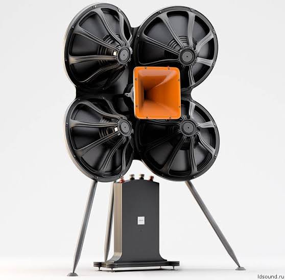

...any of you use a mono OB speaker in your regular system? How do you think it compares to stereo OB or stereo box speakers?
I want to build a speaker similar to Reflector Audio P18 (but with a coax in place of the 2" compression driver). Two of those and the associated active amps and cabling would be unbearable in the living room. But just one is doable 🙂🙂🙂
