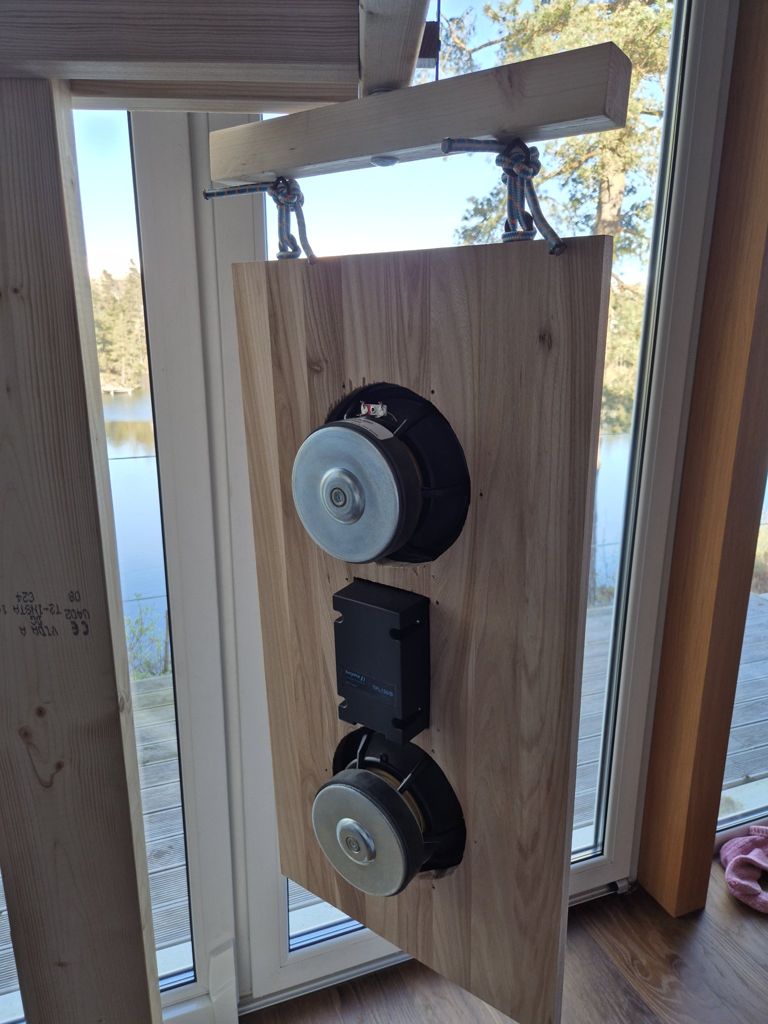

OB + IB = Good?
Beech?
Leave the OB drivers naked is the latest and bestest practice, I've read...
Reactions: Vix and adason

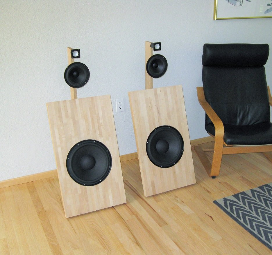

Adding (gluing) some concrete or stone slabs on the back side. Use DG-A2 glue from Angered. A visco elastic glue that converts the vibrations to heat.
QLN, QRS, Response, Renessans, Stridbeck, SJ, me, etc etc uses this glue. Remarkable!!
