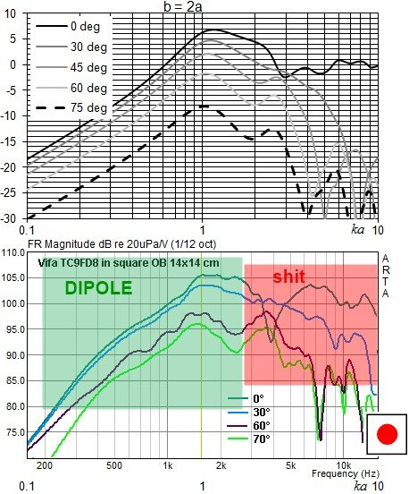

Dsp helps a lot to match spl and on-axis response, but getting reasonably good dispersion depends more on the baffle size and shape.

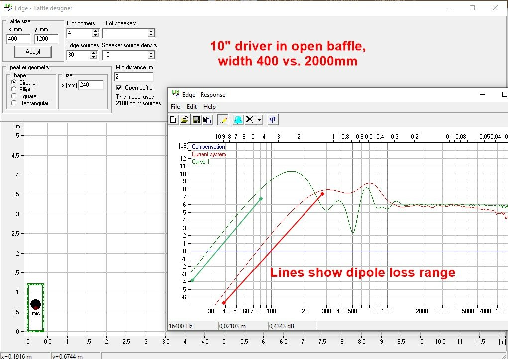

It is a mystery to me how IB and OB will work together... Be ready to use delay for OB signal. And OB distance fom wall/IB creates comb filtering in upper bass-midrange, rotate dipoles inwards to reduce this effect. Late reflections from backside radiation create the "dipole sound"
Basics: https://musicanddesign.speakerdesign.net/tech.html

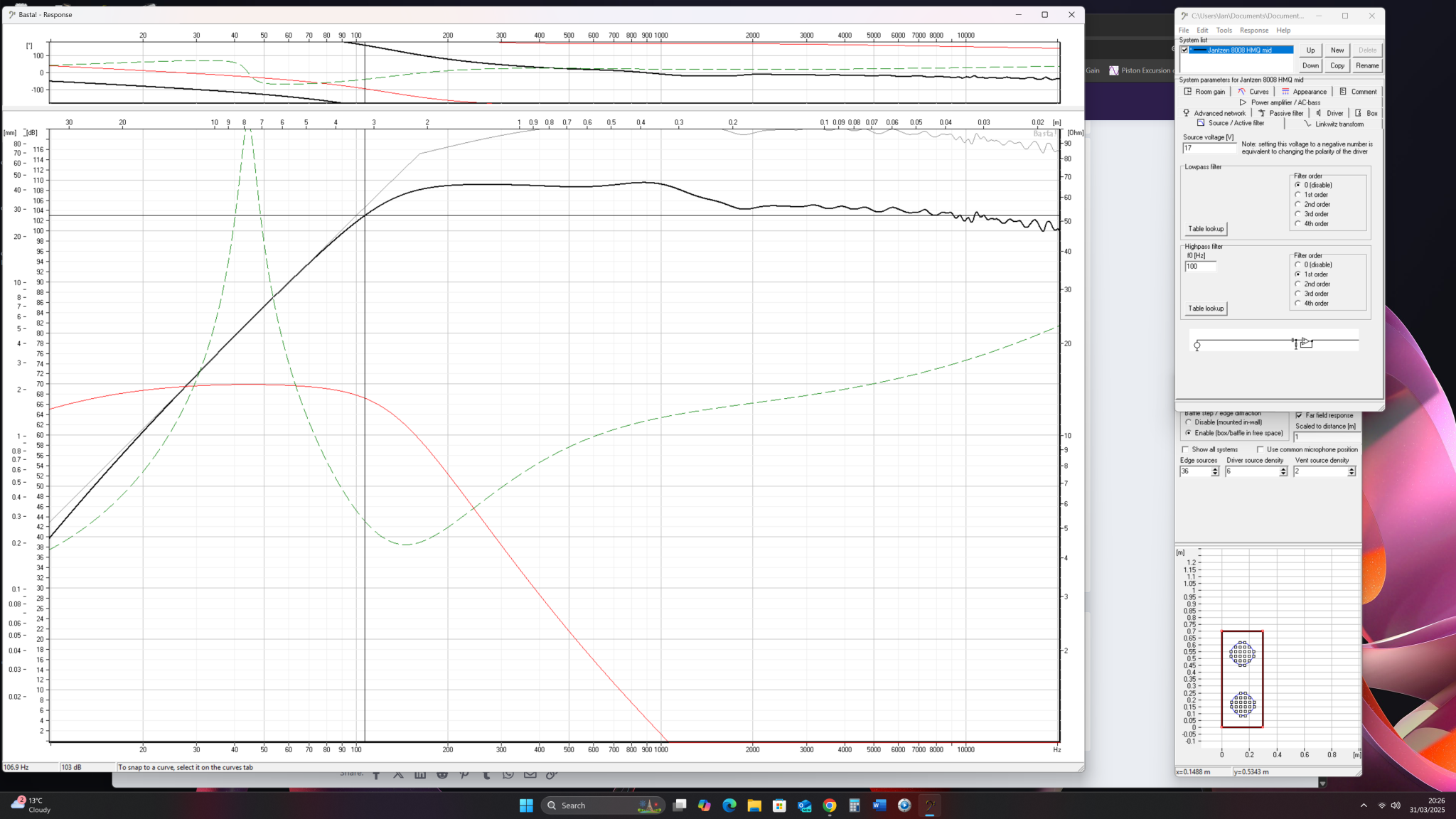

It'll depend just how much output you want, but I'd guess that you could do 100 Hz. Below is a sim in Basta! of a pair of the Jantzen 8 inch drivers on a 300mm by 700mm open baffle. I've set input level as 17 volts, and applied a 1st order active high-pass filter at 100 Hz. (I've also applied a passive network to equalise baffle step - 3mH in parallel with 8 ohms). The -6dB point is about 105 Hz.
This won't be a good guide to the midrange response, but it should be a decent predictor of LF roll-off, and maximum output capability. As you can see, at 17V input you are reaching max output; excursion below the LF crossover is where you reach the limit first. In the passband, you are getting close to 110 dB at 1m. This is plausible to me - after all the Linkwitz LX521 used a single 8" driver with 4mm of linear excursion on a small baffle down to something like 100-120 Hz.
PS. Incase it's not obvious, black is SPL, grey is max SPL, red is excursion, green is impedance. Simulation takes account of TS paraments, baffle shape/size, and active/passive filters applied.

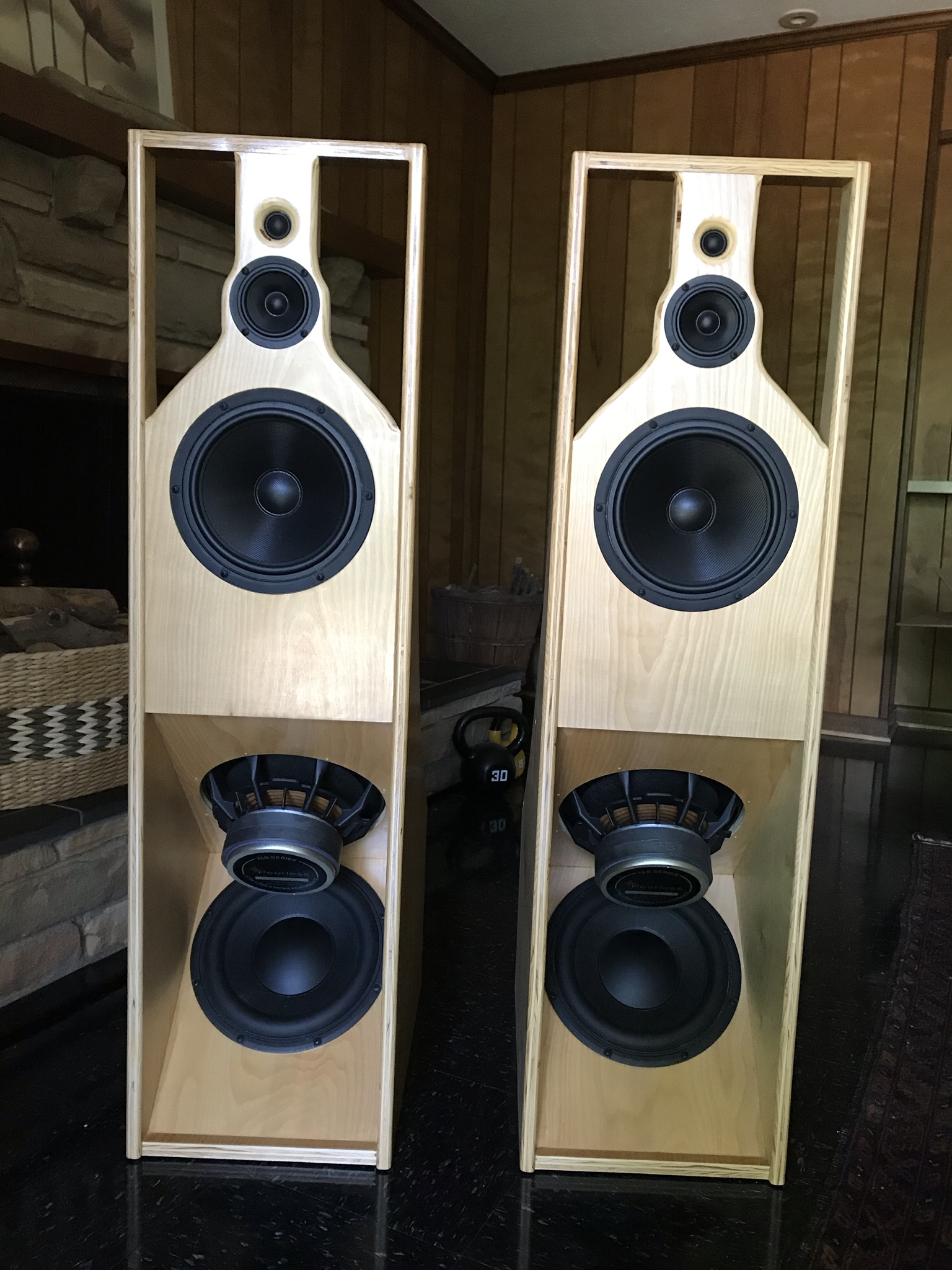

Hourglass?
That would make sense.

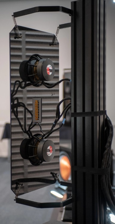

My 4-way dipoles use monopole woofer below 150Hz, single 10" per speaker. 12" low mid, planars for upper mid and tweeter.
https://drive.google.com/file/d/1a44vFKWPlnALozIWkUXtBFl90Haa35JE/view?usp=sharing

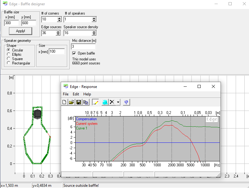

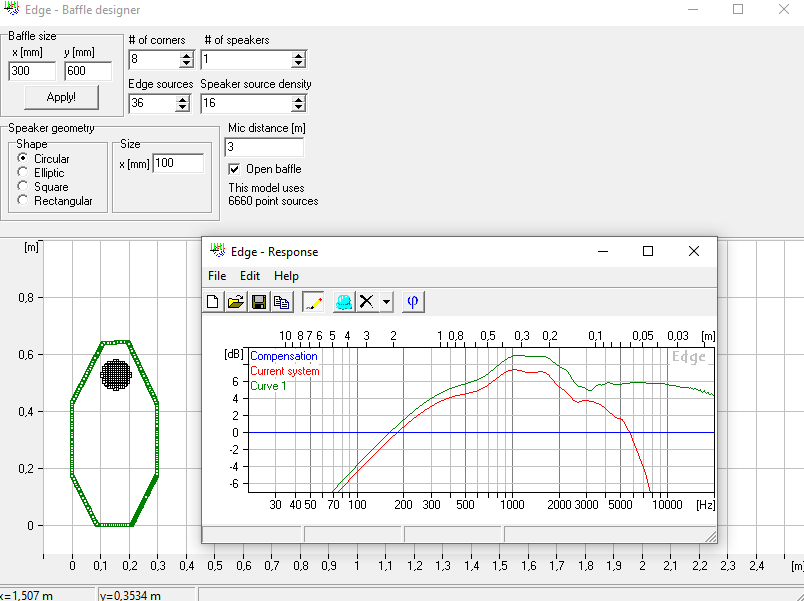

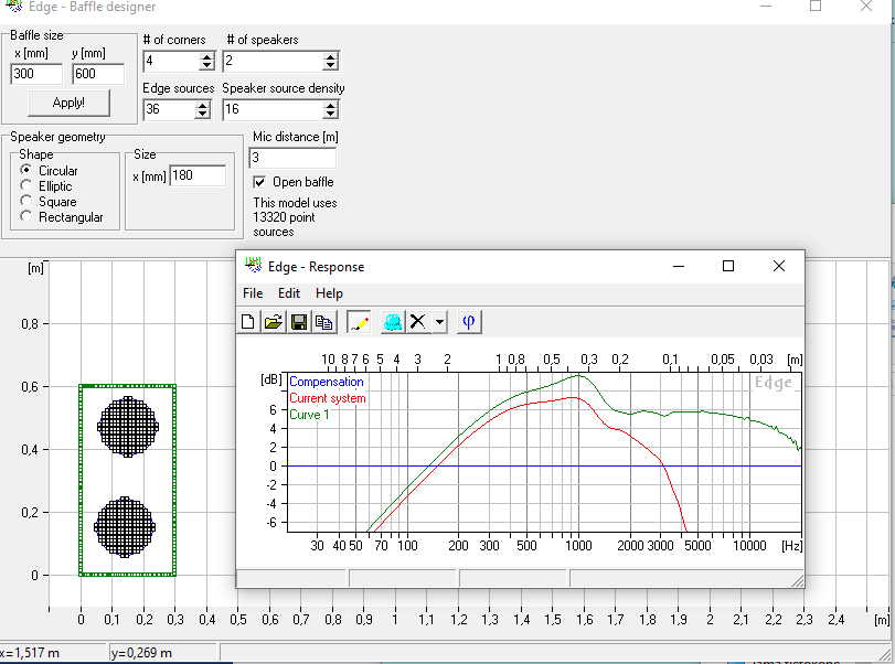

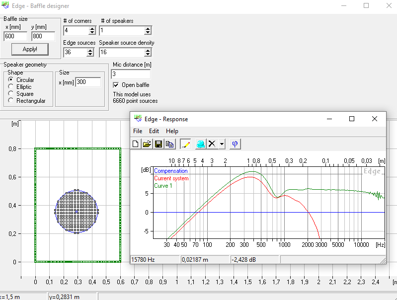

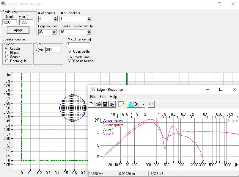

Below some simple Edge sims. Move mouse above the pic to see driver size in inches and baffle in mm. Each pic shows on-axis response and off-axis at roughly 30deg.
Edge uses ideal drivers with flat membrane and flat response, in anechoic environment.

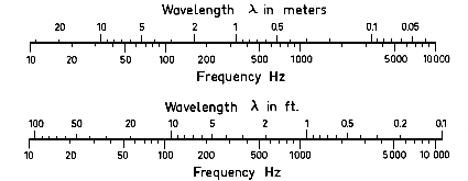

Concept of sound wavelength is crucial! Notice the logarithmic scale!
