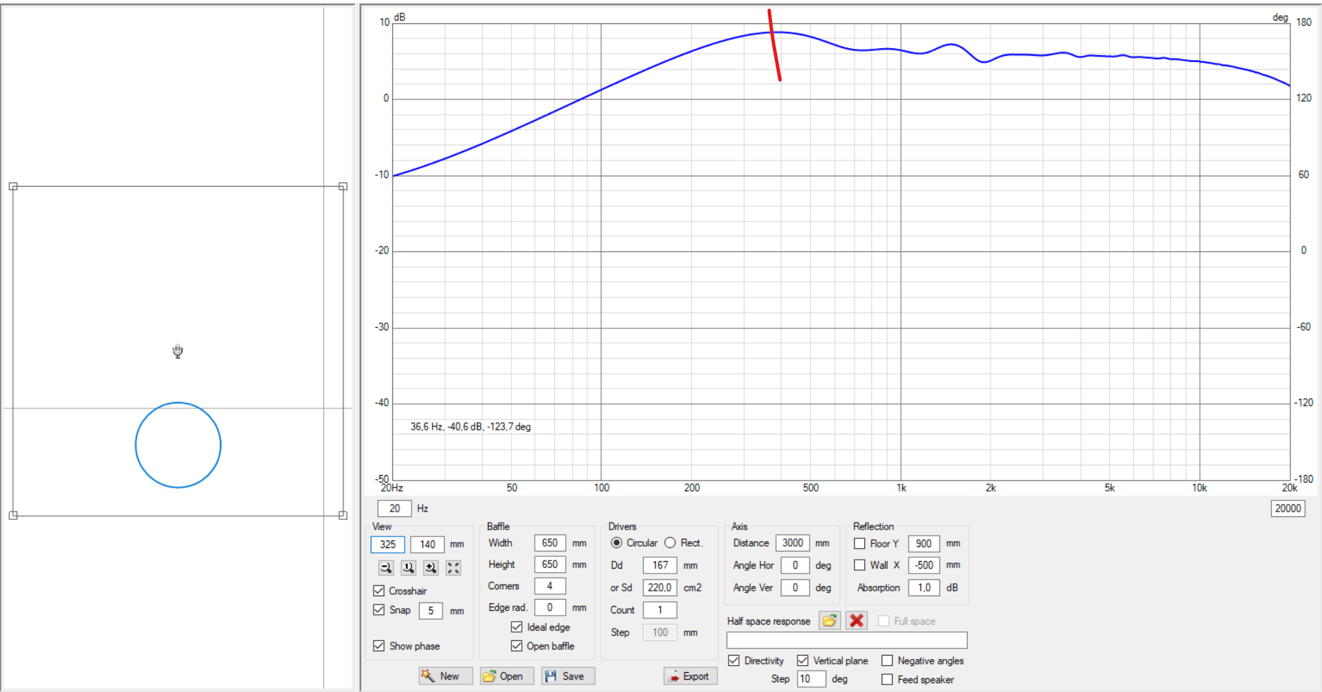

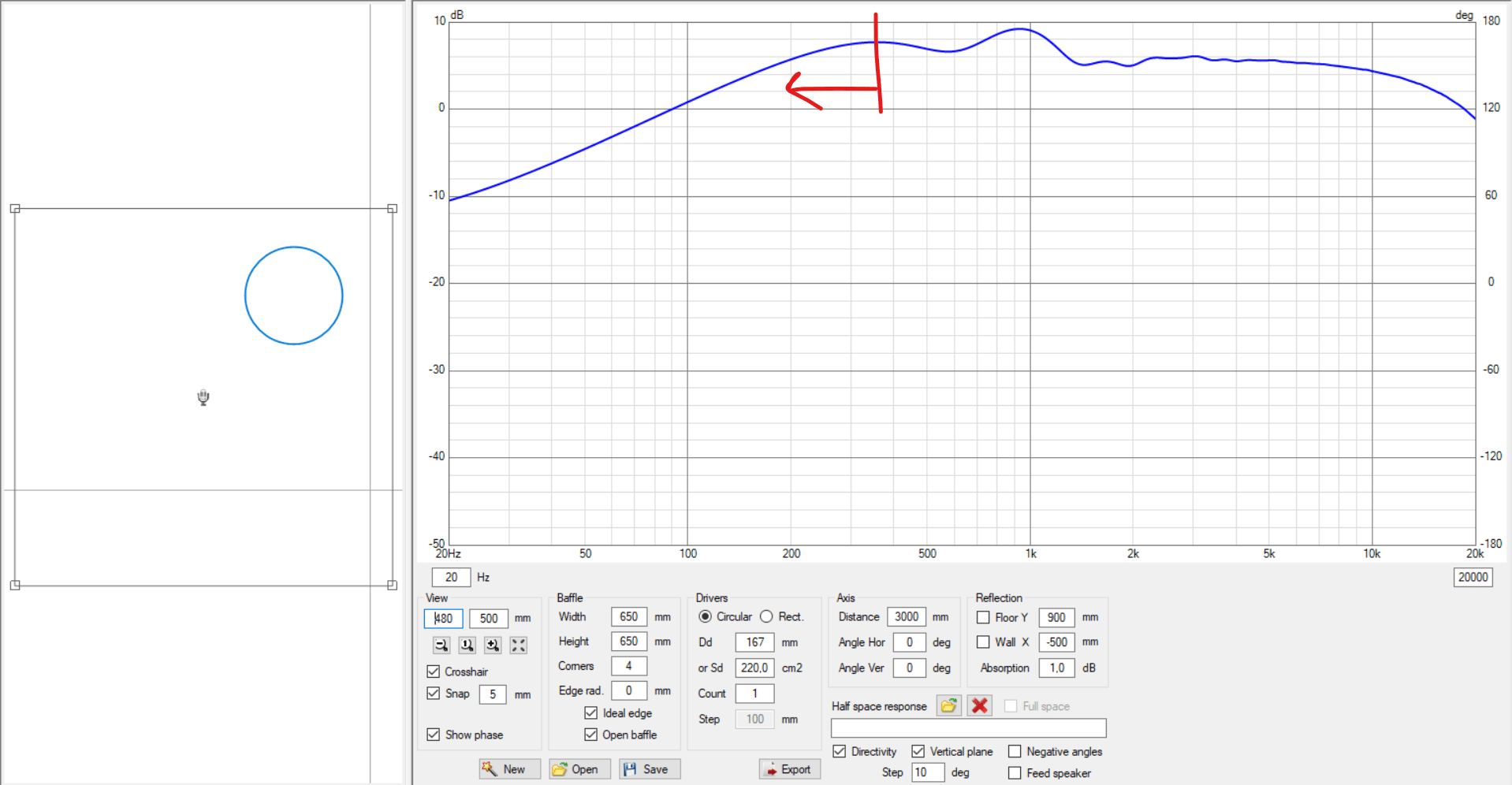

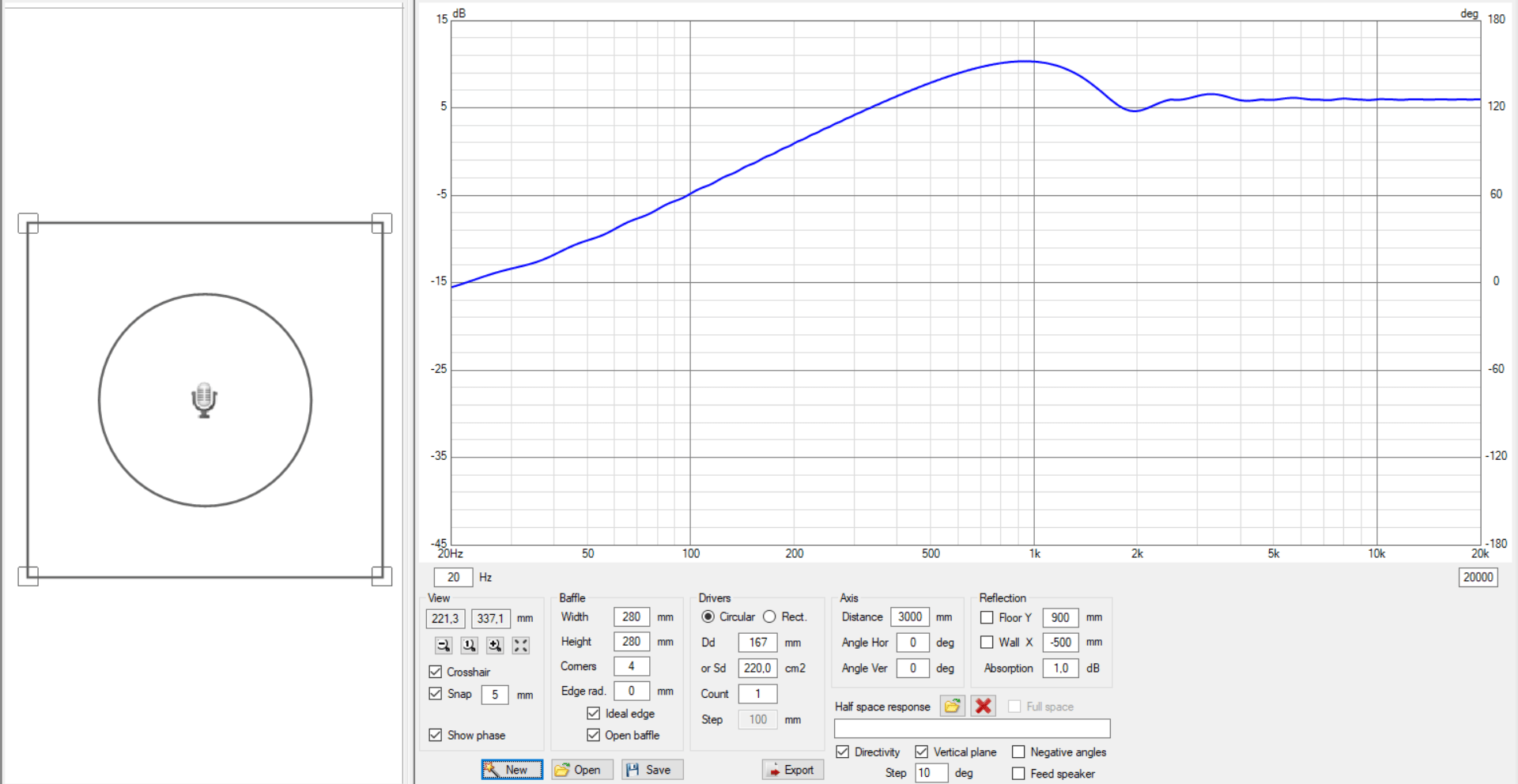

The offset like this can create the flat response but only for on axis. The off-axis frequency response is only as good as narrow baffle at the short side (near driver), but worse on the far side of baffle. Considering that what we hear is both on- amd off-axis sound, I am happy to buy one more smaller midrange and use no baffle rather than try to do this offset trick.
Yes you can do that. The edge radius is difficult though, as the bigger the baffle the bigger the radius must be as it needs to work on lower frequency (longer wavelength), which means the baffle must gain thickness with the size in order to accommodate the needed roundover radius. Same goes with closed box speakers. On boxed speakers there likely is enough thickness to the structure, but open baffle there usually isn't.
Basically, fully effective edge radius must start rounding over immediately beside the transducer, otherwise it is not as big as it is needed for full effect. Any round over is better than nothing, but let's stick to idealized thought experiement. 9cm radius roundover means baffle must be 18cm thick to accommodate it, which makes the dipole pattern break in reality, unless it's donut like baffle so that both sides of the woofer turn into waveguides of similar properties, which they do not as the structure is not symmetric with basket and cone shape and all. Very hard to manufacture. Continuing thought experiment, If we start with big ideal donut shape with big roundovers and perfect response, and start to shrink it also the needed roundovers shrink keeping the effectiveness same (keeping frequency response without direction varying interference), and you can shrink it down to transducer size, which makes the baffle and roundover just disappear, which makes no baffle the cheapest and easiest and cheapest baffle ever. But, it increased the cancellation at some particular low frequency as you've been pointing out, which makes the good bandwidth go up in frequency, so no you'd need another driver to cover the lost bass. But on a multiway system we have multiple drivers, one for bass and one for highs, and perhaps some between so it's matter of juggling things around to make a complete system. Also tthe main diffraction hump would be there, but since DI is flat it can be EQ:d flat.

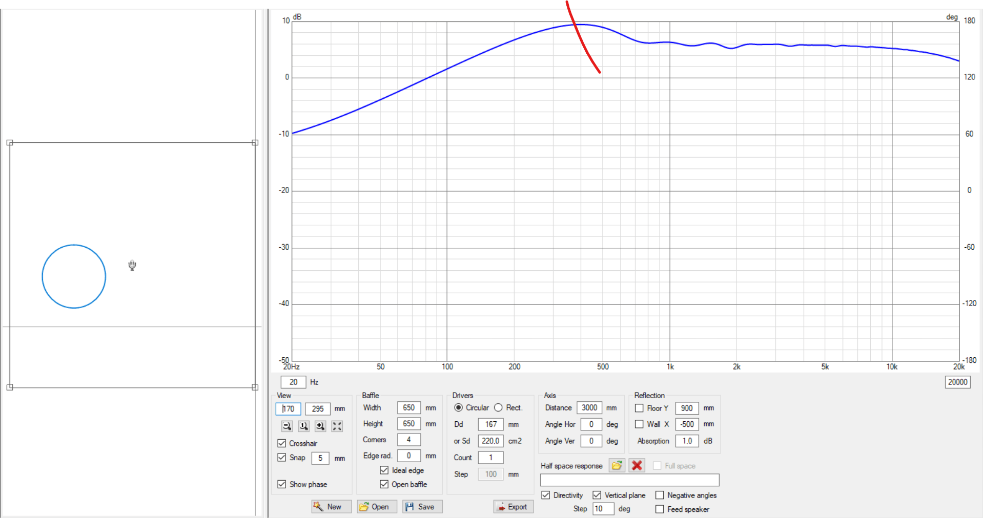

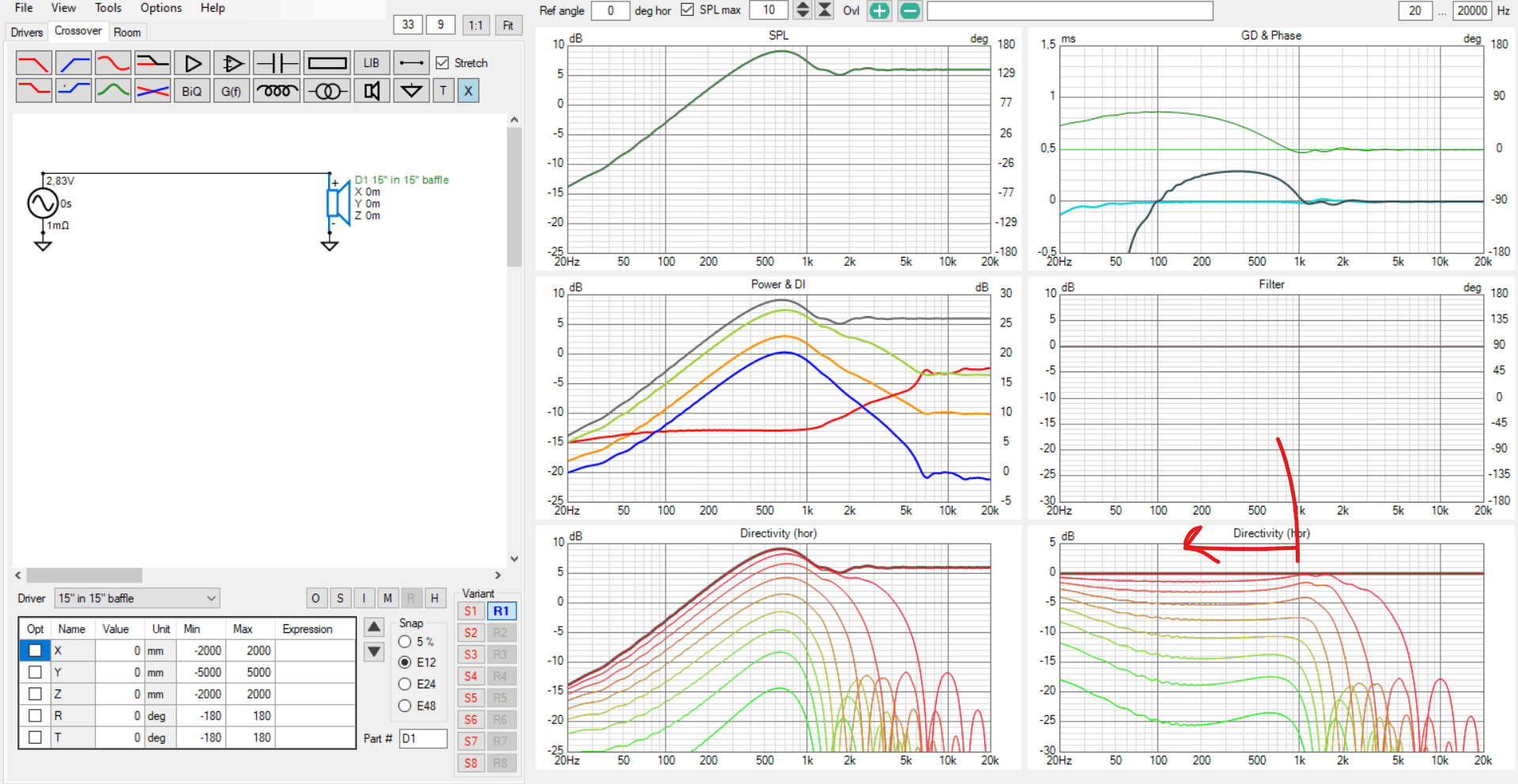

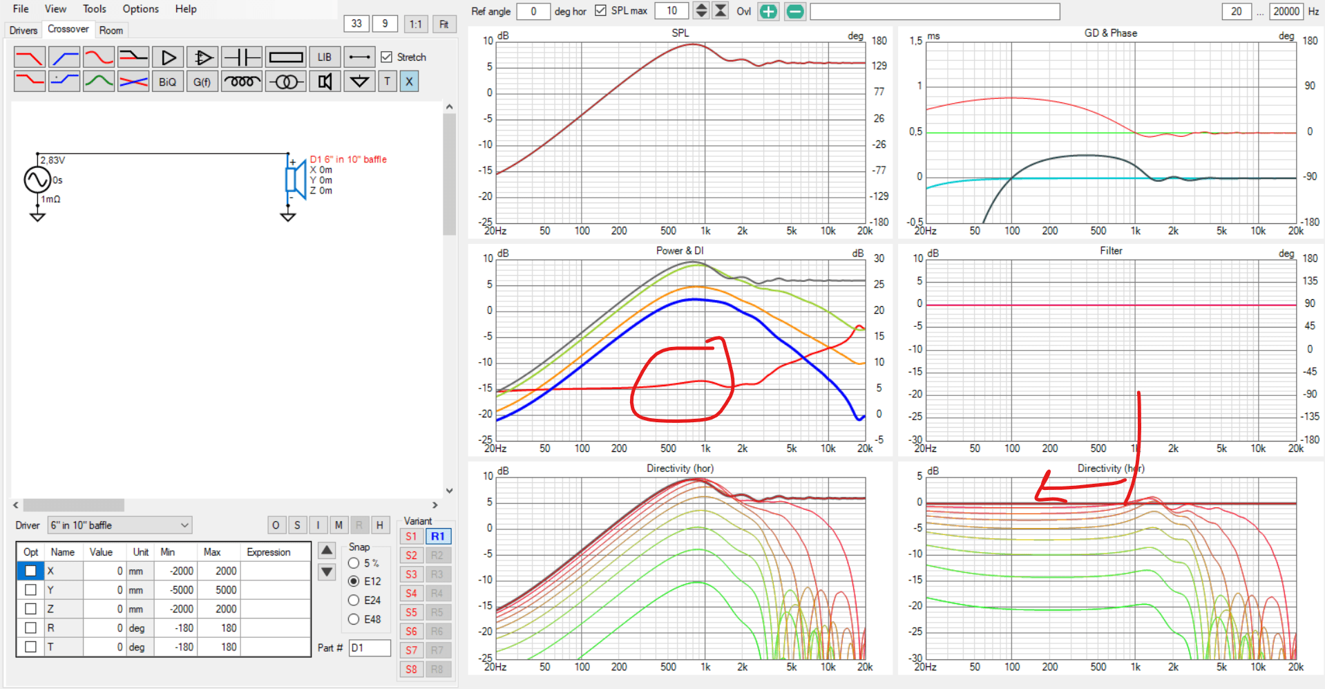

Example from previous post, say I'm thinking making multiway OB system but don't know what it looks like. I could have monopole bass and dipole from 200Hz up. For example. Here few tests I might do:

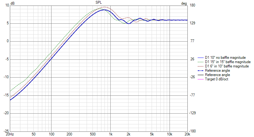

10" woofer without baffle. Cool cool, nice polar pattern down from about 1kHz, high DI. Good bandwidth can be read from the normalized polar data on bottom right image, or from DI, which is red line on left center image. It would be below the driver beaming / edge diffraction issues, basically where the polar pattern is smooth and response wiggle free (enough) to any angle.
10" driver without baffle, seems it would do it, dipole pattern from ~1kHz down.
6" driver offset on 10" inch baffle seems to do it as well, but it's useful bandwidth is about the same. Interestingly DI is lower in general, with small hump. Simple thought is there is less attenuation of lows but also less attenuation to sides, which might be good or not good thing depending on what's the plan.
15" without baffle, about the same useful bandwidth.
Axial responses overlaid
All the three have more or less same axial output at 200Hz, difference within 2db so all of them have about same usable bandwidth in a system. Big baffle/small driver has bit wider pattern than big driver small baffle. I think it comes down to matter of which one to choose for any reason, cost, aesthetics, manufacturing and that stuff. 15" and 10" driver might have more volume displacement and thus more SPL potential than a 6", if that is relevant for the plan.

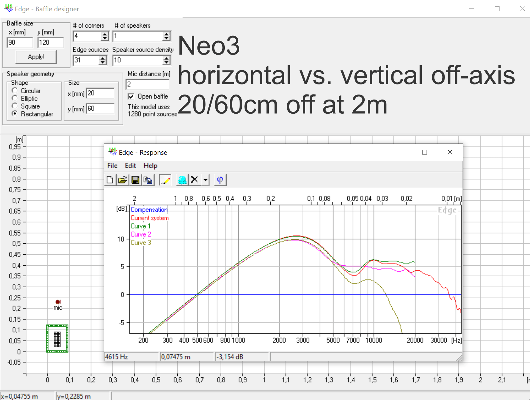

Trung is right that response is better on one side on offset driver baffle than the other, except got the sides reversed. Edge diffraction makes wave emit backwards where the original sound came from. Thus better response is on the opposite side to close edge, because from driver to edge and back is shorter distance than on the other side the delay is less and bandwidth of interference is higher up in frequency, perhaps out of band if very close to edge. Can be imagined, but is not just imagination, you could check it with simulator and take what you wanna.

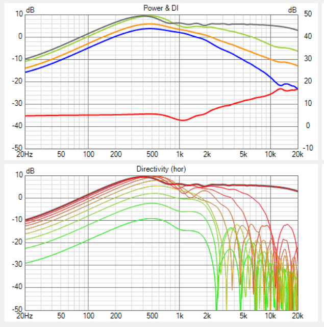

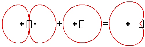

frequency response is down right decreased below dipole peak, -6dB/octave, but we can make it flat with a shelving boost filter. Of course we need to sacrifice xmax for it, but that is why we use one 10-12" driver for lower mid (to 80-100Hz) and 2x 12" or one 18" driver for bass. That is a well-known trade off to get an open sound and 3D soundstage in dipole speaker.

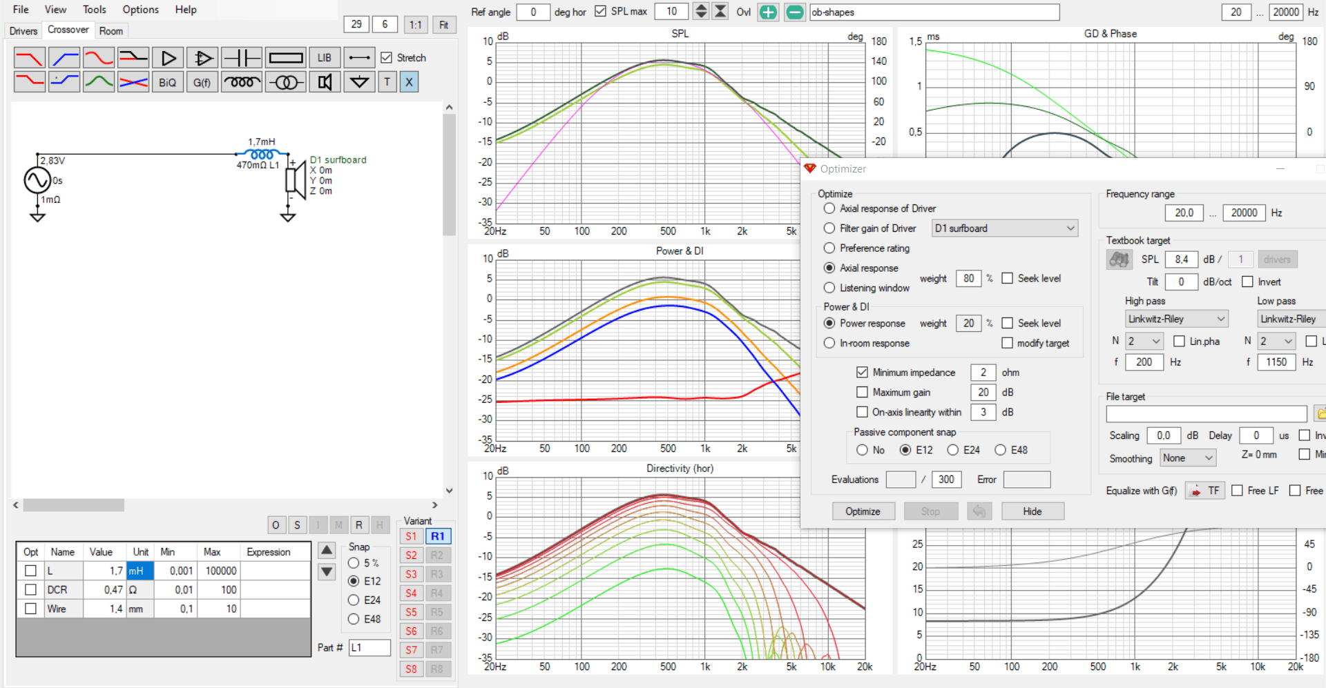

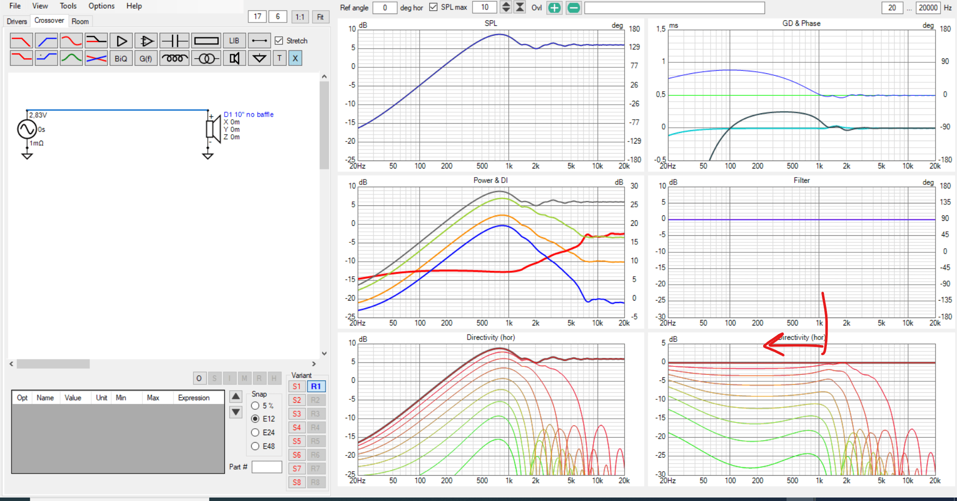

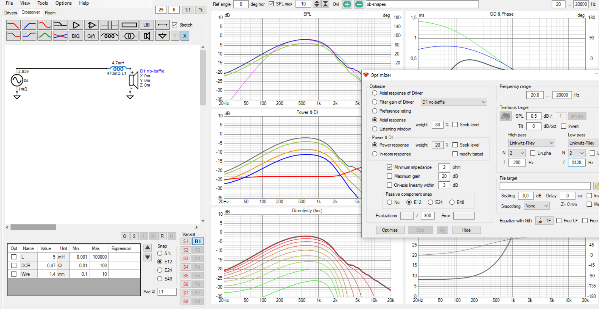

Instead of shelf boost one can add big series inductor to make one pole of low pass. This would reduce amplifier his and driver motor distortion entering acoustic domain. It necessarily attenuates the signal some and one would just boost it back, just like with shelving filter. The smaller the baffle the lower one can low pass for wider bandpass response. Of course all of it is malleable with DSP. Pperhaps a nothing-burger, thought to mention as it's another dimension how baffle size affects things, passive or hybrid xo.frequency response is down right decreased below dipole peak, -6dB/octave, but we can make it flat with a shelving boost filter
Example, optimizer is set to show LR2 target filters, adding a coil makes response roughly that way. Bigger baffle has much more sensitivity and less bandwidth just with series inductor. Smaller baffle would need more power from amplifier, perhaps offsetting the distortion reduction from the inductor.

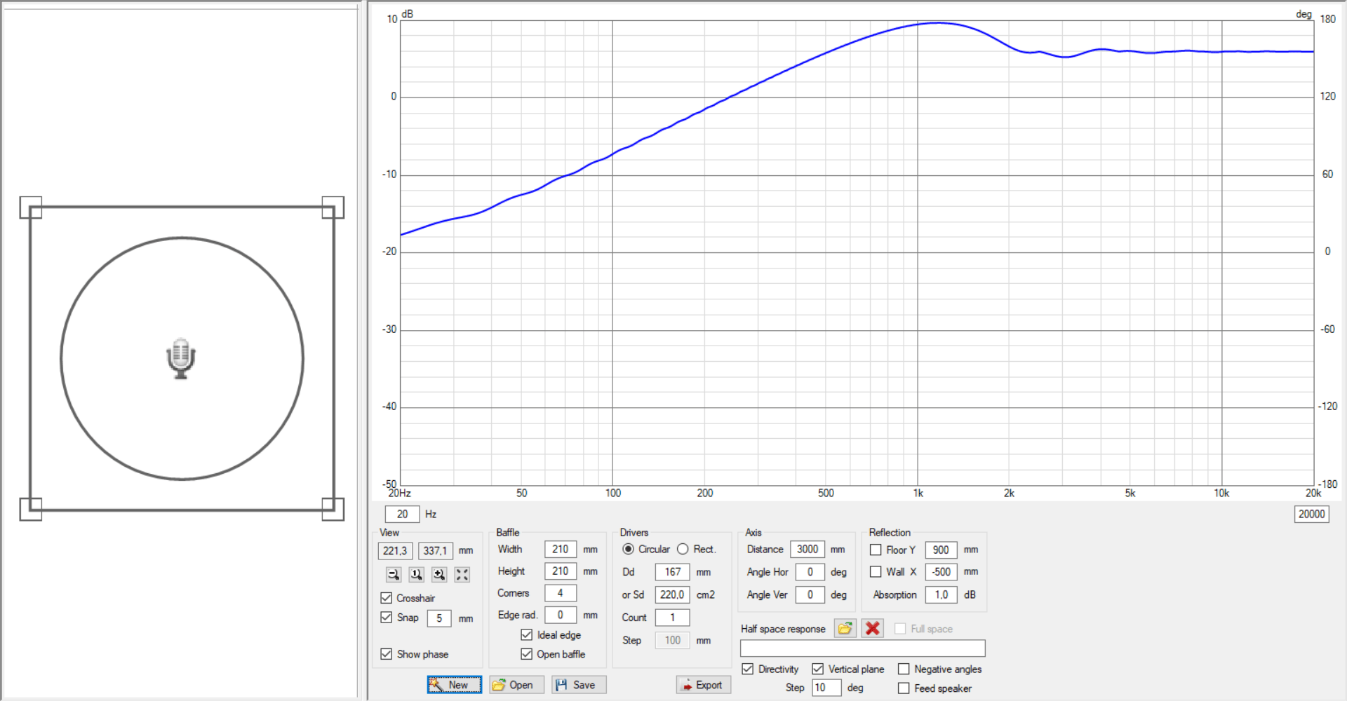

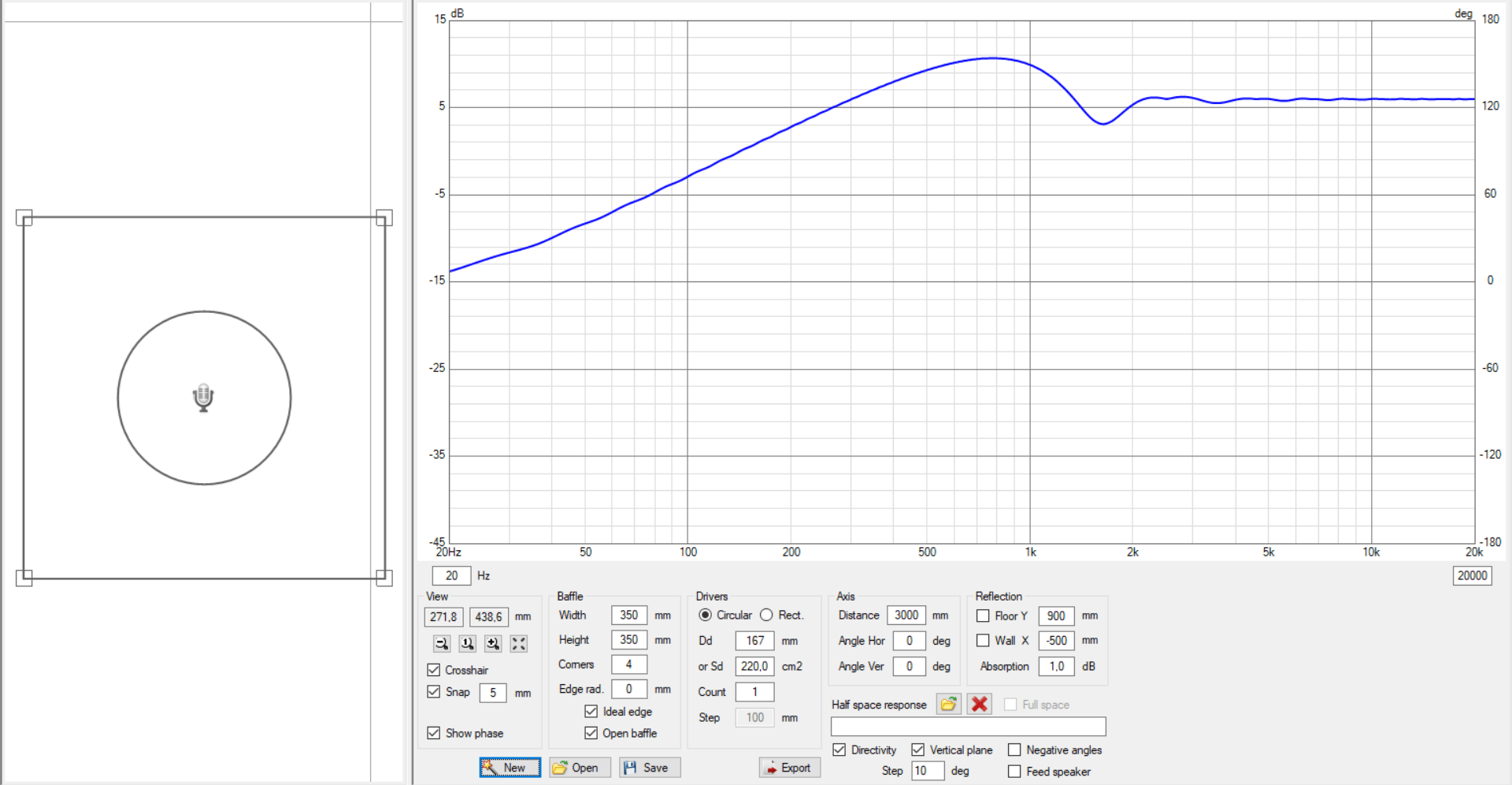

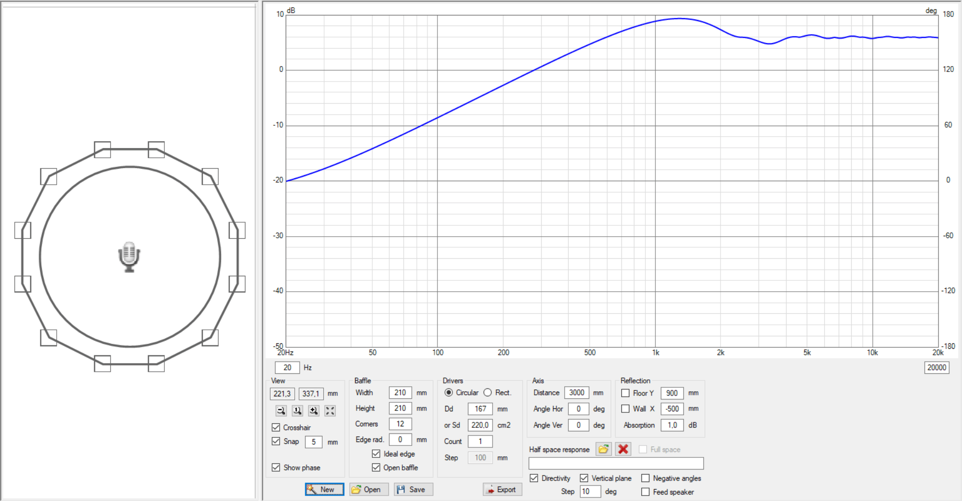

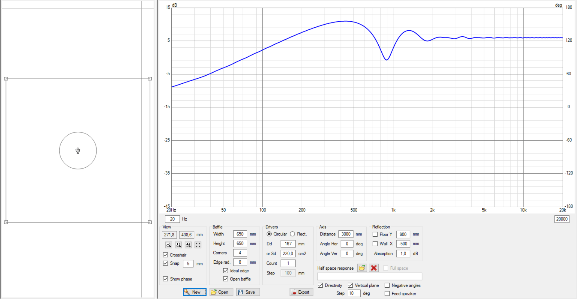

I quote you since I've got counter example here. The post is more for the OP though, for additional data and encouragement to experiment with simulator and broaden perspective.

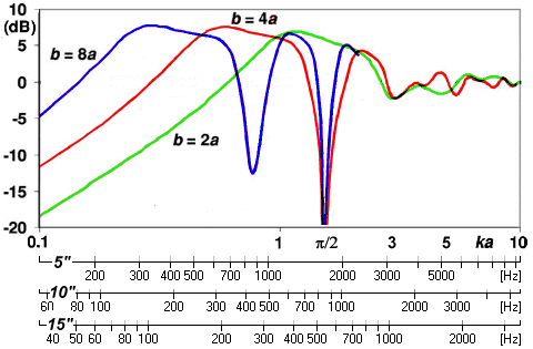

All problems with any driver start roughly about from driver size frequencies and up due to cone breakup, beaming, and on open baffle the backside of driver with magnet and all start breaking the pattern. In general, roughly at driver diameter wavelength the response of that driver changes towards shorter wavelengths getting more erratic, for multiple reasons. If a driver was put on larger than driver baffle, be it closed box or open baffle or anything with an edge, the frequency where erratic response starts moves even lower in frequency due to edge diffraction backwave that forms at the edge and interferes with direct sound.
Hense, logically the most fine and usable bandwidth of any driver is roughly from baffle size wavelengths down, be it closed box or open baffle. This kind of logic leads to system design where the full bandwidth 20Hz-20kHz is split into multiple different size drivers (and baffles) to avoid any single driver play into the erratic bandwidth.
If one cannot do system design so that the problematic bandwidth is avoided, then it pays to try and make the erratic behaviour as smooth as possible. This actually applies to all systems, since at least octave above crossover the output is still quite significant unless very steep filters (DSP stuff) is used.
This is 8" ideal driver on ideal open baffle from, pictures span from no baffle to progressively larger one.
View attachment 1313130View attachment 1313131View attachment 1313132View attachment 1313133View attachment 1313134
As you see from experiment like this, the usable bandwidth is roughly limited to the peak on upper end and perhaps few octaves below that. No matter what size the baffle is it's always about few octaves with open baffle due to 6db/octave drop in SPL, it only goes up or down in frequency with size of baffle. If you look the graphs it's kind of obvious the dipole peak gets worse the bigger the baffle, opposite from the quote. So, if one must use this particular size driver to as high frequency as possible, in a system, then the smallest (no) baffle looks better here in this set. If this driver must be used to as low frequency as possible, then the biggest baffle wins, but there is always only about few octaves of usable bandwidth beyond which the response gets weak on lows and erratic on highs.
If the edge is distributed by offsetting the driver and varying the shape the dipole peak gets wee bit smaller in amplitude, but is not fixed, only a sphere would fixit, or perhaps a donut in case of a dipole.
Here few offsets with the biggest baffle. On all of them the usable bandwidth is roughly similar, no matter the offset, due to edge diffraction.

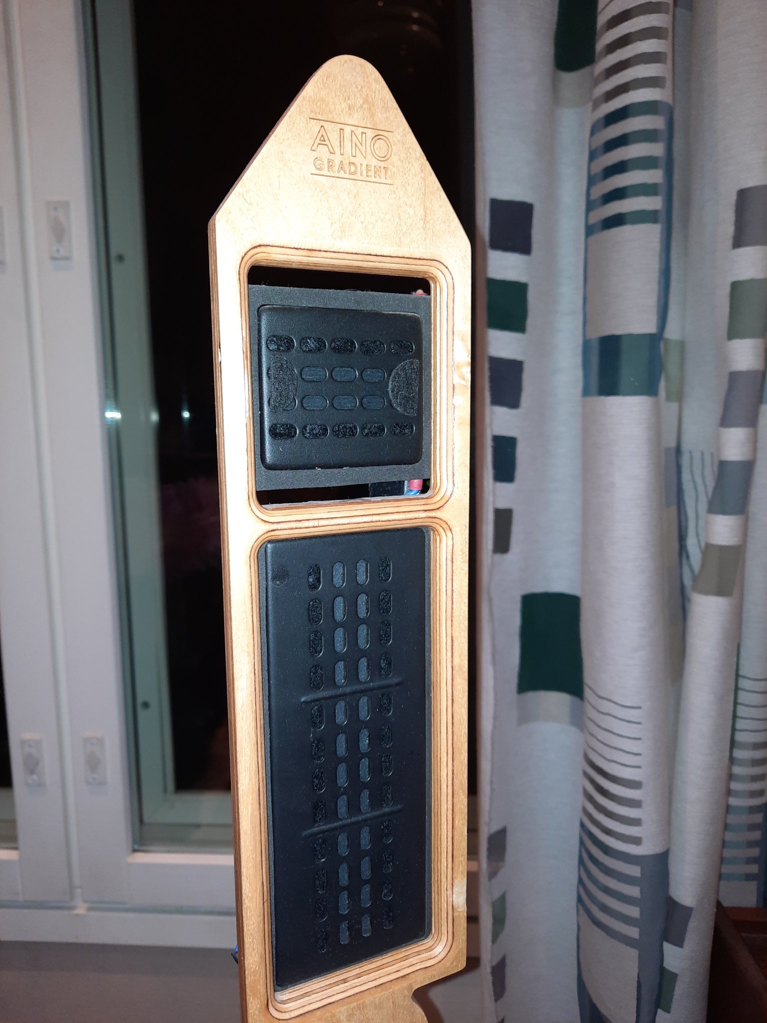

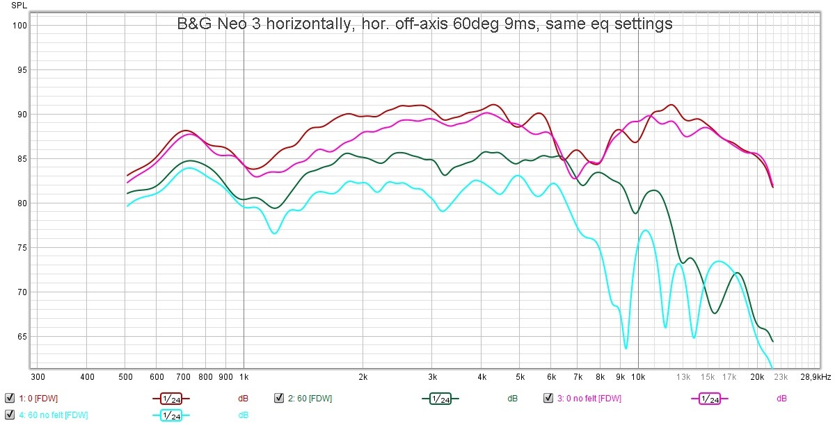

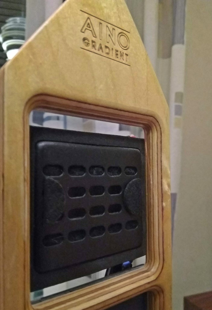

I think opposite, that my tweeter size is smaller. measured with baffle ant it is 62mm wide. According to datasheet NEO 3 is 89mm height.plus some wood. But now i am thinking here two things come into play. Baffle width and radiating area width. Did't thought about that. Need to check on edge simulator just lazy for now 🙂 but if this thinking correct then this is good way for improving horizontal directivity just by rotating tweeter by 90 degrees. i was measuring at 2m distance outside.. Frequency dependant windowing with 1/6.9 octave resolutionLooks like your speakers actually have larger baffles than mine. But your tweeter is mounted vertically (mine horizontally) Therefore radiating membrane width is shorter.
Second - My tweeter is on the bakside which makes a cavity on the frontside that has resonance. My rearside response is smoother!
Third - what was your measuring distance and settings for gating and smoothing?
The reason why I mounted horizontally is that the plywood plates were CNC'd for the previous version with horn tweeter. Later on I installed felt pads to make membrane narrower - it helped a little. Cardboard cross didn't have remarkable effect.
