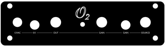

I don't know about you guys but I'd prefer something a little more traditional kinda like this:
This is basically what I had in mind as well. (I'm not too crazy about the stylized "O2" as pictured, but that's just my opinion.)

How about just O2 or a stately old English

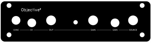

Upstateguy,
some thoughts:
The "L" and "H" are a nice idea. One might argue (I don't, actually), that they, like the "Volume" label, are expendable information. I guess that you just want to have every element labeled, needed or not, which is a valid design decision.
You have to take the screw heads into account. The "200" in the lower left will touch the screw head or even be partly covered by it; both would look ugly. Could be remedied by moving the label up.
The same is true for the "Volume" label, unless everyone uses a knob with the same diameter. Could be remedied by moving the label down, but then you'd have one label (AC) above the common baseline and one below (Volume), looking a bit untidy.
I'd hence suggest that you try moving all labels down a bit, making more room for the volume knob. Then move the AC label up a bit so that the lower line aligns with the other labels. Two birds with one stone.
The use of many letters, especially when set in a typeface that can't be milled in one go (as well as possibly necessary tool changes) increases the cost. Many potential buyers might not care, though.
Not sure if the tool that you chose for the "Headphone Amplifier" is big enough for the letter size. The inside of the letters looks a bit untidy, but I don't know whether this would show up in the final product (it will if the software gives a 100% precise preview, but that's iffy).
You have to be aware that 1 mm tall text (like your labels seem to be) is very, very tiny. Those lowercase letters are about 0.7 mm (or 0.027") high. The line width is 0.2 mm (0,0078") or 1.5 times the thickness of a human hair. If you have calipers handy, set them to these values. The space between letters is even significantly smaller. If the engraving turns out to be true to the software preview, the text will be almost microscopic, but readable (if under a loupe, for some of us). If it doesn't and the line width is very slightly greater than it should be, the text is likely to become quite a mess. One would have to see a prototype.
Is it possible that you've used a different software to add the text for all but the leftmost label? The typeface seems to be different (looks like Arial). My Front Panel Designer (downloaded from the German Schaeffler website) doesn't have this font. Adding the text with another software would, of course, render the preview pointless, as it wouldn't reflect the limitations of the engraving process.

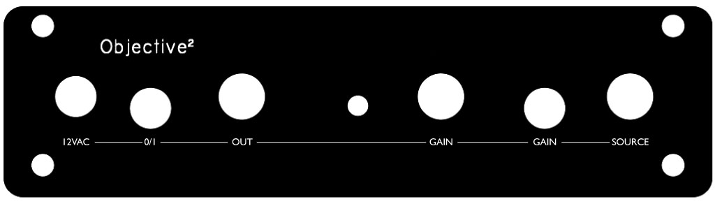

I altered the pics in photoshop just to present some ideas for a more traditional look.
The idea was to keep all the text on the same line for continuity.
USG

texttype
- the small text information is not relevant for everyday use, so i want it only visible when i really need to know the first time of use. capitals will form more of a graphical line and are at least as easy to read.
logo
- the name centered is nice, but i wonder what it looks like with the bigger volumeknob close to it.
- only O2 would be a better choice when the name will be in the middle, because of the compactness we could even make it of bigger size
- i would choose same fonttype als small text or a proper nice different font like the handwriten style of post 04:18 AM by Upstateguy
i didnt have the right font so i choose the one that looked most similar.
