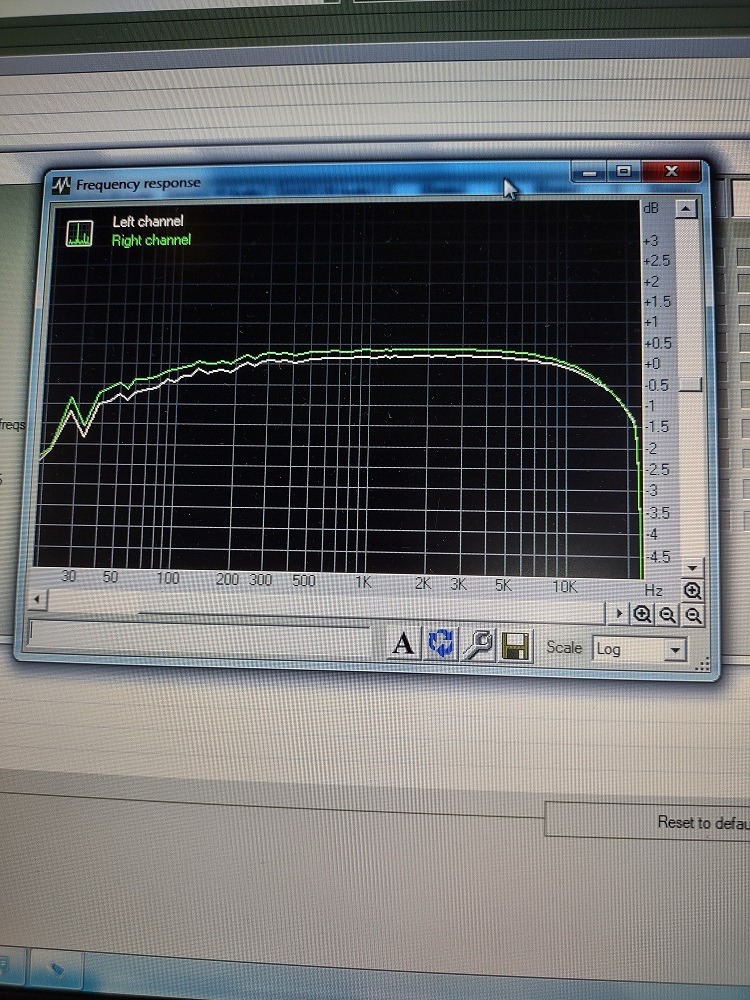

Not content with just coining the idea, Cambie built a push-pull valve Hi-Fi amp using EL84s for the output and a 6AN8 triode-pentode for the input and phase-splitter stages. He used the Altronics M1115 100 V audio line transformer as the OT. And like any good tech, he took careful measurements of his results, including some frequency response measurements. And what did he find?
With an 8 ohm dummy load at the output, he set his signal level to produce 12.6 Vpp (2.5 W RMS@ 8 ohms) at 1 kHz, arbitrarily chosen as 0 dB. Then he measured power output at various frequencies.
His amplifier measured (-1.5 dB) at 40 Hz, and (-2.7 dB) at 40 kHz - with NO overall negative feedback! 😱 Link: Construction
Cambie repeated his measurements, this time with a hefty dose of global negative feedback around the amp, and a very slightly lower voltage of 9.8 Vpp across the 8 ohm dummy load at 1 kHz. This time he obtained a response flat within +/- 0.2 dB from 40 Hz to 100 kHz!
The power supply Cambie built for this amp put out a B+ of 397 VDC un-loaded. More details here: Power Supply Considerations
So here we have solid data showing that a cheap 100V audio line transformer, used in a push-pull EL84 amp, with a B+ of about 400 volts, measured at an output power of 2.5 W RMS, had a frequency response flat from 40 Hz to 40 kHz.

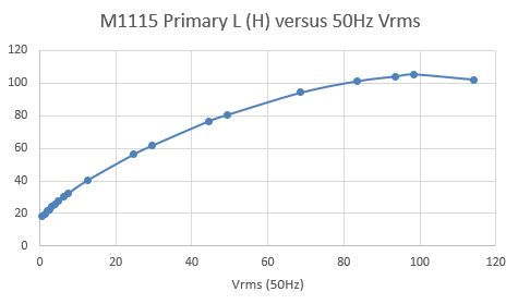

M1115 primary inductance seems to be circa 12H. I'm about to buy one of these, so will try and get some L versus signal voltage measurements and some indication of V-f that can be supported.
Well, IF primary inductance is high, it will definitely work.
Just do the Math yourself, paralleling 12H with whatever impedance your tube needs.
Another interesting experiment would be to measure primary inductance when passing realistic idle currents through, say 50mA or whatever your power tube needs.

Well the plot below about accounts for reasonable performance of the M1115 100V line transformer with 8 ohm secondary. I'll try and go beyond that asap.
Primary is full winding from COM to 1.25W tap, with DCR=206 ohm.
Push pull configuration is COM to 5W tap to 1.25W tap, with DCR = 71 + 136 ohm (so a little imbalanced).

I'm confused. Inductance climbs as you drive more current through the transformer by increasing Vrms? 😕 And tops out at over 100 Henries? 😱
Wouldn't we expect L to fall as Vrms increases and the core begins to be pushed into lower-mu regions of the BH curve?
Or am I mis-reading your graph somehow?
-Gnobuddy
The 'average' permeability of a core (with sinewave AC voltage excitation) will increase with peak flux level, and reach a maxima, before falling as the peak of the flux swing extends more in to the saturation part of the core BH curve region. Depending on lamination material, the coil impedance generally has a max level when flux is 0.4-0.7 Tesla, and designers often set a max flux of about 1.2 to 1.5 T (higher for GOSS), although for hi-fi OPTs the peak flux is often kept below 1T to constrain increasing distortion.
The 15W rating of the M1115 relates to about 350Vrms across the primary, where the turns ratio is 31.6 : 1 for its 8 ohm secondary. Ie. 15W output to 8 ohm load is 11Vrms, and that is provided when primary is 31.6 x 11 = 350Vrms. 350Vrms may not be supportable at 50Hz, as the flux peak may be well in to saturation region, and current draw may be peaking quite high (not that that can occur in a valve amp) - I will see if I can take some current waveforms as primary voltage rises, to indicate what low frequency level can be supported.
Thanks, I didn't know that. I always feel that transformers are one of the elements of electronics that I never entirely grokked. (RF transmission lines, striplines, and microstrips are another.)The 'average' permeability of a core (with sinewave AC voltage excitation) will increase with peak flux level, and reach a maxima
Interesting. Roughly 1000 Vpp, meaning 500 Vpp at each output anode. Which in turn is about what you'd get with 300 volts B+ at full drive, assuming 50 volts lost to B+ droop and the "knee voltage" of the output valves.The 15W rating of the M1115 relates to about 350Vrms across the primary

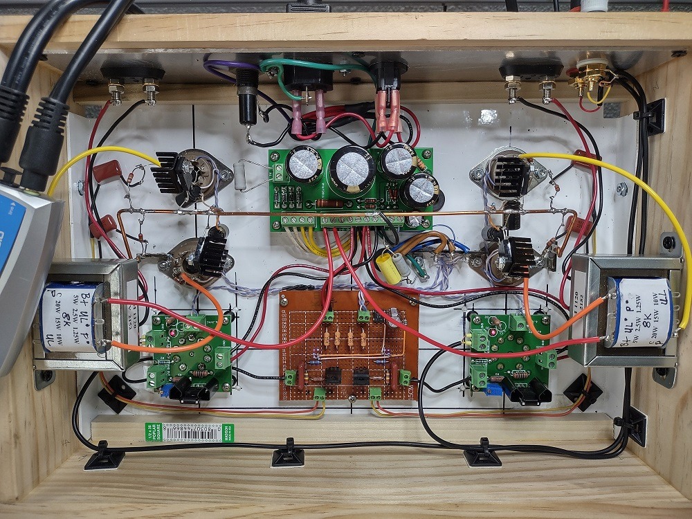

Both Grant Wills and Frank Hughes showed 17W clean max level in to 8 ohm resistive load with 270-300V B+ in a fixed bias, UL configuration, so that's a good start for the M1115 with 6CM5. I'm hoping to repeat that setup soon, and will try and get some power-bandwidth and distortion info for both non-UL and UL configuration.
