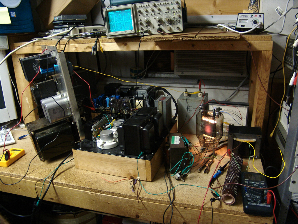

I had collected several MOT's for science experiments. Most were from ovens that I found in the trash, or that I blew up doing .....science experiments, like making a plasma ball big enough to melt the glass floor in the oven.
At the time I knew that the MOT operated in a semi resonant, edge of saturation mode, but didn't know about the shunts. The magnetron is a vacuum tube that self oscillates due to a resonant cavity inside and a BIG magnet on the outside. It produces 500 to 1000 watts of RF power at 2.45 GHz which excites the water molecules in the food. If there is no food in the oven this RF power has nowhere to go except to be reflected back into the magnetron tube. This raises its plate dissipation from 300 to 500 watts, to roughly 1500 watts, which will quickly cause it to self destruct. The early Amana Radar range and Litton commercial ovens did exactly that!
To combat the meltdown and make the oven lighter and cheaper, a rather unique power supply was designed. It uses a transformer, a capacitor and one diode to make a half wave voltage doubler. The magnetron tube itself is the second diode, and there is no second cap. This setup is not only a voltage doubler, it is a series resonant circuit at roughly 60Hz. When the oven has a full load of food the tube draws a certain amount of current, and its plate resistance is high enough for the resonant circuit "Q" to allow the tube voltage to rise into the 2500 to 3000 volt range and the oven operated at maximum power. With nothing inside, the tube becomes a low impedance dropping the circuit "Q" and the tube's plate voltage. The oven will draw less than 1/3 it's rated power, preventing tube meltdown or serious arcing from RF standing waves. The magnetic shunts in the transformer core also play a part in the transformer / power supply's self limiting action.

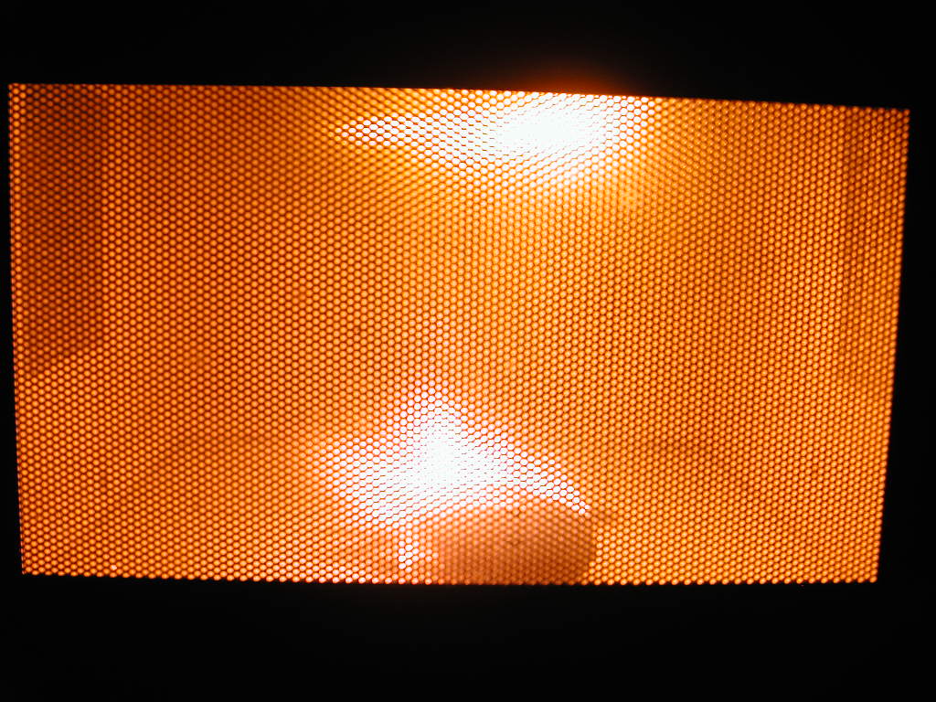

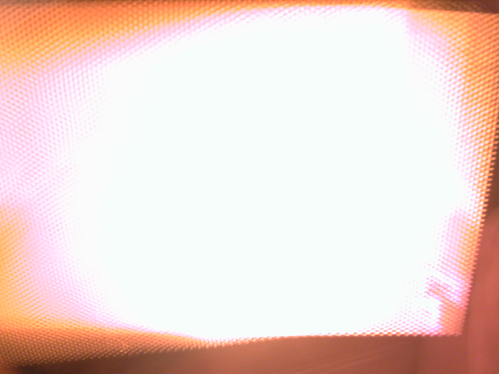

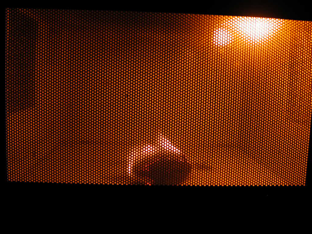

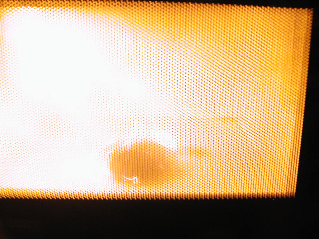

When my 41 year engineering career ended I had to move all my belongings 1200 miles. I knew this was coming several years in advance and started downsizing my stuff, by selling, giving away, or trashing it. Even with about 5 years of this over 1000 pounds of transformers went to the metal scrapper in the last few months. I couldn't even give the big stuff away for free at hamfests. I had THREE 1500 volt 1/2 amp constant voltage power supplies from Motorola base station transmitters. They went to the scrapper. One can be seen here making an 833A glow pretty. The big panel on the left standing on its end. Yeah, that SOLA transformer weighs in at about 70 pounds.
I included a few pictures of a "science experiment" that killed an oven. It was still working, but the cavity was breached.
