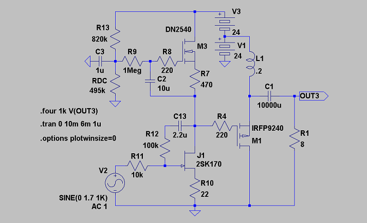

Reread Linsley-Hoods LINIAC article from -71 the other day and saw some similarities to what have been delt with here.
If we combine the Schaded 2SK170 with a "voltagecontrolling" gyrator and a SF we are there.
One could of course take the NFB from the output but does a SF really need more NFB?
Using a P-channel output device there is no need for insulation against the heatsink as drain is to ground.
RDC is used to achieve symmetrical clipping.
Unfortunately the gyrator needs additonal voltage to work. If instead a choke was used the 24V would be enough. The gyrator FET doesn´t need to be depletion, anything with high Gm will do.

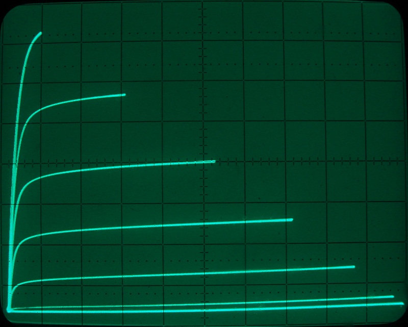

Just for fun, I traced some curves for the NTE451 JFET that show the effect of parallel feedback. It indeed works as advertized (on the curve tracer).
Link to video of curves using a potentiometer to vary the amount of feedback

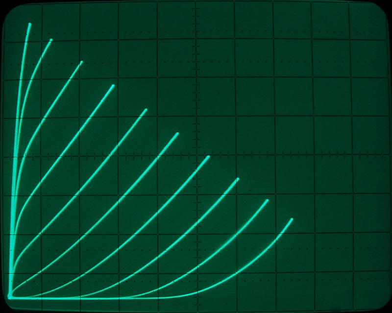

A BJT
The JFET curves look more like a real triode. The BJT looks extremely linear though.

Yes, a 2N3904.
Not sure about how it would sound. I am not really a solid state person, more into tubes, but I'd think that it would have much less distortion and won't have a tube sound.
I think the JFET will have more even harmonics like a triode and would sound more toobie.

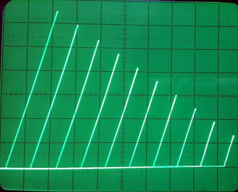

Thanks avincenty for the interesting video. Creative, instructional and showed that one gets a tweakble solid state triode performance! Was feedback from drain to gate increasing as a function of time? Do you have another video like it for bjt to understand its behavior?. Best regards.Just for fun, I traced some curves for the NTE451 JFET that show the effect of parallel feedback. It indeed works as advertized (on the curve tracer).
I did not video the BJT but the behavior is the same. The more feedback the more vertical the curves get.
