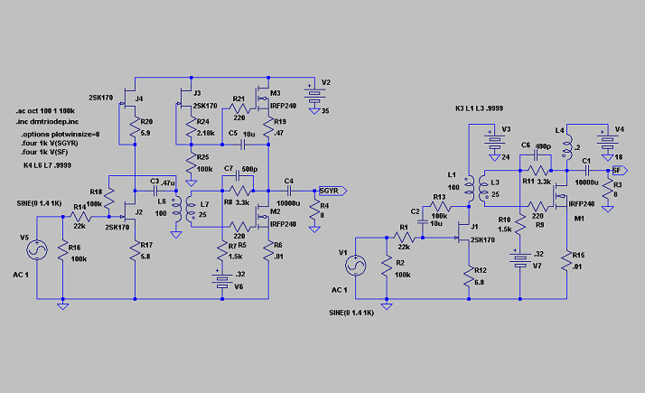

What about a "Schaded" JFET as driver to a "Schaded" MOSFET SE?
The left one with a combined gyrator and CVS(Constant Voltage Source) instead of choke. As no current goes through the transformer in the left example a LL1676 2:1 could be used.

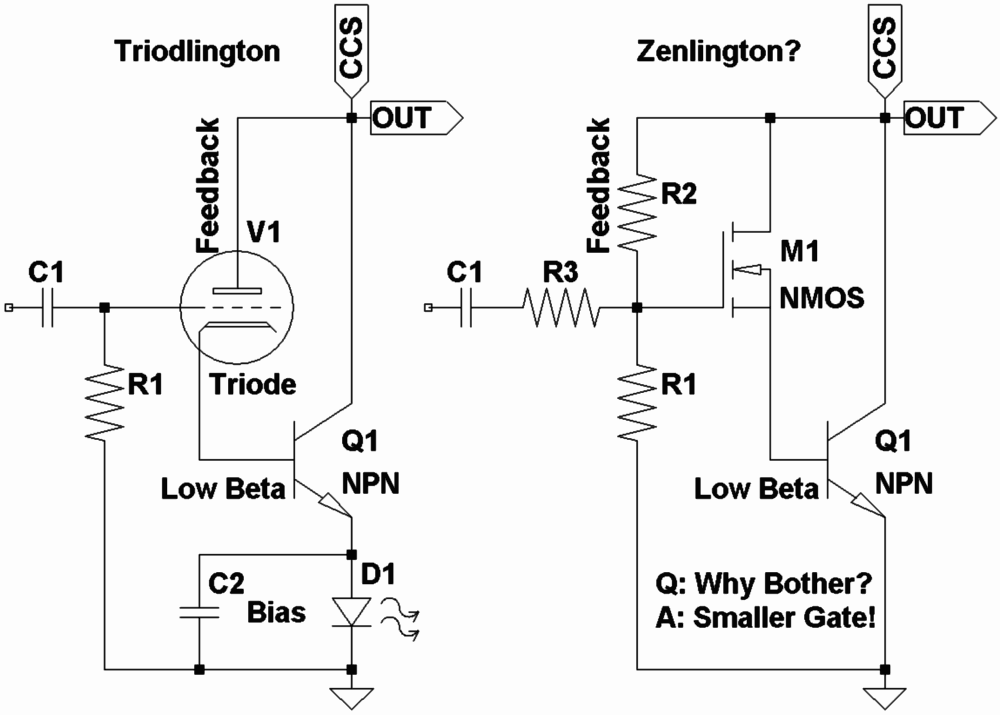

And a glass Triode's 1/(Mu-1) from Plate to Cathode can be
stand-in for Zen's resistive network, to linearize a MOSFET.
Our device then also benefits of the triode's grid for input
buffer. Same glass Mu Schading trick works equally well for
Bipolar transistors too, Oldie's Triodlington...
I've drawn somewhere around here at least once before,
Zenlington. Like Triodlington. Very tiny signal MOSFET of
enhancement mode, voltage linearized by Zen/Schade.
Then boosted in current by Beta/Darlington.

The transformer sims are pretty basic so IRL tests will show how compensation should be done. But comparision shows that this way you get better HF-response.
About direct-coupling between the stages this is a NONO as the 2SK170 will not be capable of driving a 1,5k load. Instead of a CF/SF, the transformer will be much better sounding impedance-converter.
It is soon time for a IRL test of my theories. The Hammond 193U´s are ordered and a 24V PSU is also on its way. Chassis, LL1676´s and heatsinks are already in stock.
I had initially calculated for 18V/1,5A for the output device but sims are a lot better with 24V/1,5A but for the unsymmetric clipping. It is thought to be used as a 5-8W amp.
