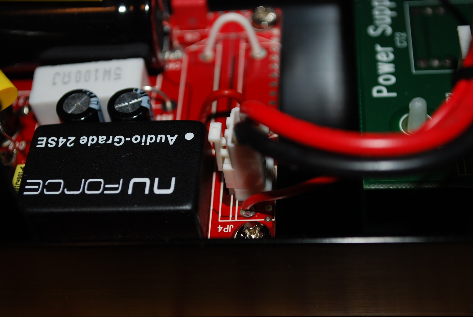

Funny Y is 52V but board states 48V you mentioned, and that would be T version 🙂 I think they are EOL, no longer in production.
The ampboard seems to need separate 5V then. (JP4 pic) A stepdown converter on aux voltage smps1200a180 ?
Yes the T version!!!! Can you elaborate on " stepdown converter on aux voltage smps1200a180", I'm illiterate in these matters!!!
Voltage is right, but doesn't need to be dual rail. Any issues just using the + side of the supply?
Some people use these with their Class D amps Mean Well MW NES-350-48 48 VDC 7.3A 350W Regulated Switching Power Supply but you have to deal with the fan noise somehow (modify with a larger fan). You'd need another small 5v supply in conjunction for that other 5v rail.
What is the + side ?.According to documentation the Z30T has 2 +48V and 1 +5V, no -Volts! I would really like to not use a fan if that is possible : ). Is there any specific 5v psu that you could recommend?
Would this ""Douk Audio 350W Switching Power Supply 48V"" work? Or should I stay away from it and those alike ?
Connexelectronic SMPS300RE seems to be an interesting alternative with adjustable volt output (+-10%) that should work.
The connex supply is 300w into +- rails though - will it be half that just into the + rail? (amp boards are single rail)
No idea of the quality, but it fits the bill specs wise. Single rail, and can use the 12v aux voltage with a 5v reg.
Post #30, single rail, RS
My apologies, it is single rail. It looks ideal (SMPS300RS)
Great , Thanks alot 🙂. I'll get the smps300rs 48V and the converter module for the 5V ampboard from the frensh shop you linked to.
